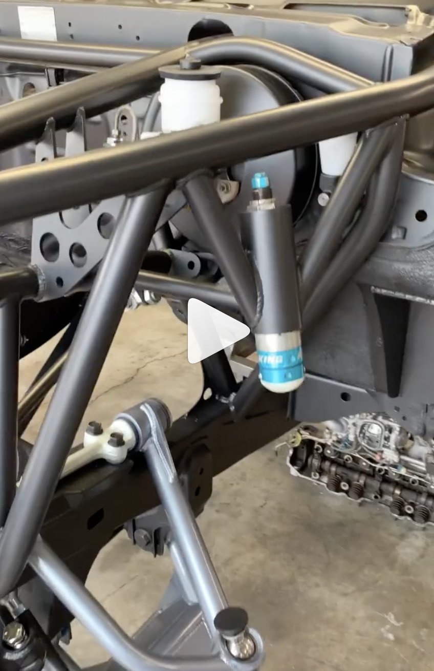

    Aren't bump stops that bump off the top of the spindle only possible with horizontal uniball spindles?
    Any normal bolt on LT kit seems impossible to mount a bump stop that hits the spindle (other than the lsk kit)

    Yeah def the way it is supposed to be done & you obviously need an engine cage to tie into but I've def seen a few people bumping right off off the top of their UCA / spindle bolt head
