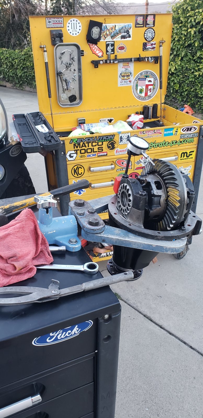

    I've been through so many ELocker 3rds I've learned to redo them myself and knock them out in the driveway, they aren't too hard to setup. Like what @906taco and others have mentioned, the non ELocker version is the better option to go with.
    After I'm done with the JDFab Front LT install ill be tackling the rear-end. I have two options that I'll be deciding on.
    Option 1 is the JDFab rear-end, but that will have to entail everything needed to make the disk brakes work properly, and loss of ABS function. My junk is still my DD, and I'll drive it to the trailhead where ever its at and back home. So that's something to consider.
    Option 2 is to get a Trail-Gear housing, and a Ebay non ELocker 3rd. Refresh it with new bearings and gears, add some kind of traction device that will likely be an ARB Air Locker to match the Front. For less than what Option 1 will be and still retain ABS function. Either way I go, I'll be confident enough I won't have to keep carrying a spare diff while on the trail. My Spare Diff box is about 90lbs with everything needed.

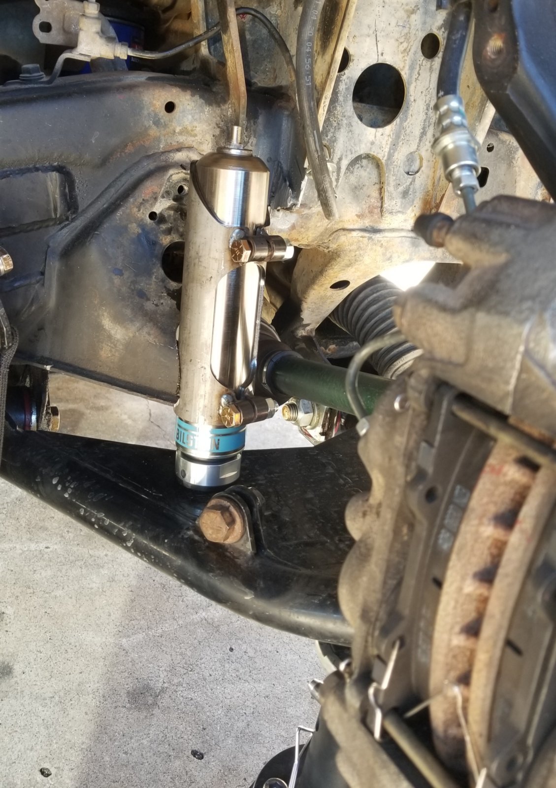

    Bilstein 2.0 bumps and cans from poly performance. Affordable combo that works really well. 2.25" holesaw, a welder /a friend with a welder and a little time is all you need. Do things yourself and save some green!! It took me about 4 hours total to cycle, mockup and finish both sides.
