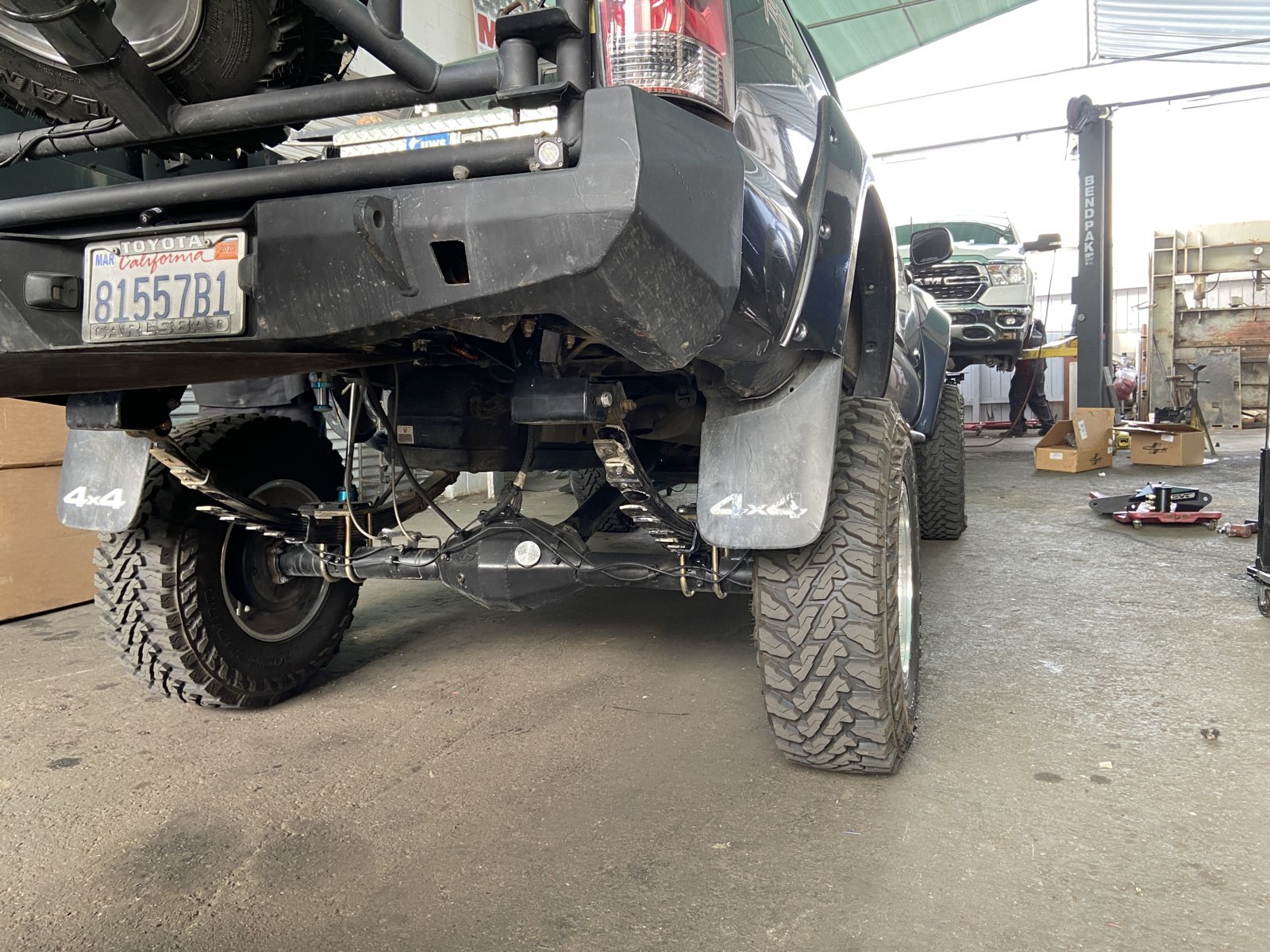

    pre-JD fab SUA
    Only issue is the vent hole is right over the diff and if I am turning hard that direction it burps diff lube out of the breather tube up in the bed.
    Need to add a block/baffle to help keep so much lube going up and out
