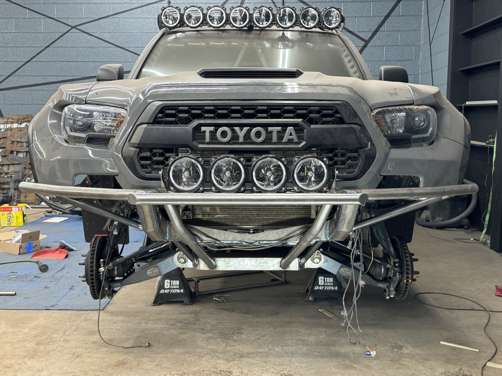

    Front end is a wrap! On to the rear corrections!
