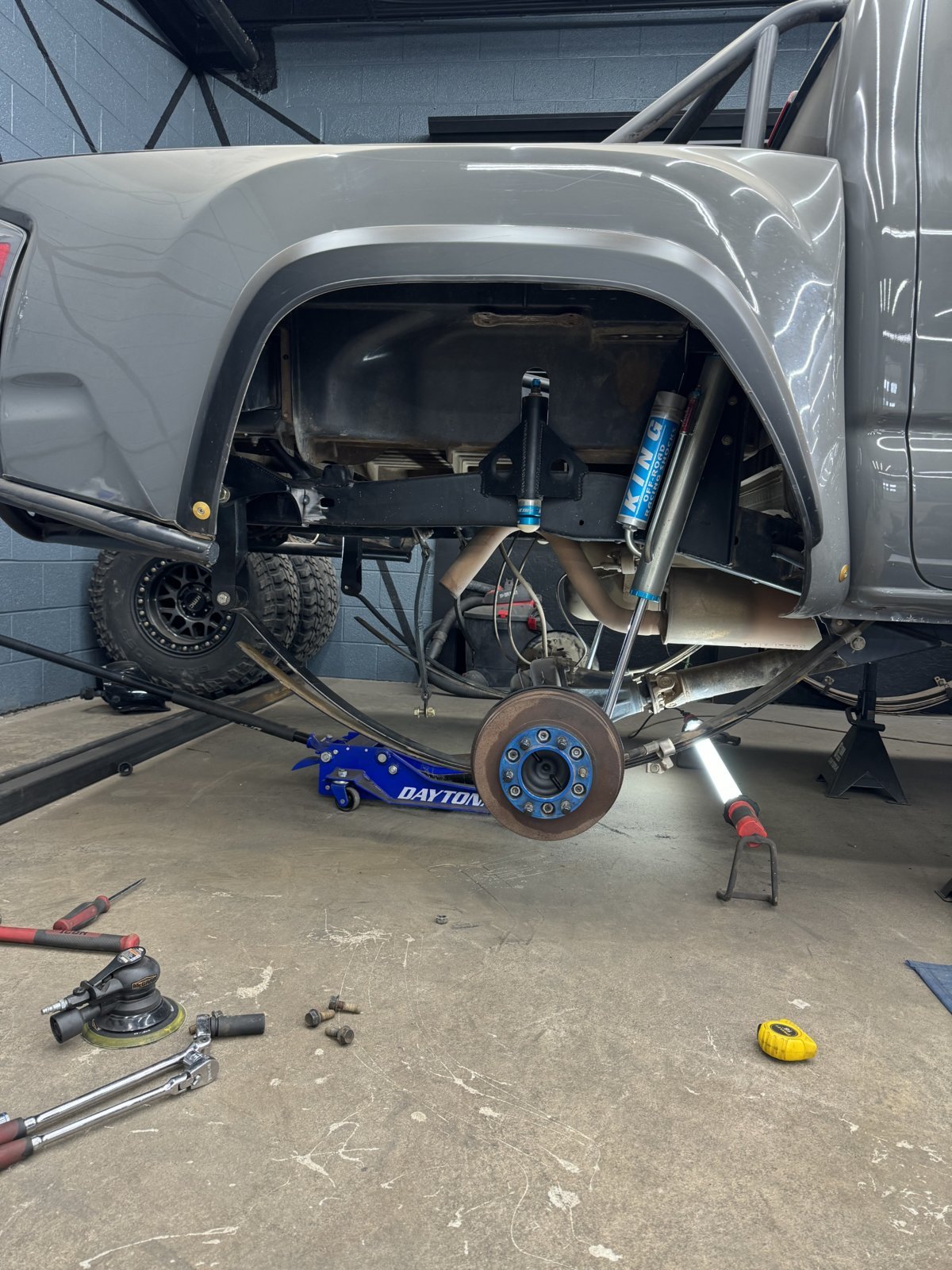

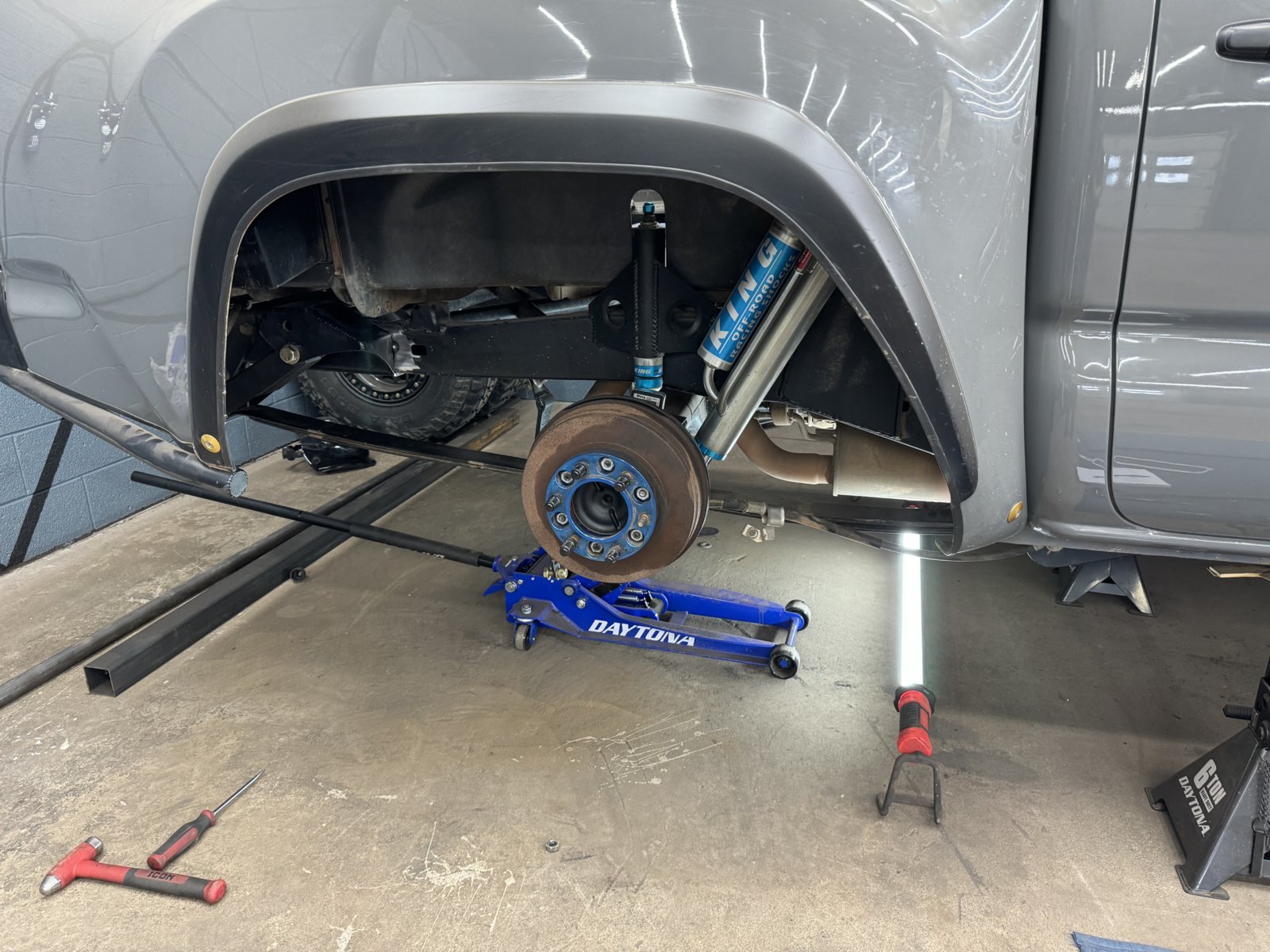

    Took @Happysmiley advice to heart and decided to start moving things around. Already picked up over an inch of travel and no more jacked up shackle angle.
    We aren’t done yet. But every aspect of this kit is improving with each thing we do.
    The entire problem was the geometry of this kit try’s to stretch the leafs beyond their intended “flat” length. When this happens they were trying to wrap up. I can no longer see the wave in the spring like I could before. But there is more to be had. And we’re going to get all of it.

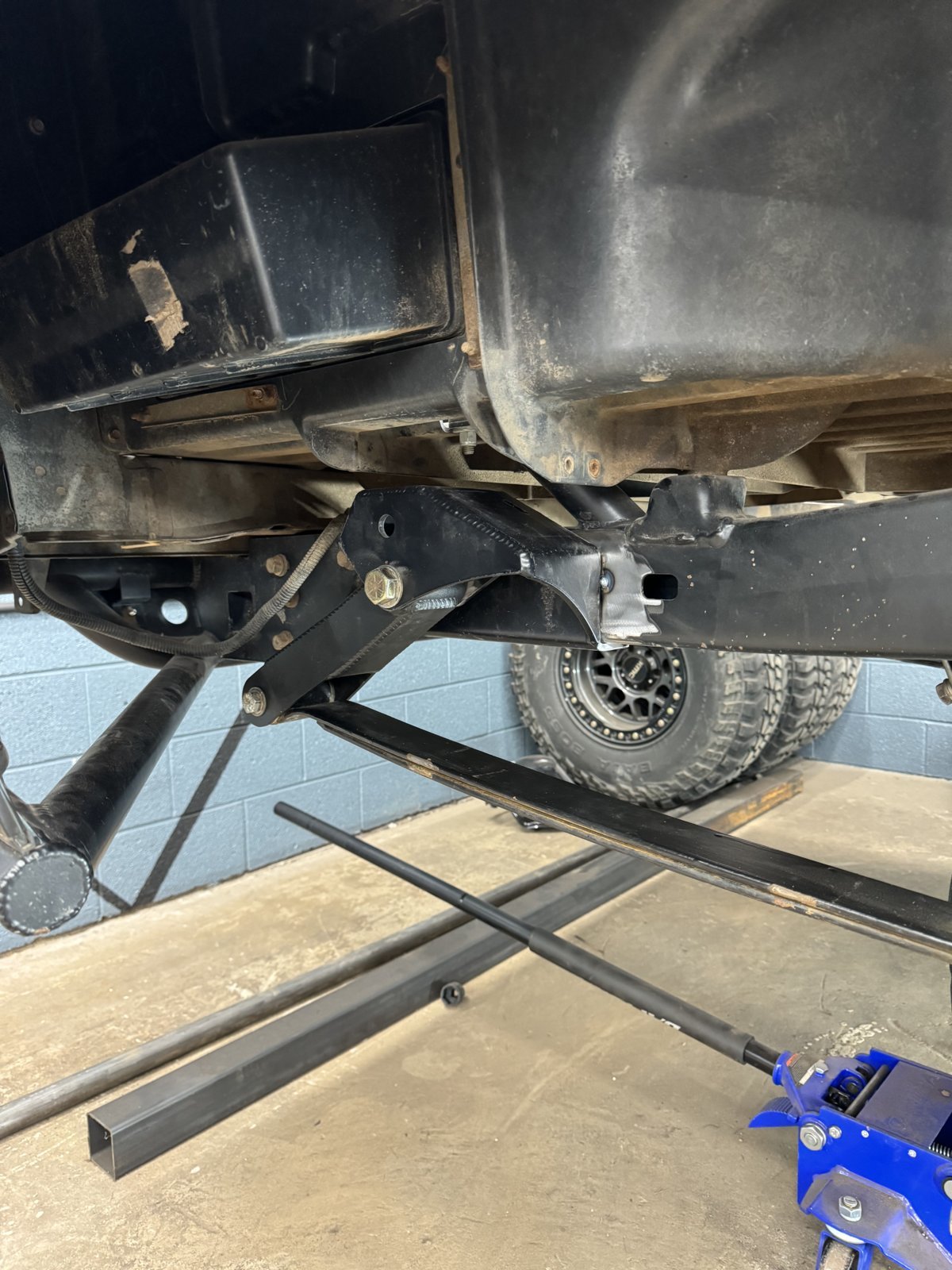

    Nope. That’s next. Moved my rear hanger forward over 2”. Once I slide the front hanger back an inch or so it’s all going to be as it should. And it will actually cycle what was advertised.

    The interesting part in all of this, when we were cycling the original geometry today just shy of my bump stop (at extension) the rear end was starting to come off of my jack stands.
    That’s when my focus shifted a little bit to find out what was up. And per Happysmiley, that 57” measurement from front pivot to upper shackle pivot is indeed, way the eff off. It’s the entire problem with the kit. The springs go into a bind before they start to snap negative. And yes, they are going negative before the bump. A string line proved this.
    The closer I get that spread to 53” the closer I get to fully collapsing my bumps with zero negative arch or bind.
    At this point, all of my thoughts are not just valid. But flat proven.
    Pivot to pivot plus shackle length. If that number is greater than the 62-63” range, you have the same exact issue. All there is to it.

    From shackle hanger to front hanger it should fall in the 53-54” range. JD geometry was 57” front pivot to top hole and 56.625 front pivot to lower hole.
