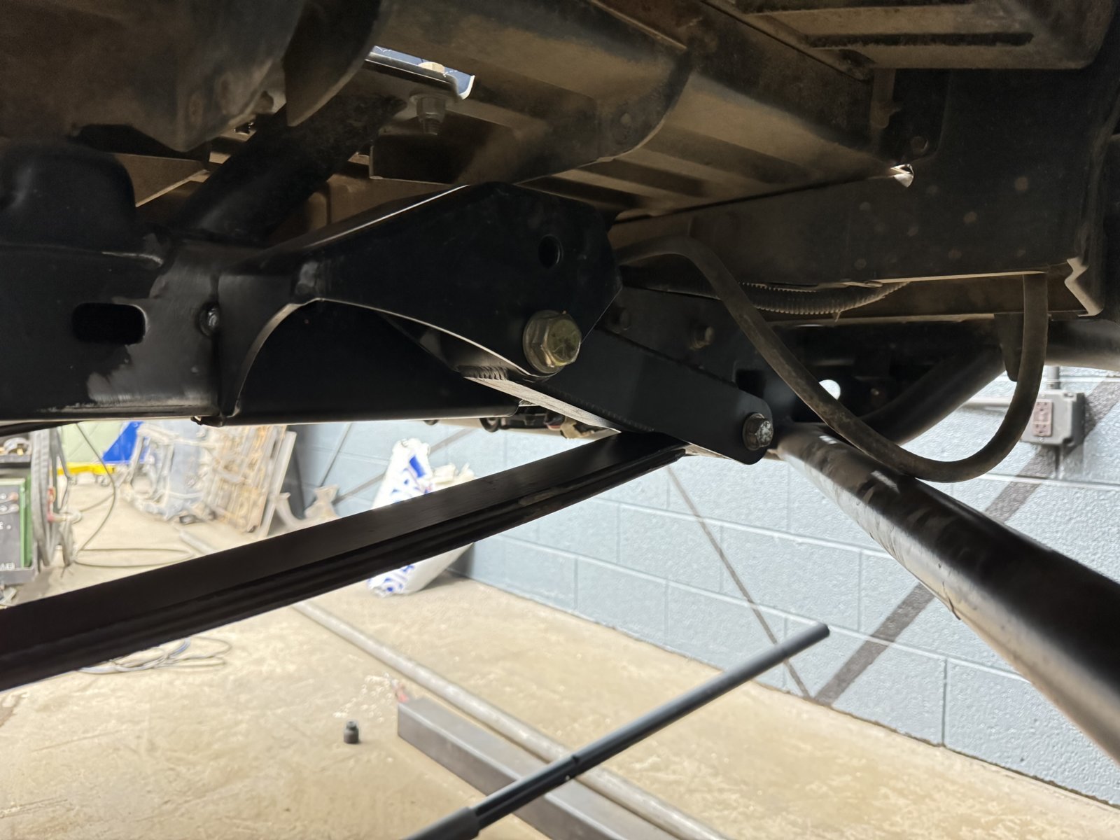

    Yes sir. Just the hangers and shackle. Custom shock mount

    Yeah, gotta hit the shackle hanger bolt up top. Center to center is the most ideal unless we math some for centers.

    I absolutely love the fact that I can literally take measurements, via frame as a frame repair facility would and still be told I’m wrong. It’s absolutely glorious.

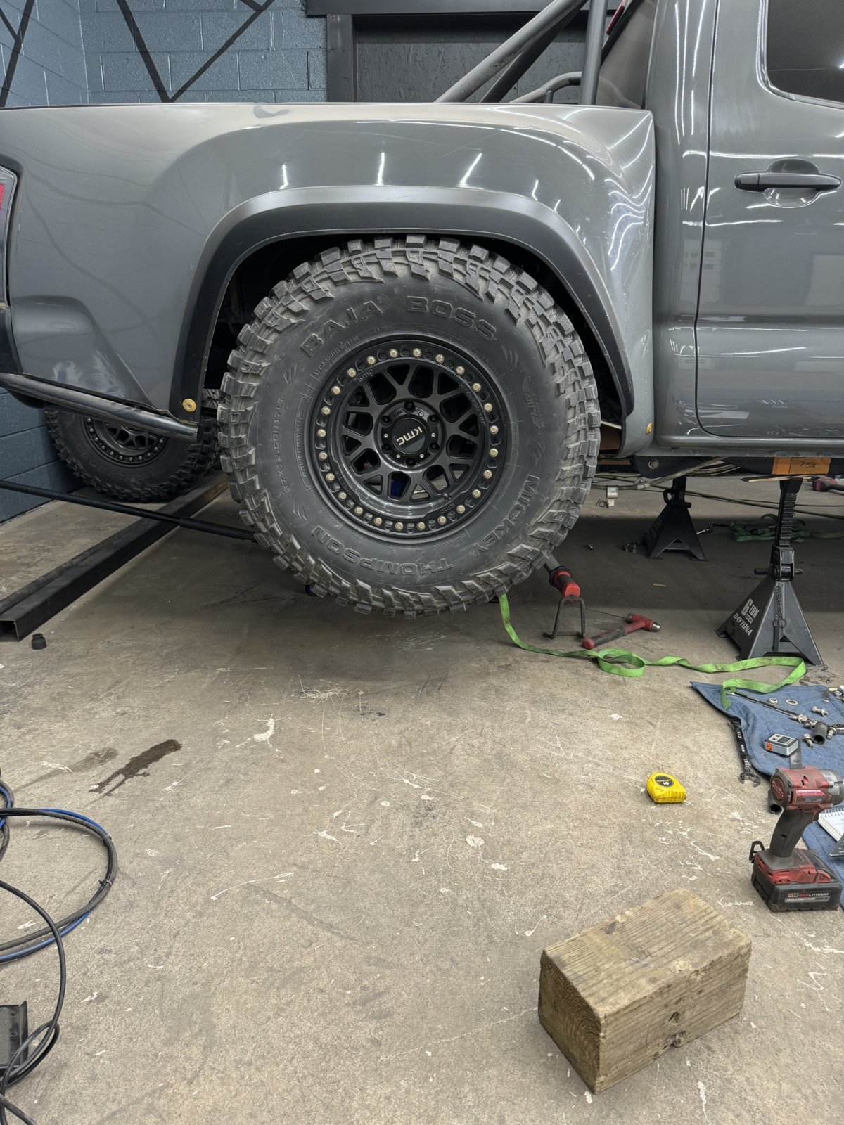

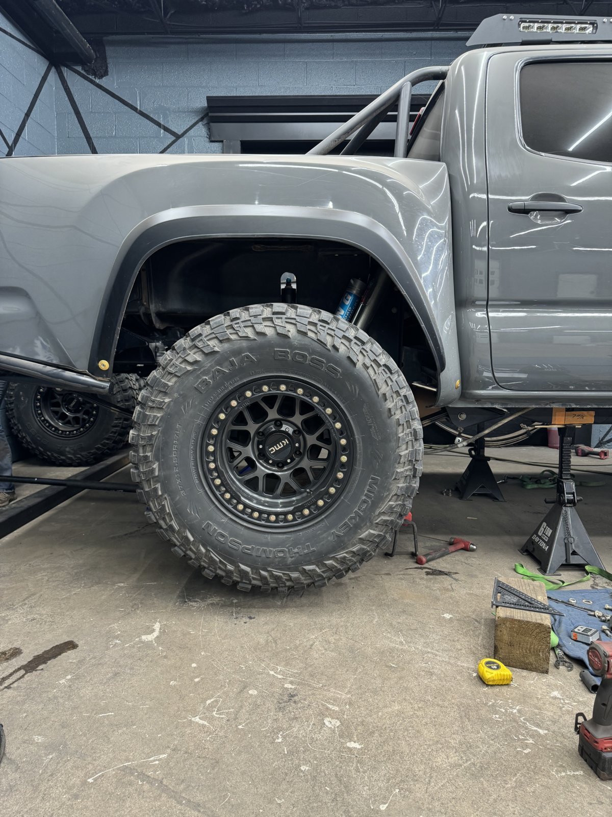

    Yeah, I can't get line of sight from the front hanger bolt to the rear hanger bolt because of the shock. That measurement is front hanger bolt to the leaf spring bolt which is 8" down and 4" back of the shackle bolt. I understand it's not nearly accurate enough for this conversation but even with a little center math we can see that I'm not >60" shackle to shackle. I'm definitely not in that ~53" sweet spot but I'm well under what you were getting and my wheelbase is 100% (technically 1/32 short ;) 131 31/32 on the laser).
    Also note that I'm not running glass at all, my bedsides are totally stock and the wheel is dead center in the well.

    you misunderstood my comment, I am referring just to the visual of a wheel being off center in an oe bedside vs aftermarket glass
    I’m not saying your axle is not forward quite the opposite i’m saying that visually there is more wrong than just your wheelbase if you are saying you’re only 1” fwd ie: your glass is off center too

    @906taco see his wheel is dead perfect center in his glass bedsides with the same kit, so it can’t just be “ the kit “. This is what I have been driving at all along, the shorter wheelbase is not happening to everyone.

    Then 100% my front hangers were manufactured wrong. Period. That is the ONLY other option. Every other aspect has been gone over 10x now.

    I'm also not running glass at all and my wheel is dead center in the stock well wells (in addition to the laser measurement but anyway). Pretty hard to argue that it's the SUA kit when it looks stock on stock bedsides.

    IDK about that “ only “ bro, all that stuff is laser cut in huge batches and jigged etc so the probability of there being a bad batch is pretty slim and that front hangar isn’t a complex piece…
    I see a couple other logical possibilities :
    1. Your entire argument assumes that there couldn’t possibly be any variance in the deaver springs when to me that seems like a probable scenario. spring arch alone could affect that dimension ie: have we assessed if the short wheel base issue is only happening with the H’s or HD’s ? or could it simply be a bad batch of springs ie: center pin loc drilled wrong ? i know you said you called deaver but ie: deaver could say the center pin is X inches from the center of the front wrap but x inches along one curve is not X inches along a different curve
    2. We know for a fact that there are 3 - 4 different versions of the gen 2 & 3 frame itself so ie: is it possible that with the hangars for the kit locating in oe holes that there is actually a variance in those holes ? in each variant of the frames there are overlap, rivet, C vs U section variants and there are definitely variations in the holes in the frames. That issue popped up around 09’ when “ no drill “ bolt on sliders wouldn’t just bolt on anymore. Everyone was bashing CBI etc saying their product sucked when in fact the frame had changed mid gen and the oe hole pattern had chamged

    pic of where your front hangar moved to ?
