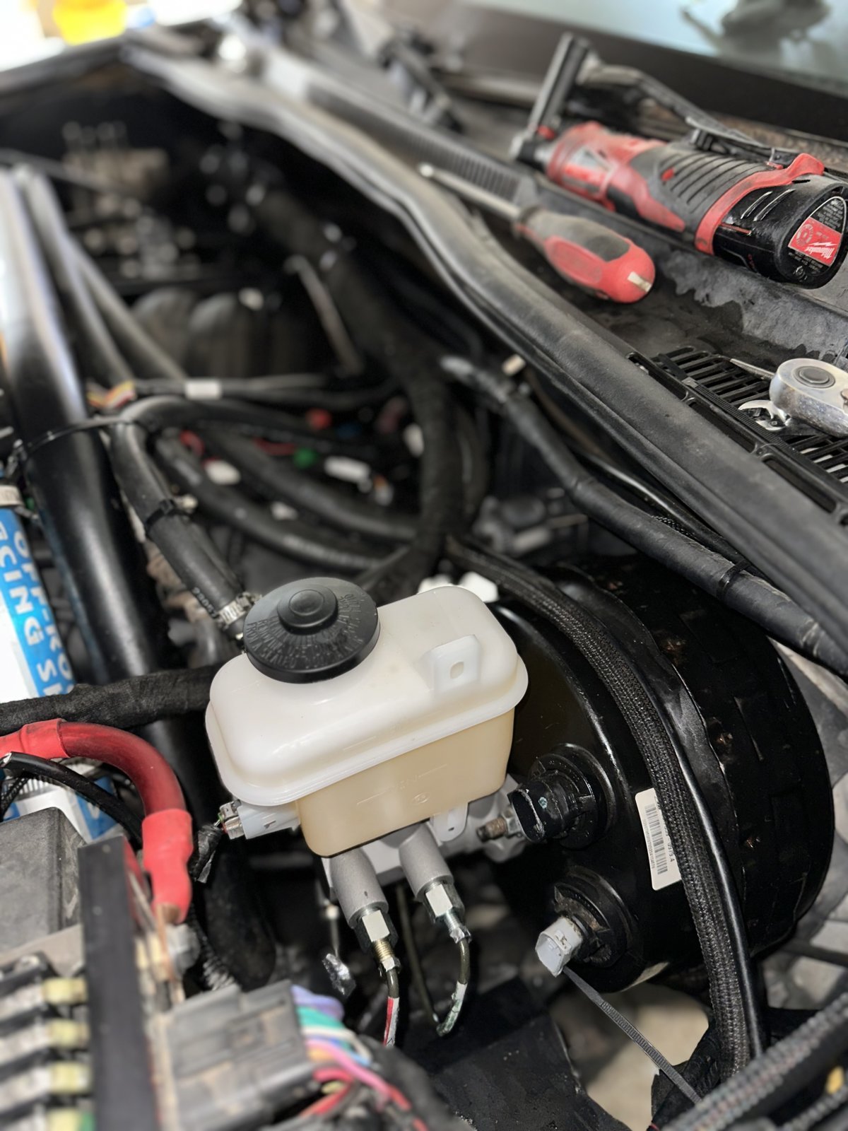

    Just bought one from AutoZone. Gonna see if my problem goes away

    Did you bench bleed the master? If not that’s likely the issue.

    No but I didn’t last time and never had an issue. I’ll bench bleed this one.

    Bench bleeding is huge. If a master airlocks you can pump all day long and never get more than a tinkle from the bleeders.
    We would pull masters off of vehicles that blew a brake line and lost all fluid just to eliminate the headache of an air locked system.

    So the SOS performance MC is not a sequoia MC. Way different.
    tundra booster and MC are in, super super firm pedal now. Also used Wilwood exp600
    Fluid.
