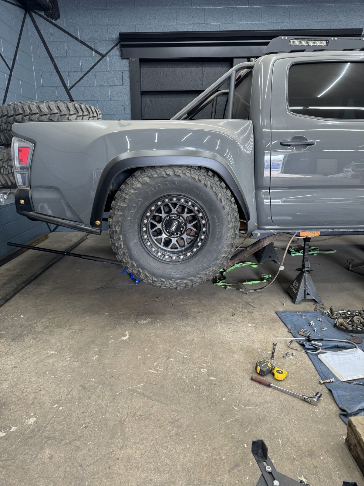

    I really appreciate you coming in with knowledge when you didn’t have to get involved. Your advice was as spot on as anybody could ask for. All was accomplished in about 8 hours yesterday. Just need to move my shocks, build new perches and send it. Currently cycling around 18.5” with shackles about 1/2” forward of vertical. Looks like strapping somewhere in the ball park of 17-18”. Starting point was 15 1/8 and it was tapped out. Pretty big deal. Thanks again.

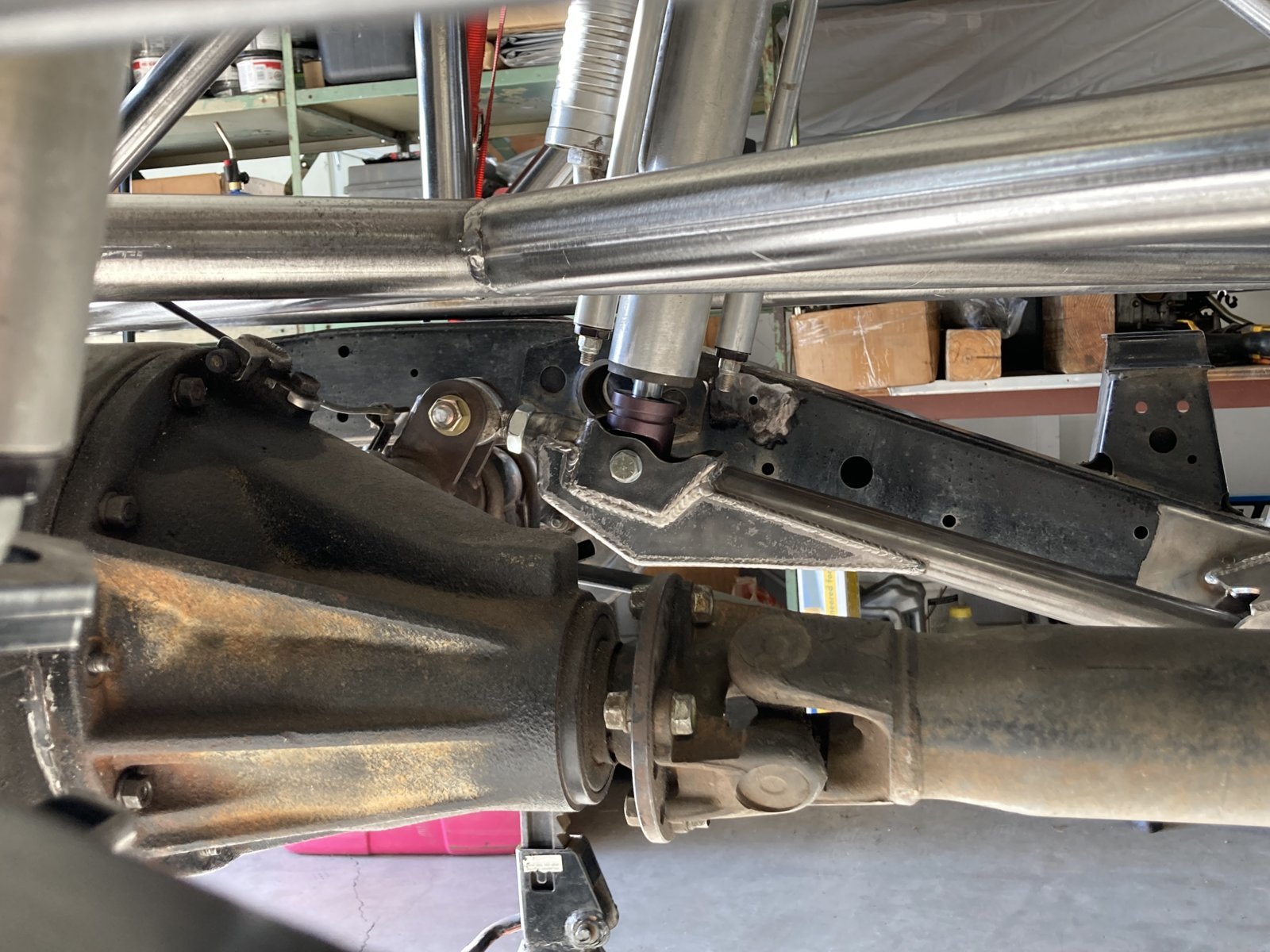

    Kinda interesting how DMZ wants me to shorten my driveshaft... You would think I would have to lengthen it or get a 2 piece for the added travel...

    You get a bunch of plunge at full droop as the axle comes forward.

    Yup gonna need a slip yoke with at least 3 inches of plunge. If memory serves me correct I had about 2.65 inches of plunge from full stuff to full droop.

    Absolutely stuffed. Will be strapping at 18. A solid 3” gain. Now to see where ride height is.

    If I didn’t have 37’s I would go to a 16” shock notch the frame and see 20”. But my tires limit me a ton on my glass. JD shock towers will work just fine so that’s a big bonus to me.

    It’ll be strapped when the shackles are at 90 degrees and there is zero negative arch all the way to bump. So it’s actually all pretty much good travel. A 2” notch and boom, 20 with some negative arch.

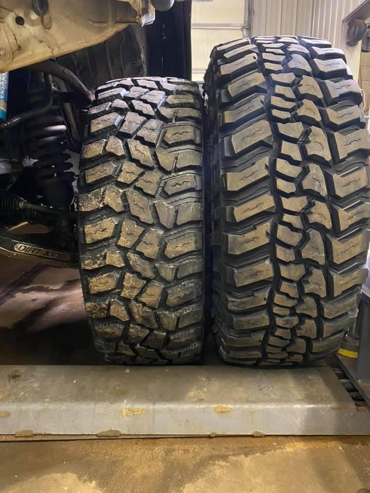

    Sweet nice. I'm on 35’s too. But FWIW, tire size is dumb. This is my 315/70/17 BFG vs a 37 nitto on my wife’s raptor:

    One of my 37’s next to a fairly new 315 STT pro…..

    They do. But these mickeys run pretty true. And my 315’s weren’t far off from 35 new. So perspective… Big Big difference
    Kinda like some suspension companies. 17 actually means 15 and so on.
