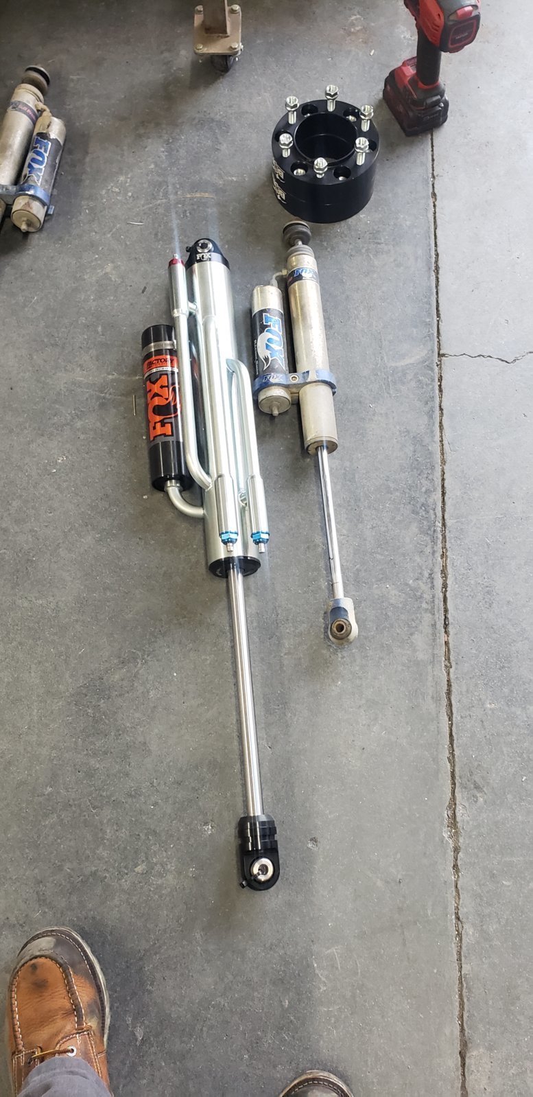

    These are my old 2.0's with about 350k miles on em with a few seals blown over the years from excessive heat. See the top of the body how its blued and discolored compared to the bottom of the body? That's where the piston was at at normal ride height , these shocks would make your fingers blister if you touched them. Id stay away from 2.0s if you can

    For only slow speed stuff, meh.
    Since you’re going LT and gonna be fast in NV, 2.5 for sure.
    My 3.0 in the rear even gets hot at times with chatter.
    My two 2.5’s in the front will get warm but not hot so far.

    aw those are cute widdle shocks
