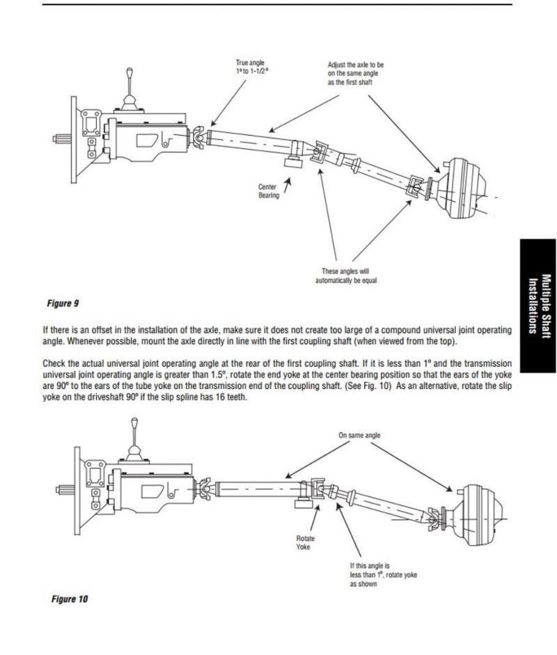

  6. Apr 24, 2024 at 12:42 PM
    RonRon23
    RonRon23 Well-Known Member
    Aug 25, 2013
    #111135
    1,303
    Ronnie
    Buena Park
    2013 MGM DCLB 4x4
    Front suspension: Work in progress JD Fab +4 LT, LCA pivot kit, steering slide rack, 934CVs Rear suspension: Archive Garage shock relocation and SUA Conversion,King 14x2.5 shocks, King 2x2 hydro bumps, FN wheels 5 stars, sliders
    Check according to figure 9. That’s what has worked for me. Had nasty vibrations and used this to make most of it go away. Never got around to correcting my pinion angle before chopping my truck in half. Pinion angle down 2 degrees has been common practice to anticipate it rotating up under load.
    YotaFAB, Supra4x4 and Bandido like this.

    Yep, taking it back to the shop tomorrow and they’re gonna drop the shaft. I’m going to try and get under the truck and check some angles this afternoon.
    Stock engine and trans mounts. It had a growl I could hear and feel in the roof and cab before but not nearly as extreme as this. I’m suspecting the driveshaft wasn’t indexed last time the u-joints were changed, that’s when I first noticed it. That was 3 yrs ago, and suffice it to say I no longer use that shop anymore. They were like “no it’s fine.”
    Thanks for that, I’ll compare that with my setup
