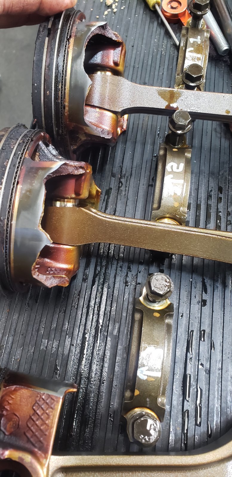

    @Pittsy
    Gotta love these Raptor Pistons..

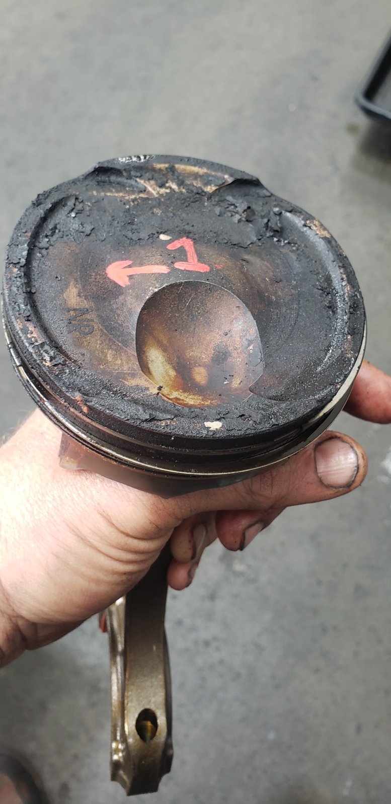

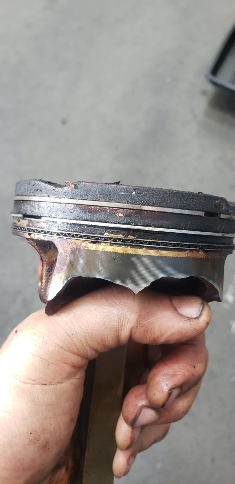

    DI only motors are retarded, you can’t change my mind.

    I don’t think this was because of DI

    Was referring to all the carbon build up on everything. And the varnishing from the brilliant PCV system these trucks have.
    it is curious what happened to those piston skirts though.

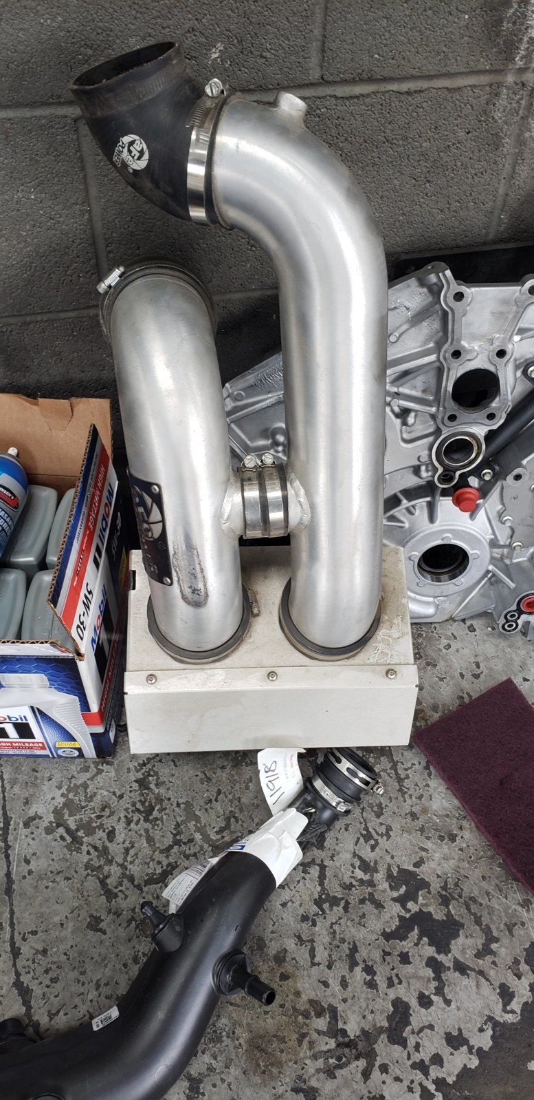

    I got this CAC tube thing from a buyback for a Raptor that nobody wants..

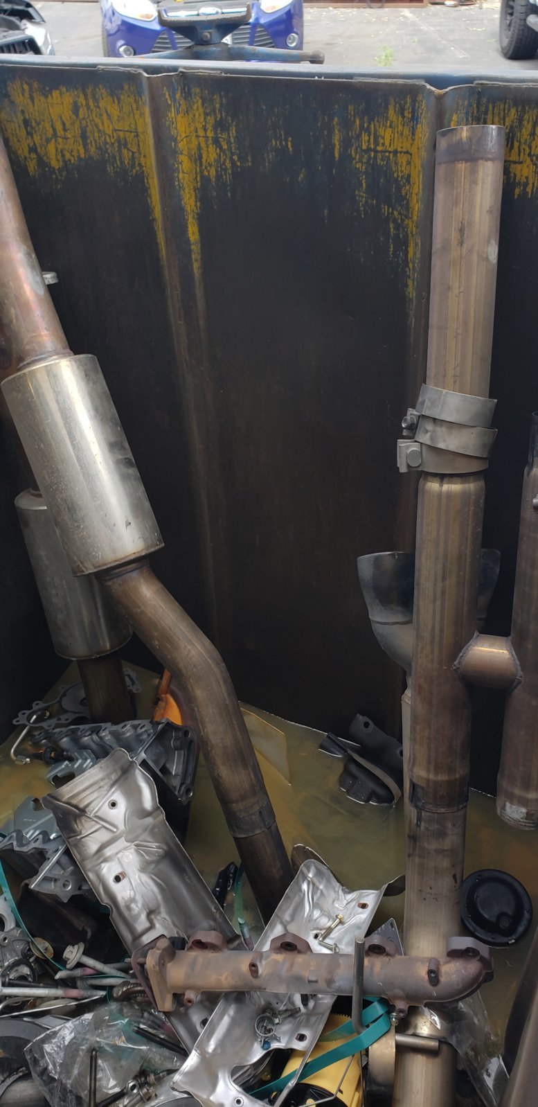

    Theres also this exhaust for a current f150 that nobody wanted so I through in the scrap pile

    DI carbon issues stop once you’re past the intake valve. This disaster is from something else.

    Not quite..this is from a non raptor F150 belonging to a local public works truck that does nothing but idle all day and night. Pre- Port injection motor. All the rings stuck and filled with carbon causing a misfire condition..this is a non port injected motor. Port Injection helps mitigate the Carbon condition
