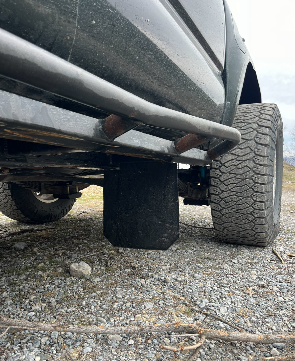

    IMG_5080.jpg I mounted them to the sliders quick and easy. I can get more photos once I get home if you need them.

    I wish I had sliders... Thanks!
    Do those help a lot from mud and shit hitting the stanchions of the shock or is it mainly for looks?

    The main reason I got them was to prevent me from sandblasting my shock shaft and axle housing more than I already had. From the limited seat time with them on they seem to do a fairly good job. It might not be the best way to install them but it was the easiest.

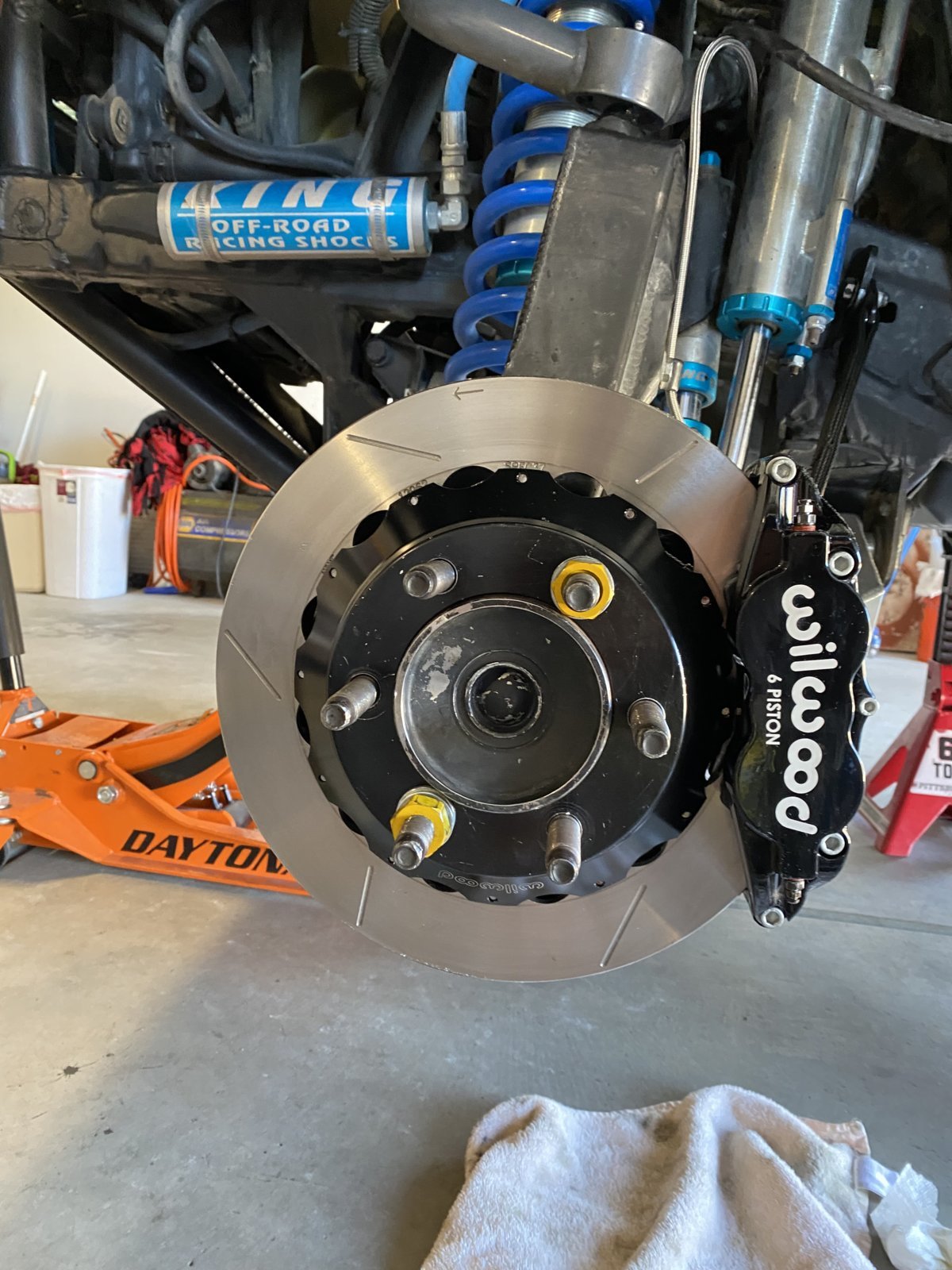

    Driveshaft had a nasty trifecta of issues that were all being masked by the OEM carrier bearing. Shafts were out of phase with each other, balance was way off, and center U-joint was toast. o_O Everything re-balanced and put back together with the Mitchmade bearing and the driveline feels smoother than with the OEM bearing. At least the truck will let me know if the shaft ever has another problem. :laughing:

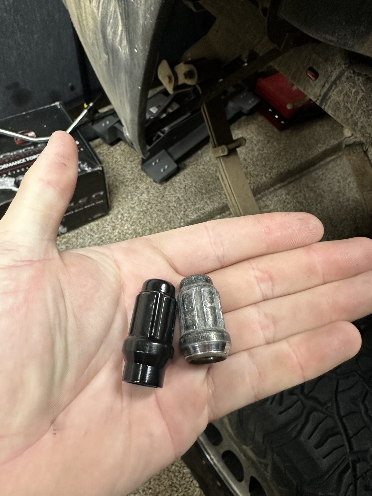

    Super cheap easy peace of mind for the scary short OEM studs. These are a must

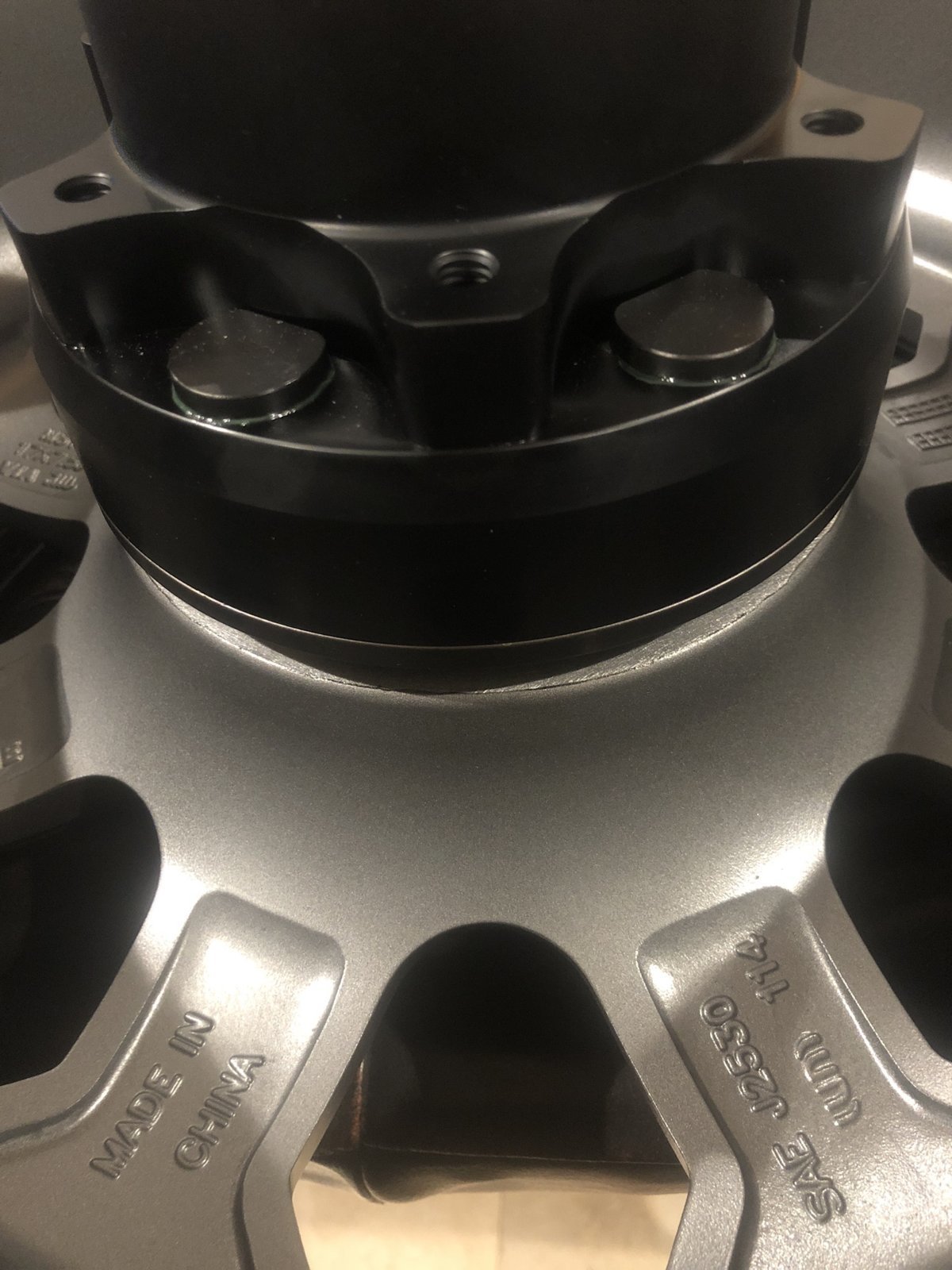

    Or you could drill out your hubs for longer 5/8 studs. upload_2024-4-27_6-49-4.jpg

    you’ve actually not been using ET lug nuts until now :eek:

    Do I need to change my wheels for this?

    Depends
    Some wheels have room to drill
    Some don’t
    My racelines I just drilled out

    Though my trail readys came drilled for 5/8 and 45 degree lug nuts.

    Worst problem I had was the shelf of the studs was just a hair larger than the stud itself so I had to drill mine twice
