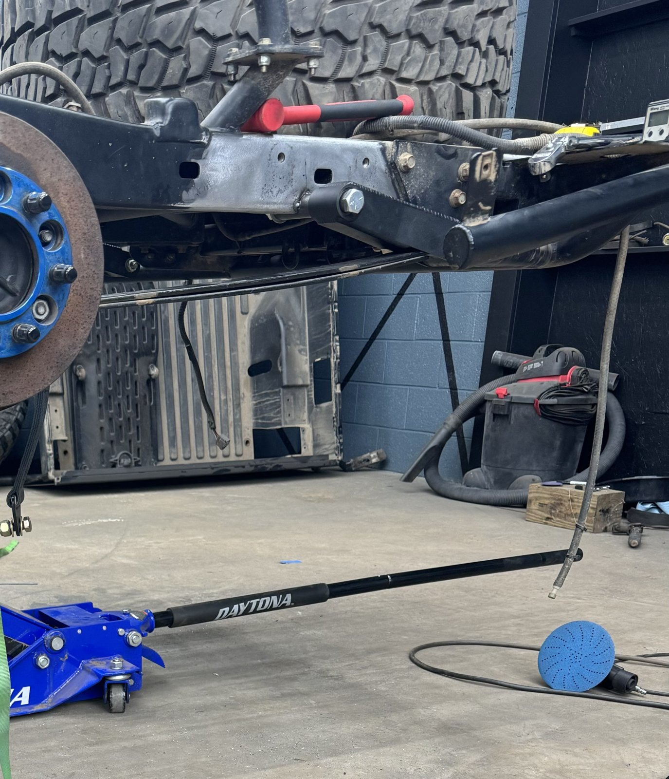

    They are still under the bed.
    Looks mighty close to what my final setup is!

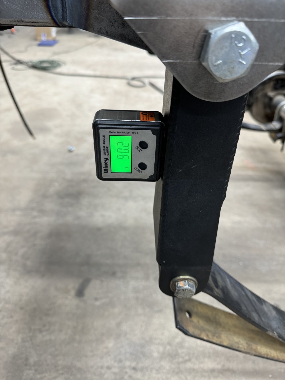

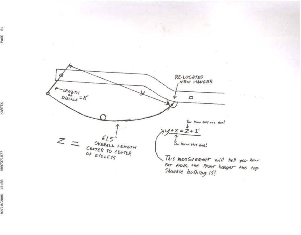

    Full bump to as much droop as the leafs will allow. Won’t be anymore funny business with poor shackle angles. I ended up bringing the pivot to the bottom of the frame to pick up a little ride height.
    Can’t stress enough how big of a change it is. Actually began drawing up a full kit with what I learned from this. I’ll go full commit once I know all is well.

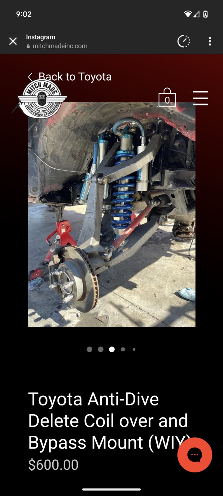

    Spend the money on bypasses and secondary mount for front instead of 10s or like stayed dump that $ into rear!!!
