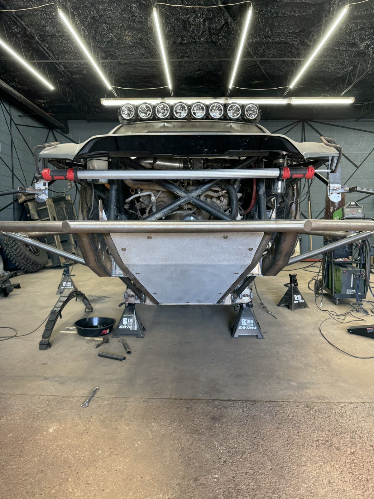

    Smashed out a 1/4” 7075 front skid today. Should have paint on the chassis this weekend, then we turn the other direction. Finally.

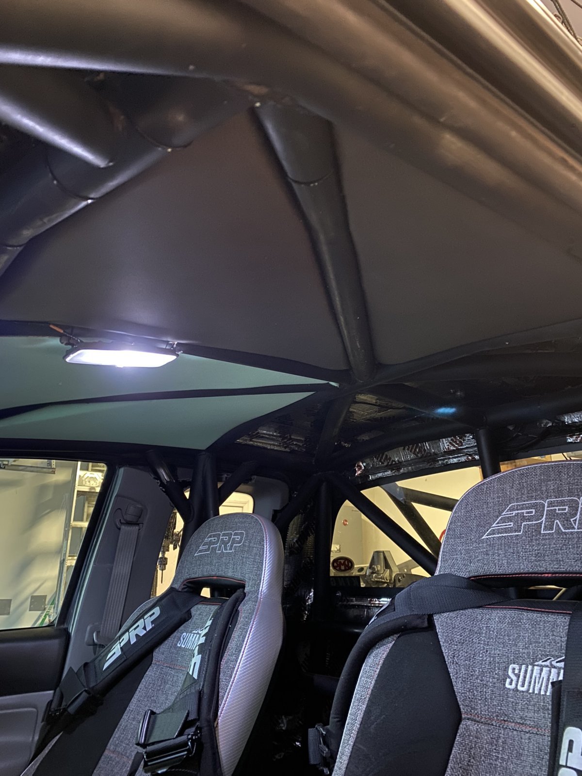

    After the crazy quote I got for what i'm calling 8 pillows from an upholsterer I decided to try it myself to make a headliner of some type. Got some 2 inch high density foam and some leather looking vinyl and did this so far. I'll be gluing the fabric to the foam and it will sit much tighter and nicer is my hope. In the pic the fabric is just being held by some pins but I wanted to see what it looked like before I glued anything.

    meh…unless you leather wrap and baseball stitch the whole cage like the SMP taco there really is no point
    if you are using a rattle can spray adhesive make sure that you use a good amount on both surfaces but you have to be careful not to make lumps in the spray adhesive or it will show through the vinyl. if you end up with any wrinkles or lumps use a hand held steamer to reactivate the adhesive and rub one out…er i mean rub it out

    I bought a glue that can be sprayed from a paint gun. all the youtubers say stay away from the spraycan stuff if you can

    oh yeah for sure that is the best way to go, every time I suggest that to people they think I’m nuts but the glue is so much better. Did you buy a primer gun with a larger bore ? And did the videos cover thinning the glue and cleaning the gun etc ?

    I got Tolulene as it seems to be the preferred thinner for the weld wood glue. Mineral spirits to clean. Gonna use an old harbor freight gun and hope for the best.

    typically the bore size for the nozzle needs to be at least 1.8 or a primer gun or you’re gonna have issues
