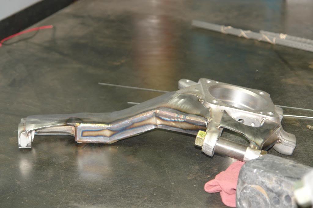

    Alright, seems pretty legit, with the double sheared steering mounts and all:cool:

    It does look pretty spiffy :D

    :cookiemonster: is that outlaw offroads?

    Yeah, one of the few they have

    Its the spindle that they build for the Beast FJ. Its a stock 2nd gen spindle that has been stripped and then they made 4130 plate that is tig welded all around the whole thing to make it stronger and bullet proof. I have seen them in person and they look great and are beef.

    Yeah, that's what Pat was telling me, probably cost an arm and a leg tho:cool:
