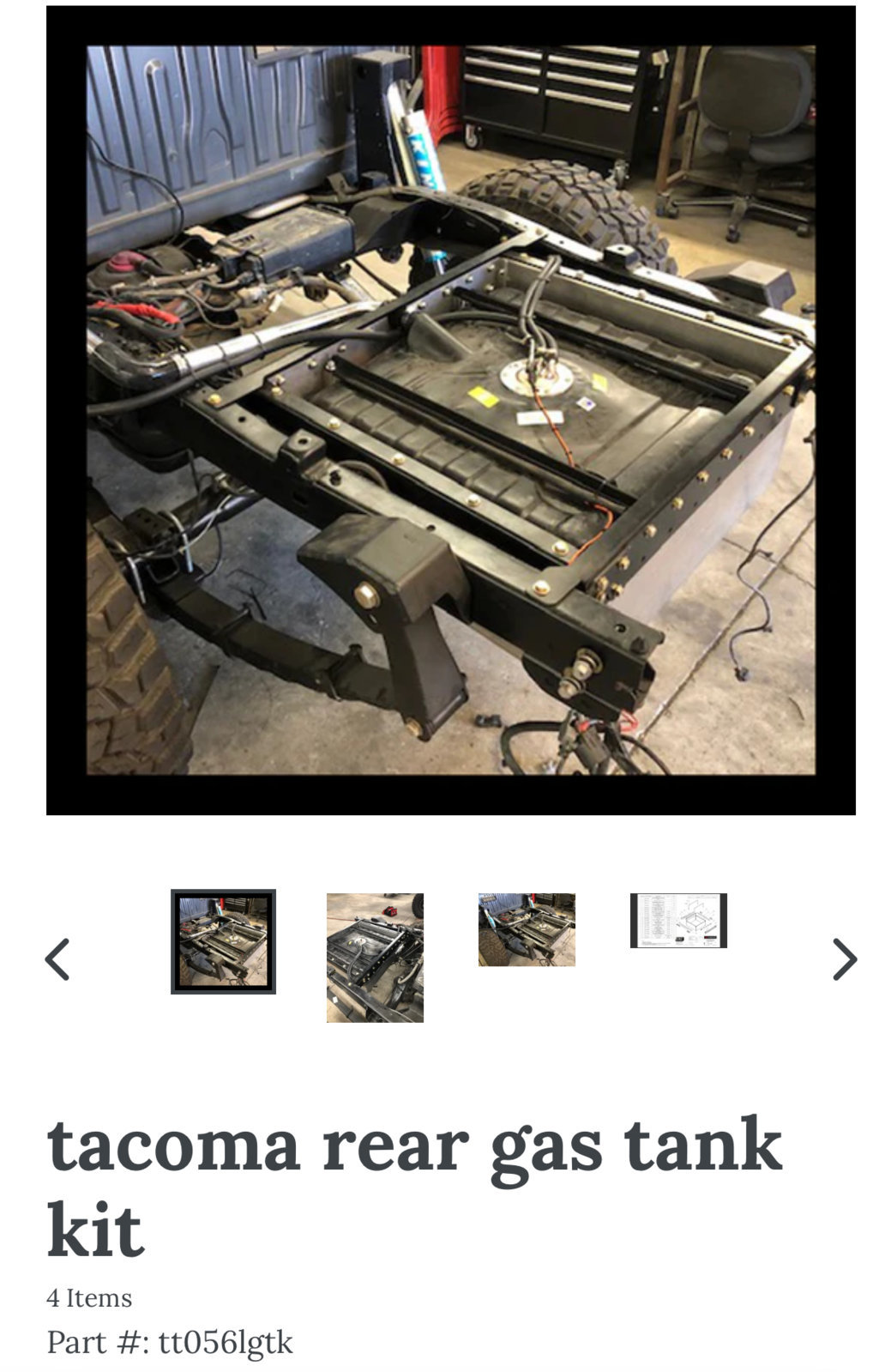

    I will have the 25 gallon tank ran as an auxiliary tank. You can transfer fuel on the fly.
    This is off JD's website.
    We are now offering a rear fuel cell cradle for the 05 and up Tacoma. You have the option of running our kit as a rear mounted gas tank cradle for either a 25 or 31 gallon fuel cell. The kit can be set up as an auxiliary fuel tank or you can run it as a standalone. You also have the option of running the kit as an "under the bed" storage box for batteries, tools, spare parts etc.
    The kit consists of a complete rear frame box kit that is laser cut out of 1/8" steel. The weld in frame box kit was designed so that 4 new 3/16" cross members can be bolted in place. Once the cross members are bolted to the frame box kit the 1/8" aluminum cradle can be bolted up to the cross members.
    The kit includes everything as described in the PDF document below as well as all the necessary hardware. If you decided to use the kit as an auxiliary fuel tank we recommend purchasing the parts below. Utilizing the kit as an auxilliary tank will allow you to have up to 52 gallons of gas on board! When setup as a transfer tank with an electric fuel pump you will be able seamlessly transfer fuel on the fly with the flip of a switch. No more need to carry clunky jerry cans and even better is you dont even

    Exactly why i chose to do add this. I have 2 Jerry cans but that turns into a mess. I love the fact you can transfer fuel on the fly. This adds more than double fuel capacity.

    I want something like this but without having to remove the bed. I got too much shit in there to remove it.
