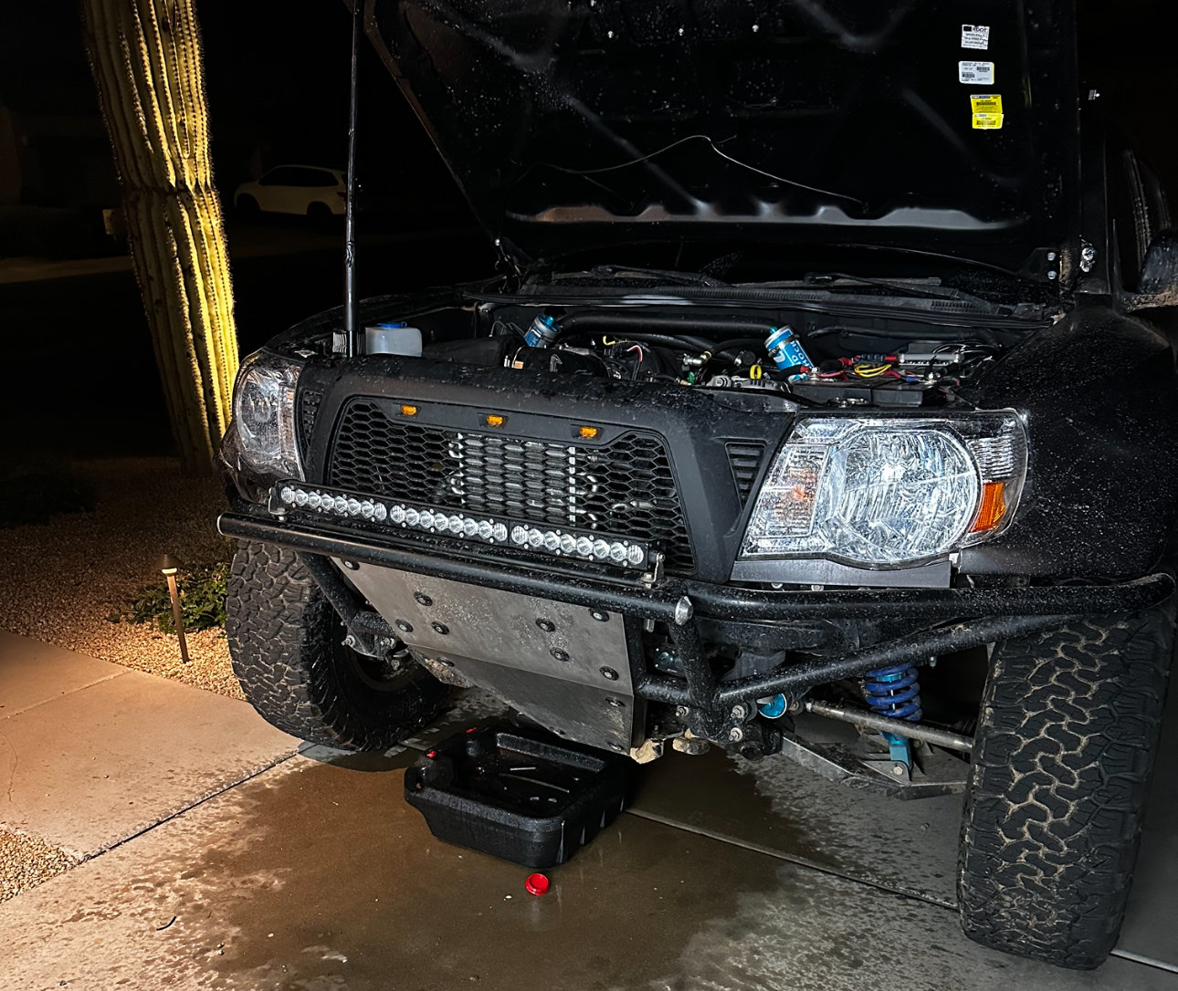

    Do you plan on mounting the P/S cooler like pictured. I had asked Howe about that and If remember correctly they stated that the outlet needed to above the inlet. My concern is of air possibly getting trapped. I would also try to get the reservoir higher so the outlet to the pump is all downhill.
  13. May 12, 2024 at 6:17 PM
    906taco
    906taco Well-Known Member
    Jun 22, 2021
    #369289
    3,903
    Cory
    08 Taco
    Absolutely. I’m definitely not the only one running horizontal. My system bled perfectly fine this evening and first start/run was flawless. It was the best location I had available to me for most optimal cooling.
    FWIW, these coolers are basically straight through. There really isn’t a place to trap air.
    And as far as line positioning goes, as long as your reservoir fluid level is higher than your hoses, you won’t have issues. No joke, 4 turns lock to lock and I was 100% bled. Zero pump noise on startup. So definitely no aeration.

    My cooler is also horizontal and never had a air issue… there is pressure pushing thru so the chances of air actually sticking is slim to none.

    Good to know as I may need to relocate my cooler in the future for mounting a winch.

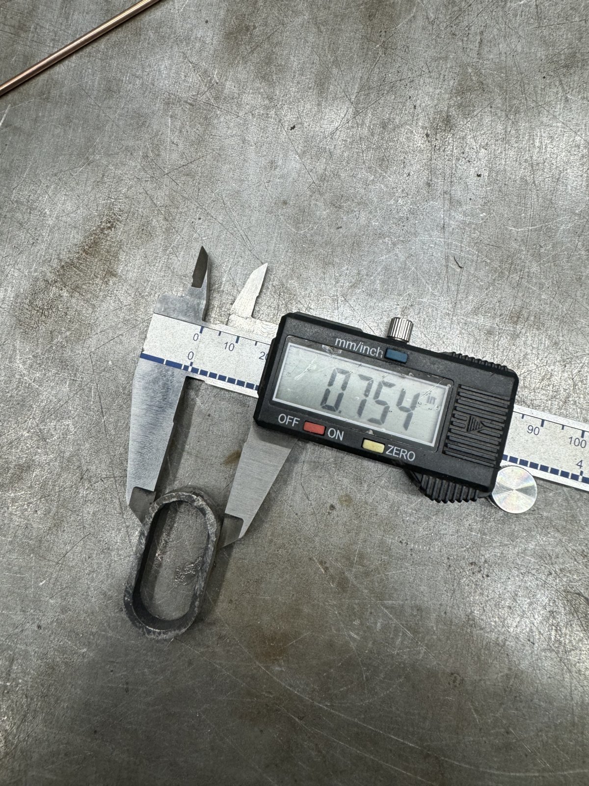

    Something I wanted to put out there for the JD pivot guys.
    I believe the new version of the pivots is different, however the early version had rings to reduce hole size down to 9/16 for the 2nd gen.
    With those rings removed, the slots are actually .754”. So instead of running a 5/8” bolt it really should be a 3/4.
    I had my uniball spacers opened up and a flat cut in a 3/4 bolt and simply moved my front cams to the rear as my fronts are different now.
    May be worth a call to JD to see if Jesse would work with you to up the rear cam/bolt/spacers to 3/4.
