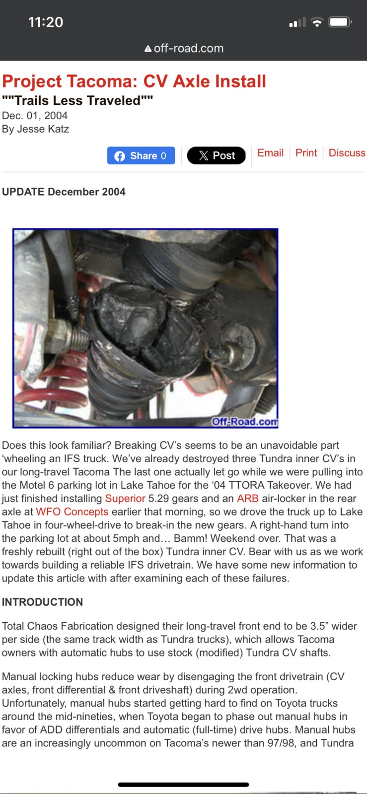

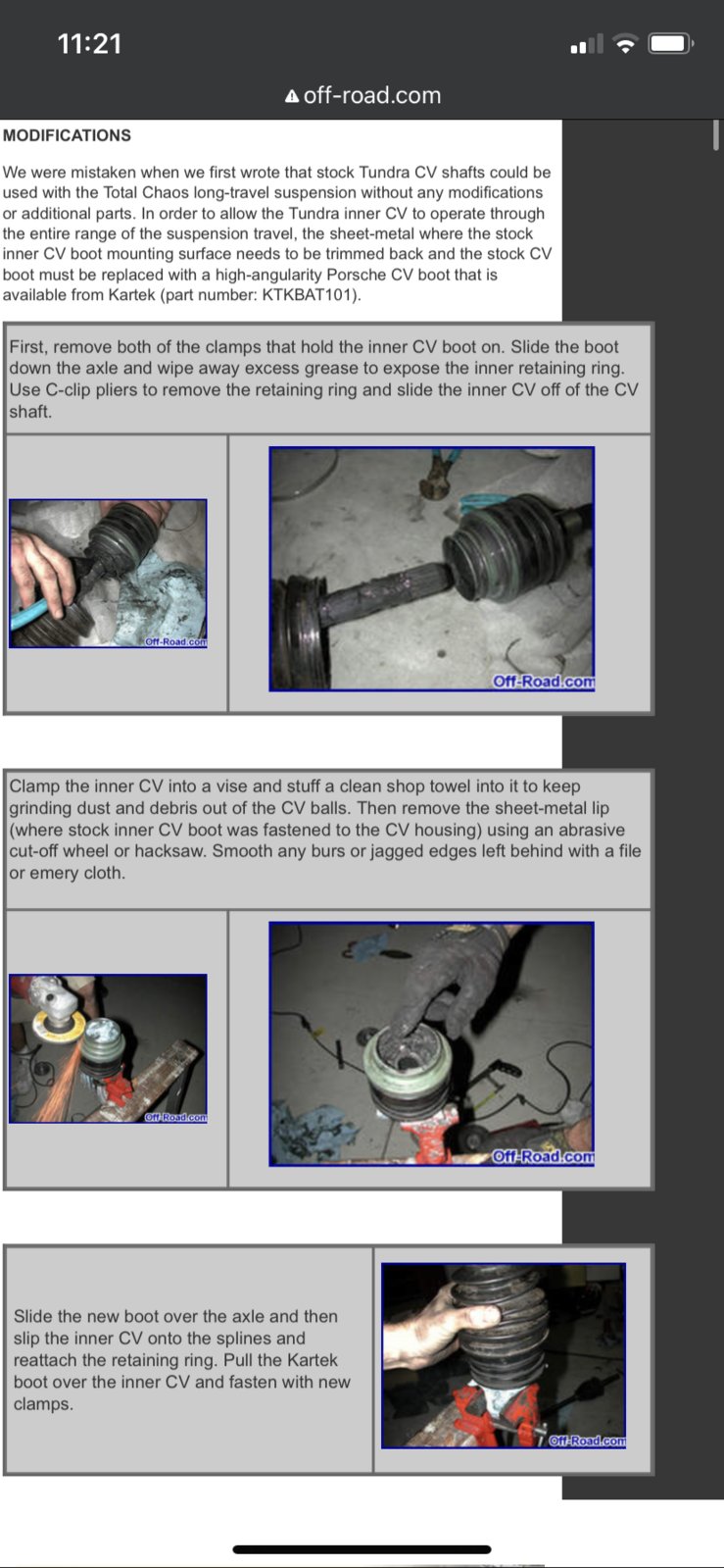

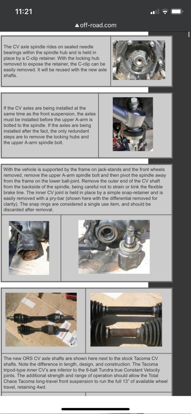

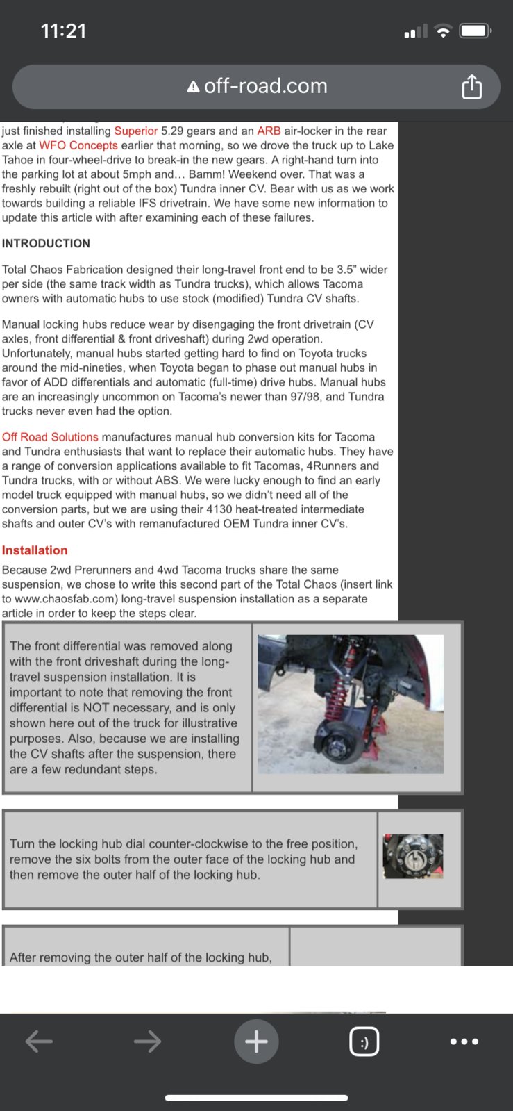

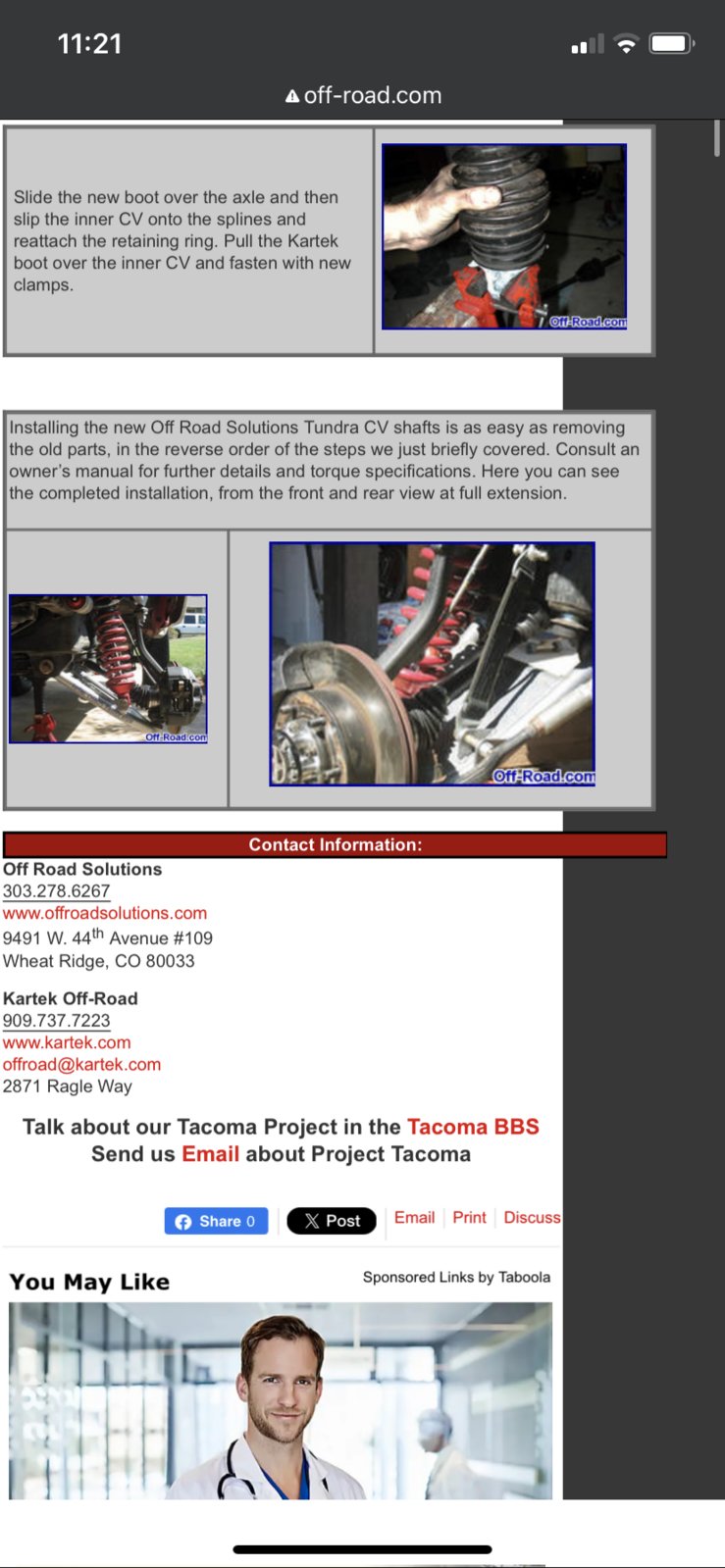

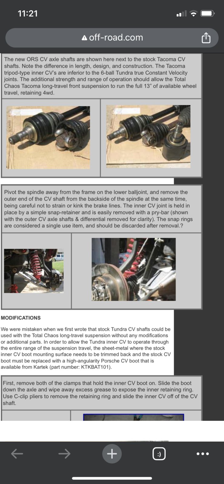

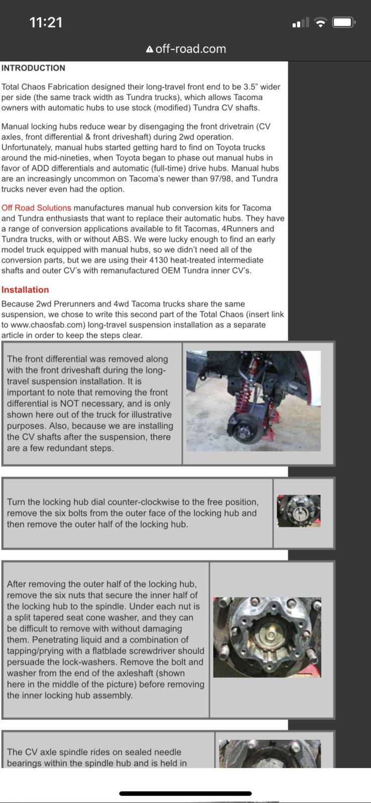

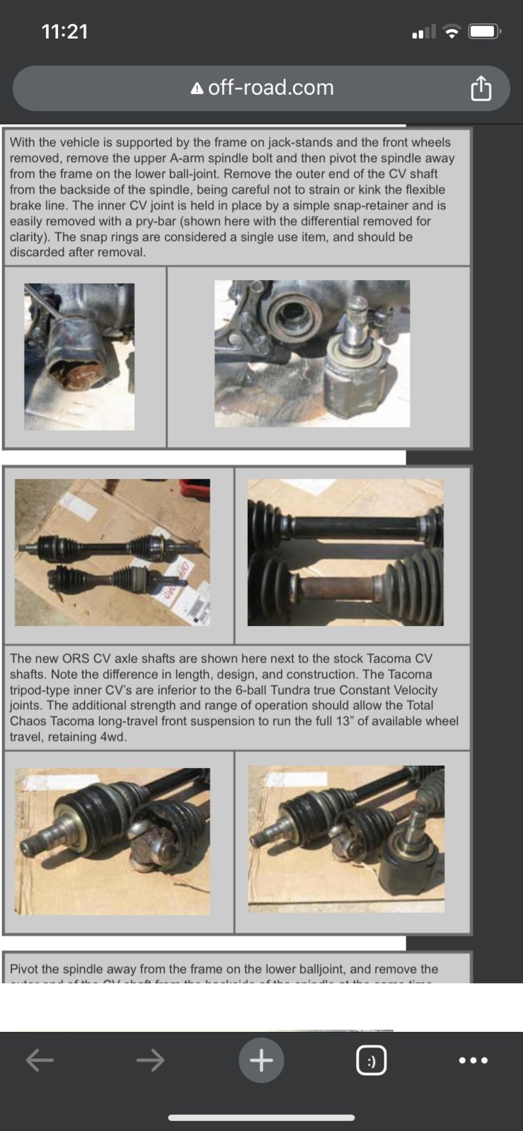

    Hands down the best kit I’ve seen for the rear keeping the stock tank and not going through the cab for shocks is the FGP 3 link that utilizes coil springs and 12” / 14” shocks. A MT front setup and this kit will do better than a front LT setup and a stock 5 link in the rear.
    https://optoffroad.com/products/96-02-4runner-rear-lt-three-link-kit-lt3?variant=43661255082242
    I’ve got solo uppers and lowers and just a 10” ADS shock relocation out back waiting to go on with some oem king smoothies for the moment. Really interested to see what the outboard relocation will do with reducing body roll out back. I’ve gone from 27 year old stock springs to Moog to OME 906’s and have a pair of 891’s I’m sitting on until I see what I think about the 906’s. For what it is - my wife’s daily - the 906’s are fine. But they sag if I put all my tools in it and drive to work on my Tacoma.
    @Dayman Karate
    4B977094-03A1-4EA9-87FB-757ADC9DF327.png DA3039EB-D452-4ECF-BA1E-61976AF3F8F6.png 3D9C80FA-2765-4D1D-9B07-A643AEBDC79A.png 2FB51A0F-EF9F-4031-B3FF-85C7CAC3BBE2.png 56235F30-D83A-4027-BF16-E11E6A97CCAF.png 9225F98B-E4D7-4A66-8908-5CDB2EEE638F.png 6542C795-AFBA-4E44-B8A6-EF0FF903AE50.png 2DAE782D-0D4F-4C80-ADE1-5A99633FE235.png
    https://www.off-road.com/trucks-4x4/project/project669.html
    Website sucks so I posted screen shots.

    I just ordered that same kit last night lol after looking everywhere else it seemed like the best that’s out there. I got their taller shock relocate and a bunch of other goodies, too. Curious what coil length will be needed to keep up with 14” shocks though or am I overthinking that?
    Thanks for the screenshots. Looks pretty easy. Thought I’d have to grind the cup like some of the LT 2nd gen tacos had to do. At least I thought I’ve seen that somewhere…
