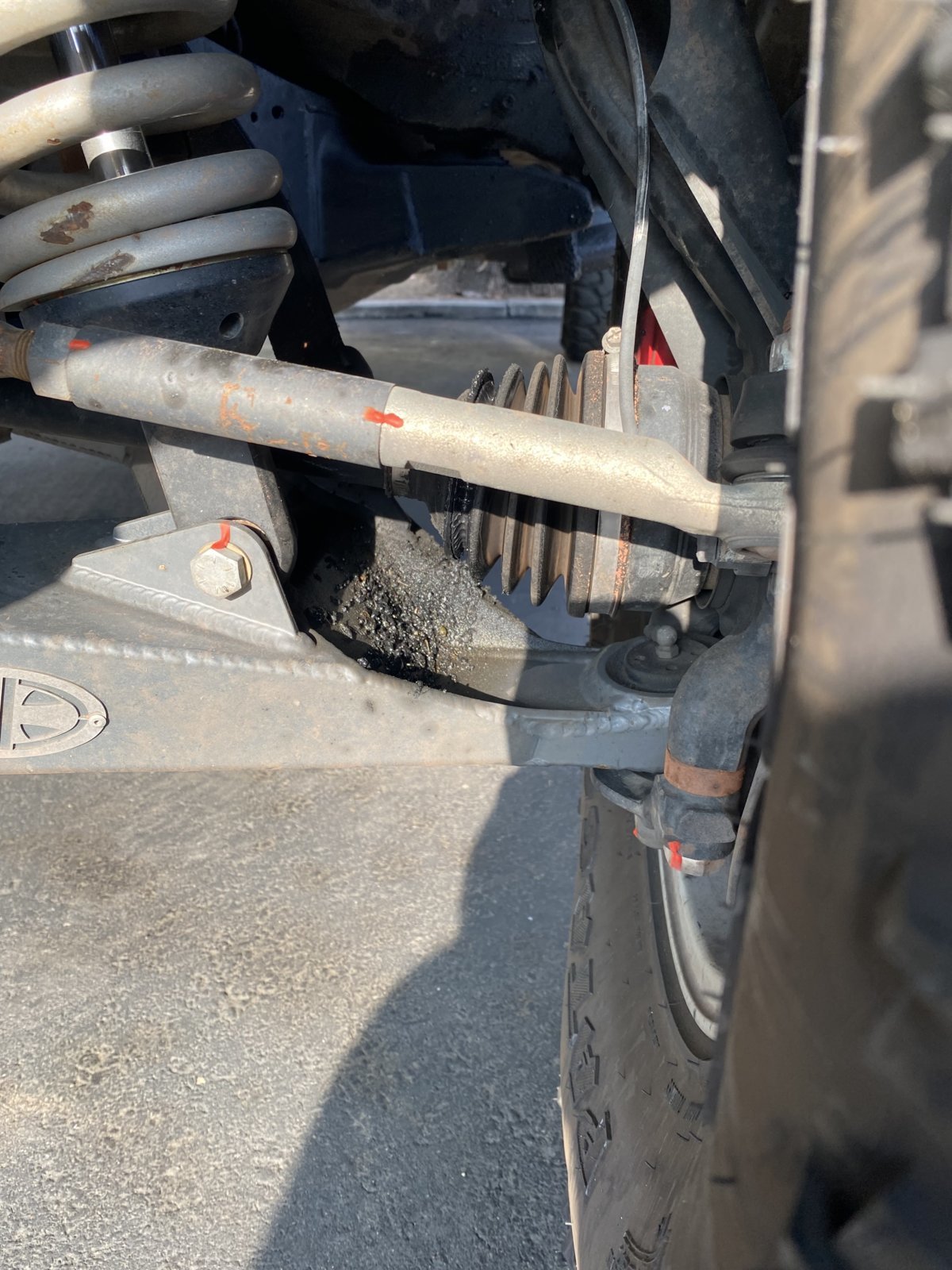

    Welp. Wonder if this has anything to do with my driver side front vibration. Boot lasted exactly a year.
    SoonToBeOn39s likes this.

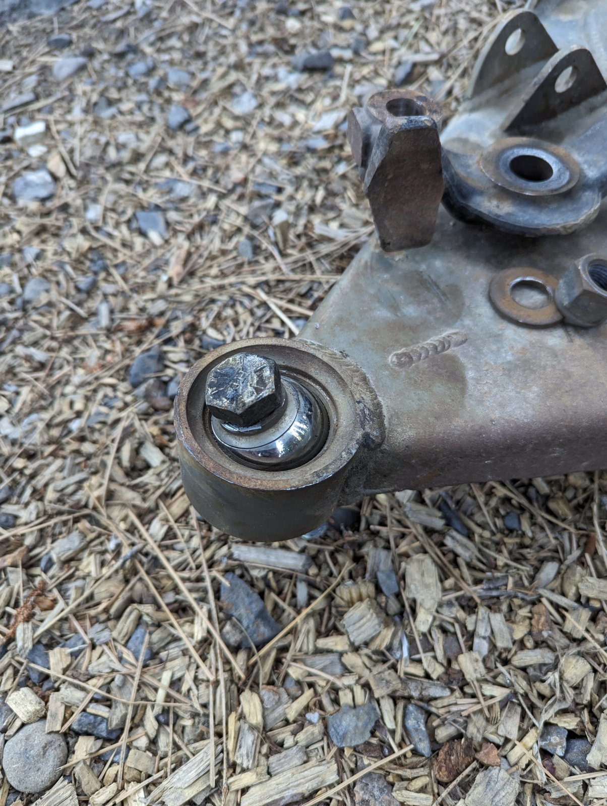

    Y'all got any tips of getting the bolts out of the uniballs? It's like this all on 4. Or just scrap it and get new uniballs?

    Well Im stumped. Bolt is stuck in the uniballs, so a uniball press wont work. Smacking it with a socket won't work either.

    Heat and pounding got mine out but I never had the bolt seize to the misalignment soacers.
    I had to use a buddies 20 ton press for one of them though.
    SoonToBeOn39s[QUOTED] likes this.

    Interesting. Worse comes to worse I'll take it to an axle shop and have them press it out. Good thing it's Friday!!

    Might try a ball joint press, they have different size cups and one might fit that.

    I wonder if you could set up your arm in a vice or clamps and then use the bolt similar to the bolt in the uniball removal tool and somehow use that frozen bolt to pull the uniball and bolt out
    I def think heat will help
    But that bolt is def bent if it’s that seized
    So heat will likely only do you so many favors
