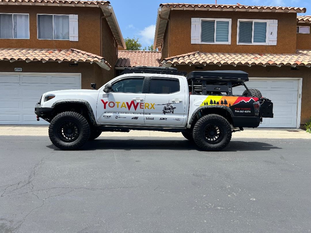

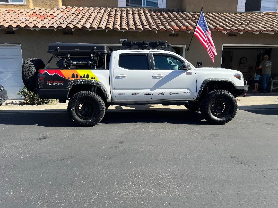

    Learning as I go here. I have an appointment at Deaver next Tuesday to do just that. Jesse and Jeff at Deaver's talked and have a custom spring setup in mind hopefully gets me where I want with both an empty and full auxiliary fuel tank. 157.5 lbs of fuel when full. I need to get a new weigh in with all the extra weight that has been added. With the prior SOA my rear bed height was at 54"s now with the SUA and extra fuel tank topped off for both OEM tank and auxiliary I'm sitting at 50 1/4"s. Pretty serious squat going on at the moment. If i can gain at least 2.5"s with the custom spring pack I think that will be ideal and ride quality shouldn't suffer when auxiliary tank is empty.
    Before with SOA
    After SUA
    After SUA

    Gaining more travel, moving the shackle to the bottom hole, new proper king bumps installed adjusting the bumps position (up) and adjusting the strikepad in order to have more bump zone travel while fully loaded. its interesting they installed you with shackle in top hole. Was the after picture with the aux tank full?

    Unfortunately I'm locked into what I have. If needed after the custom pack I may end up moving the spare into a custom bed mount to help get some weight off the rear. Jeff at Deavers's feels confident we can find the right spring setup to make work.

    That's how I was sitting on F67's and H70's. Deaver made me a set of H70HD-"HD" which had an extra spring. I gained almost 5" of ride height. My dry* weight was 2880# front, 2480# rear (5160# total). *dry weight is all loaded with no food, drinks or camping gear.
