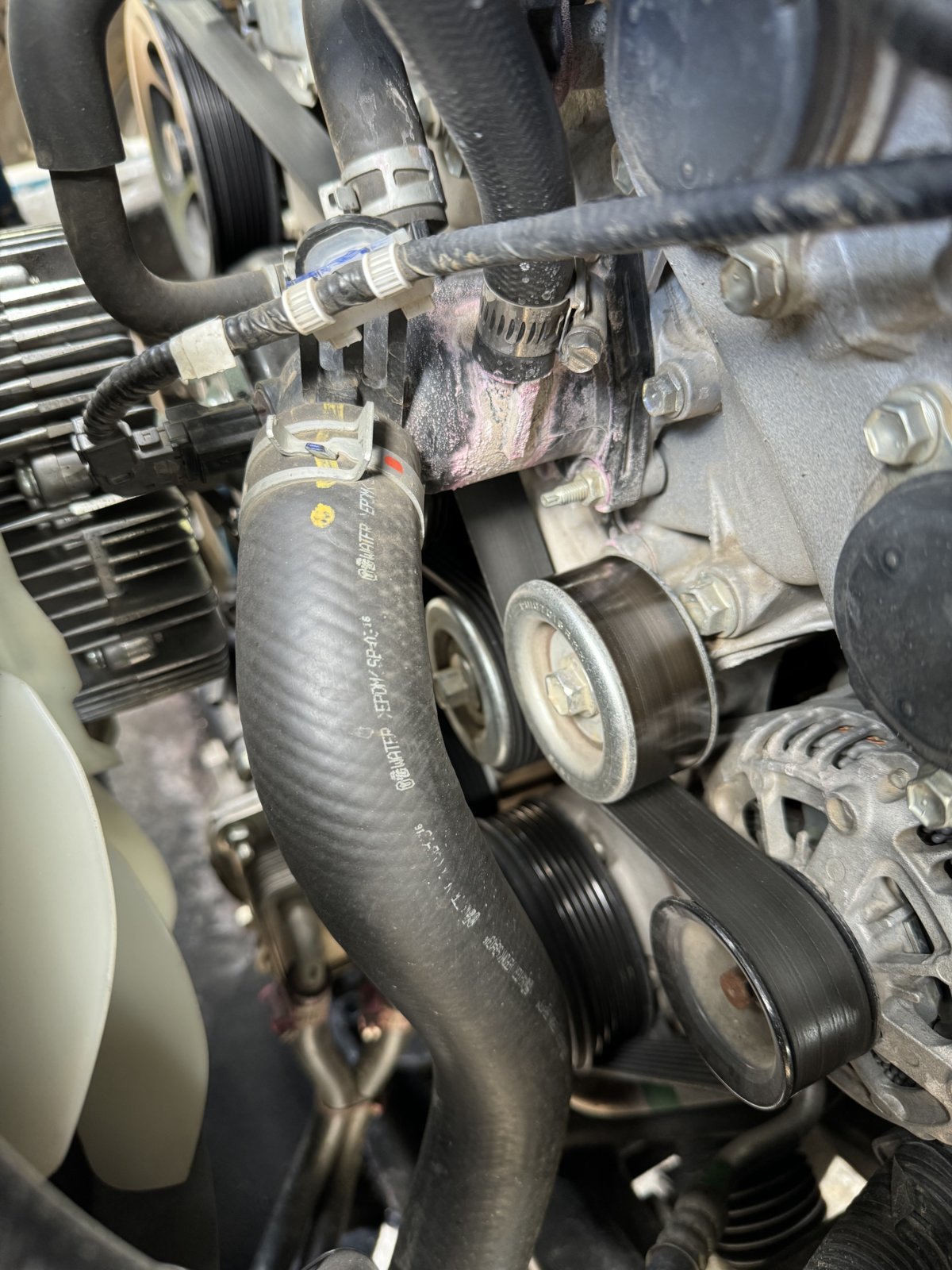

    So.. took it out for a clearance test and I got a coolant low alarm.
    Leak at a fitting, maybe.. hopefully not a pink milkshake.
    If it ain’t one thing, it’s another!

    Yep. Clamp on that upper radiator hose was loose as fuck. Luckily it didn't blow off while I was driving. Guessing it came out of JD Fab like that. Leak was so slow that the coolant was drying on the skid a drop at a time and never left a puddle.

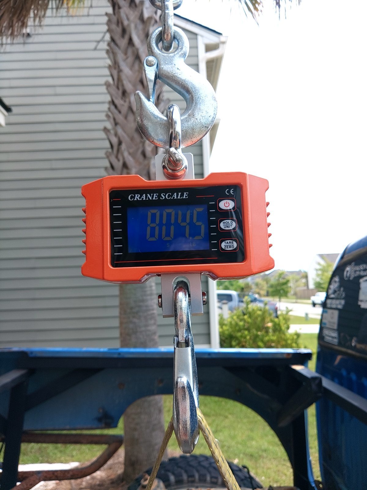

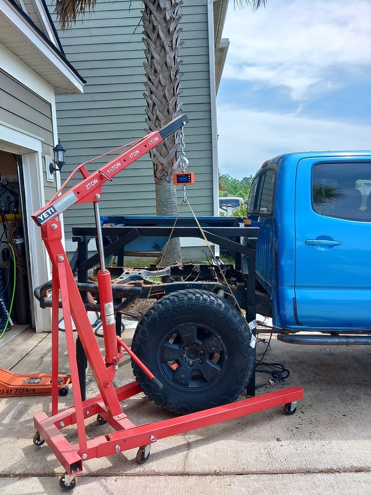

    Highly recommend anyone who does their own work to go onto Amazon and get a lifting load cell for like $40. Paired with a lifting sling and engine hoist, and you can get corner weights any time you want. Also great for weighing the axle/wheels/tires assembly to find precise unsprung weights.

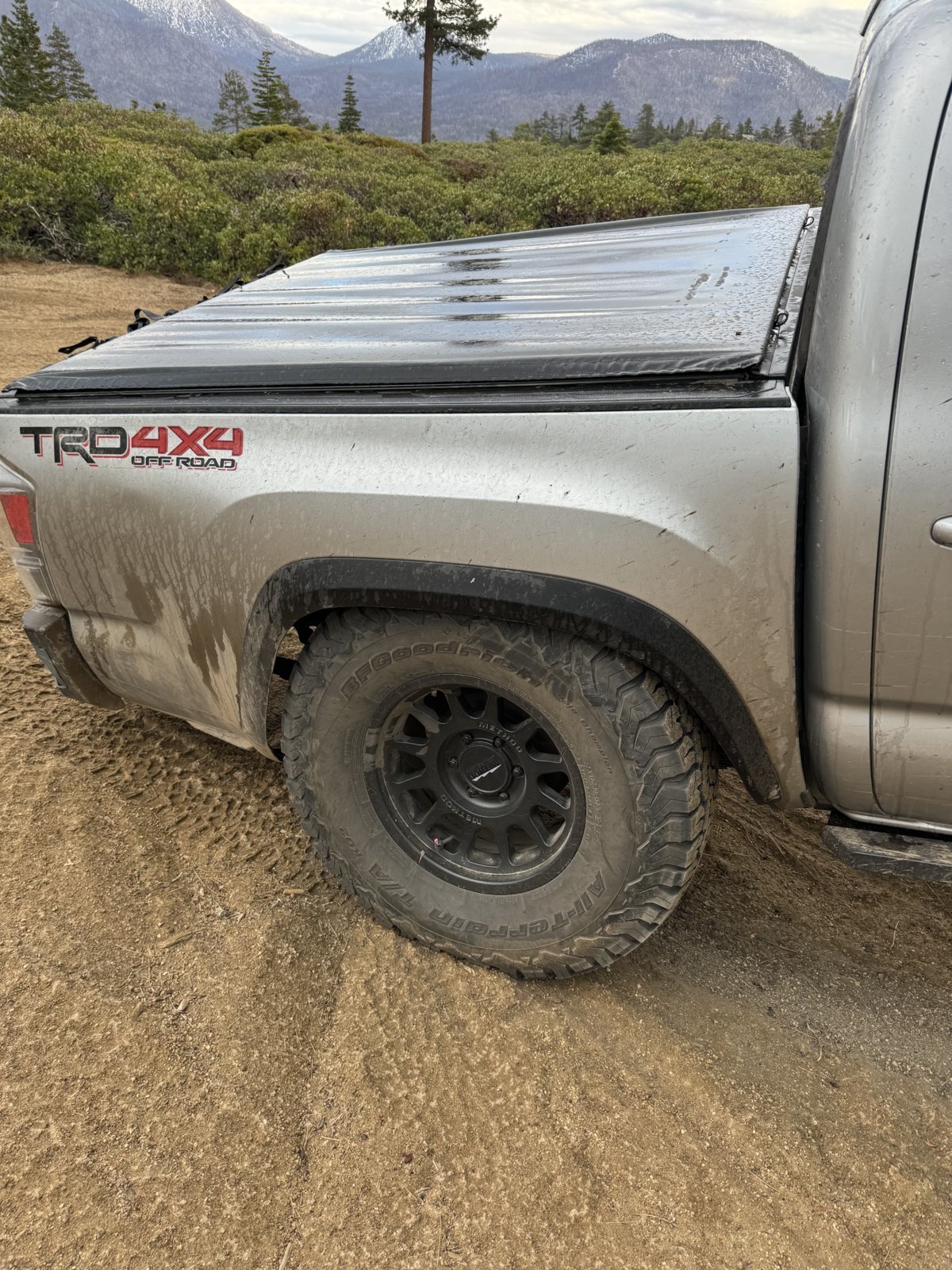

    Clearancing success. Neatly tucked up under the fender. Still lots of travel left on the other side so we’ll see how that goes.
    Hit a baby jump behind my house but it has two sharp turns into it so I had nowhere near enough speed. The front didn’t fall off though. (Yes, two turns into a downhill rut is what passes as a jump nearby.)
    https://imgur.com/a/mTvcV0z

    100% solid call to trim the sheet metal!

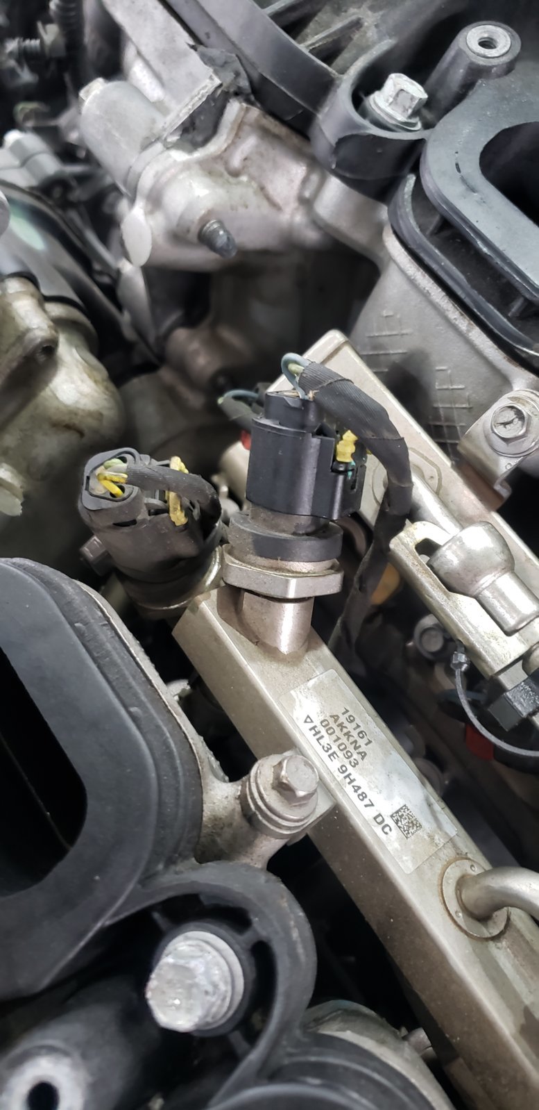

    Did you have the FRP Sensor checked out like I mentioned, should be monitored by viewing PIDS, Desired Vs. Actual

    I went to bring it in but the code wouldn’t come back. What’s the FRP sensor? I’ll take a look tonight.

    Fuel Rail Pressure switch, controls fuel pressure at the high side fuel system. Located under the Air Intake. Gotta get the injectors checked at out too , I think I mentioned that too.
