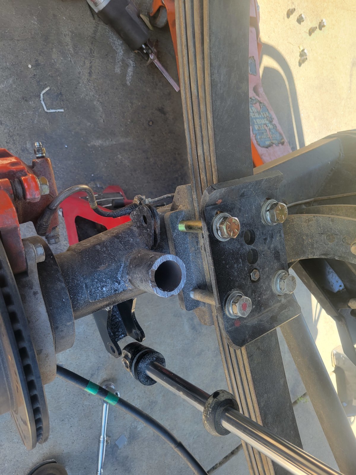

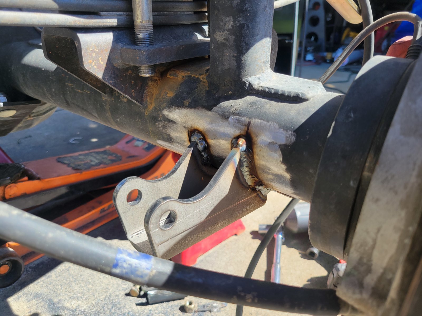

    Been a bit since we got out in the woods. Since Hammers really.
    Identified a few things I wanted to improve after our KotH trip.
    Lowered the lower shock mounts.
    Lowered the bump pads. And added a 5th leaf back in to the pack (63s).
    Also finished the rear limit straps.
    Changes got me to 5.5 up travel, 8.5 down travel. I think I like that spot.
    The shot in the dark I had taken on initial set up was only about an inch off.

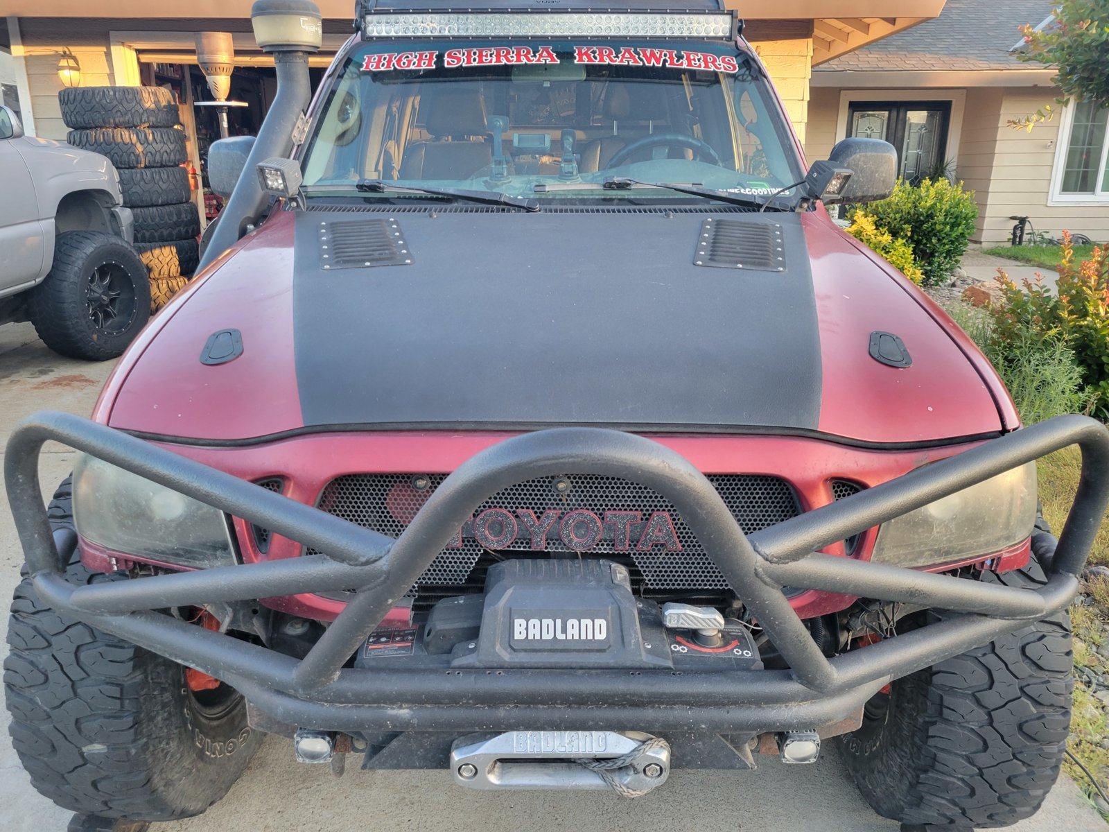

    Added some hood latches, cause the hood tried to pop up on me 3 times on the way to Hammers. Can't have that shit.

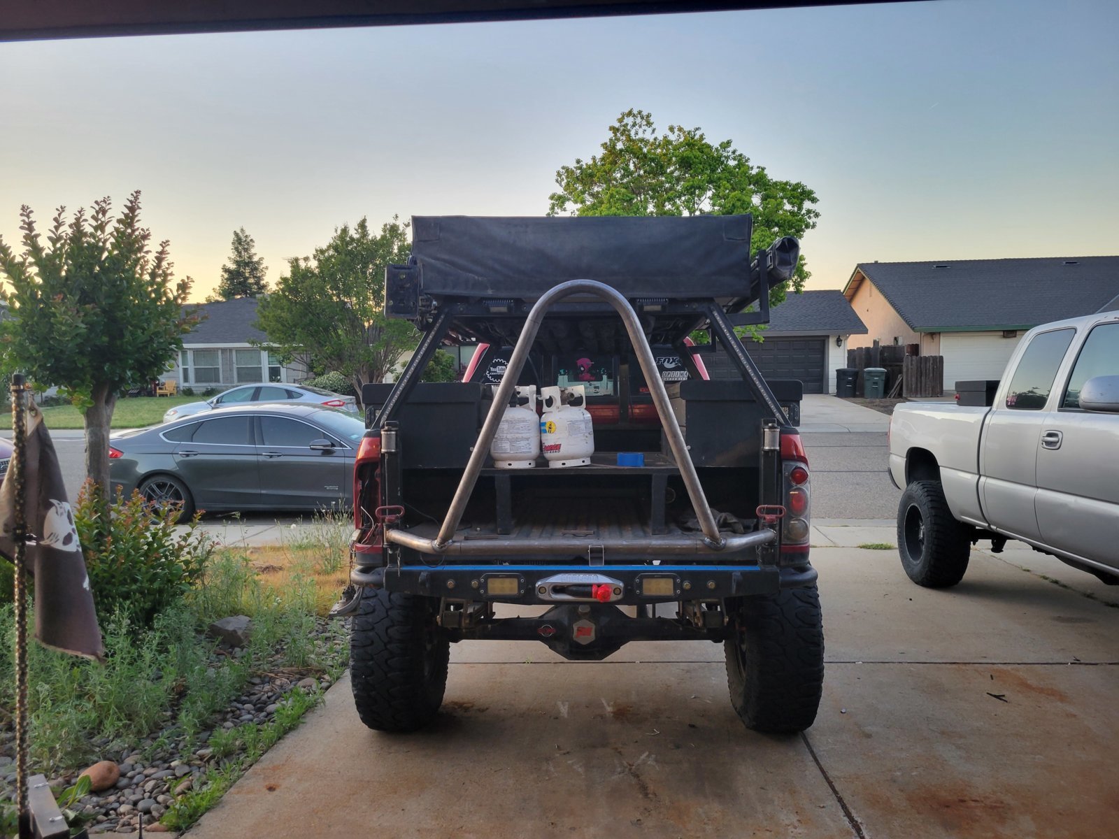

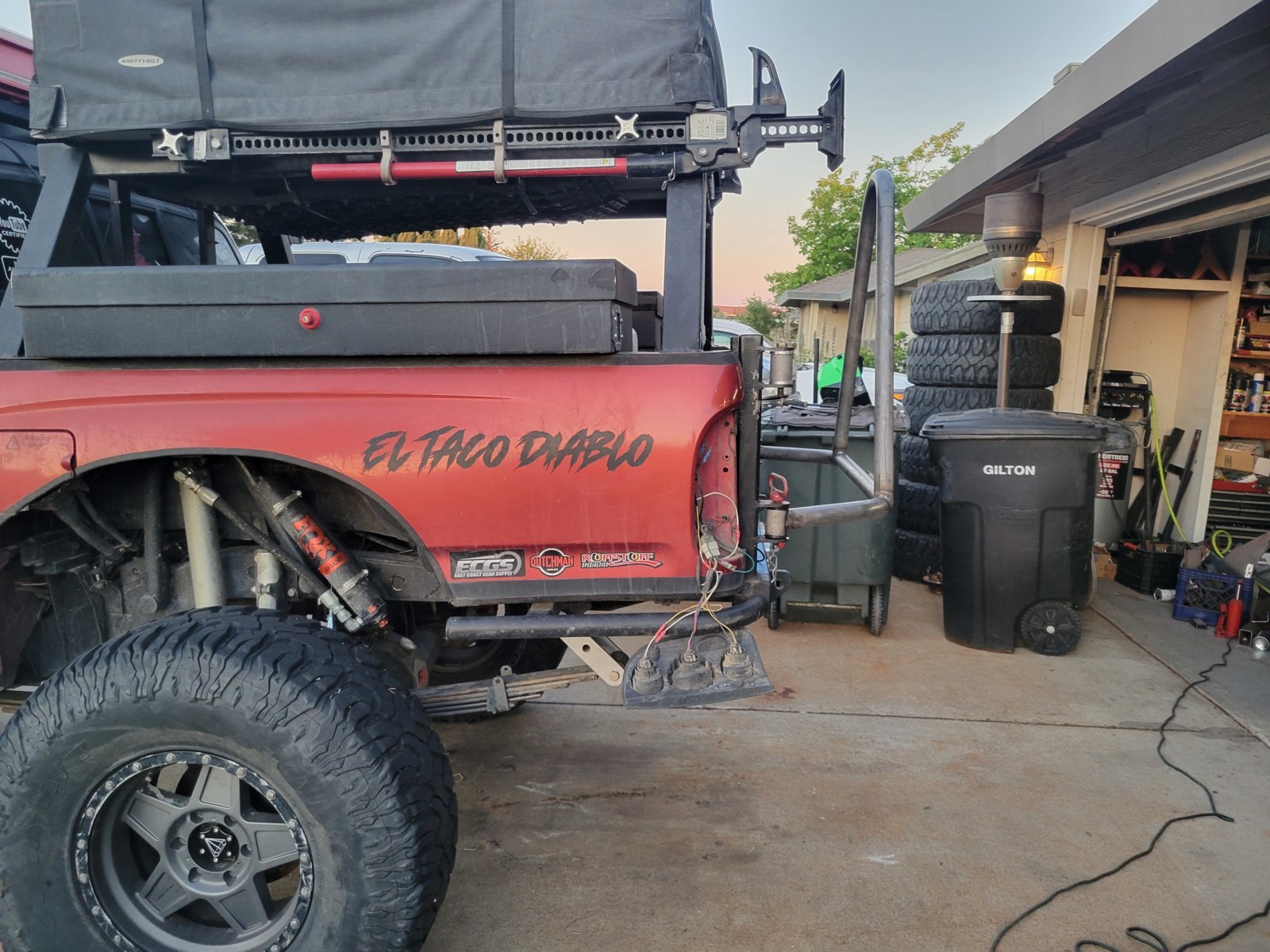

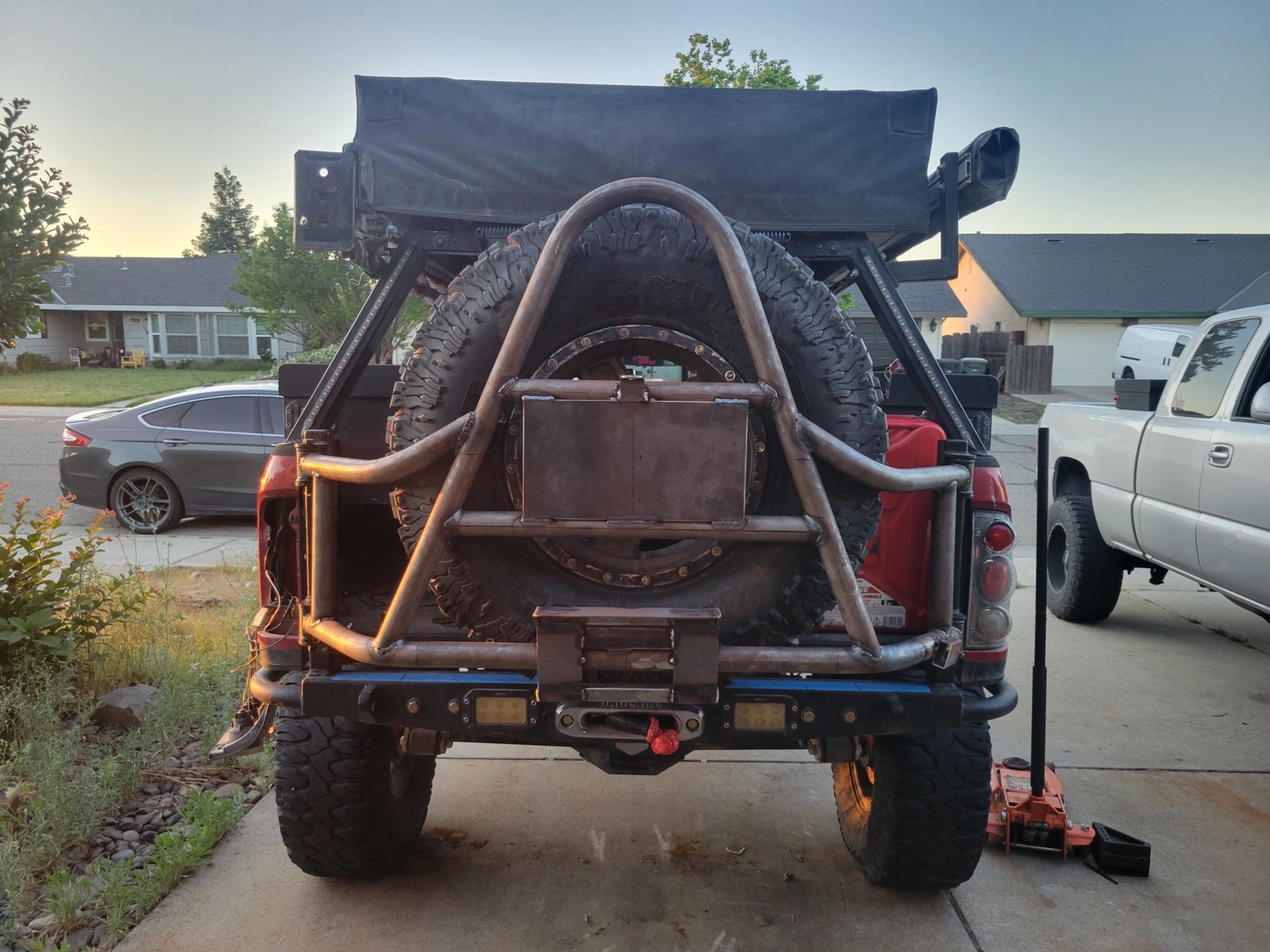

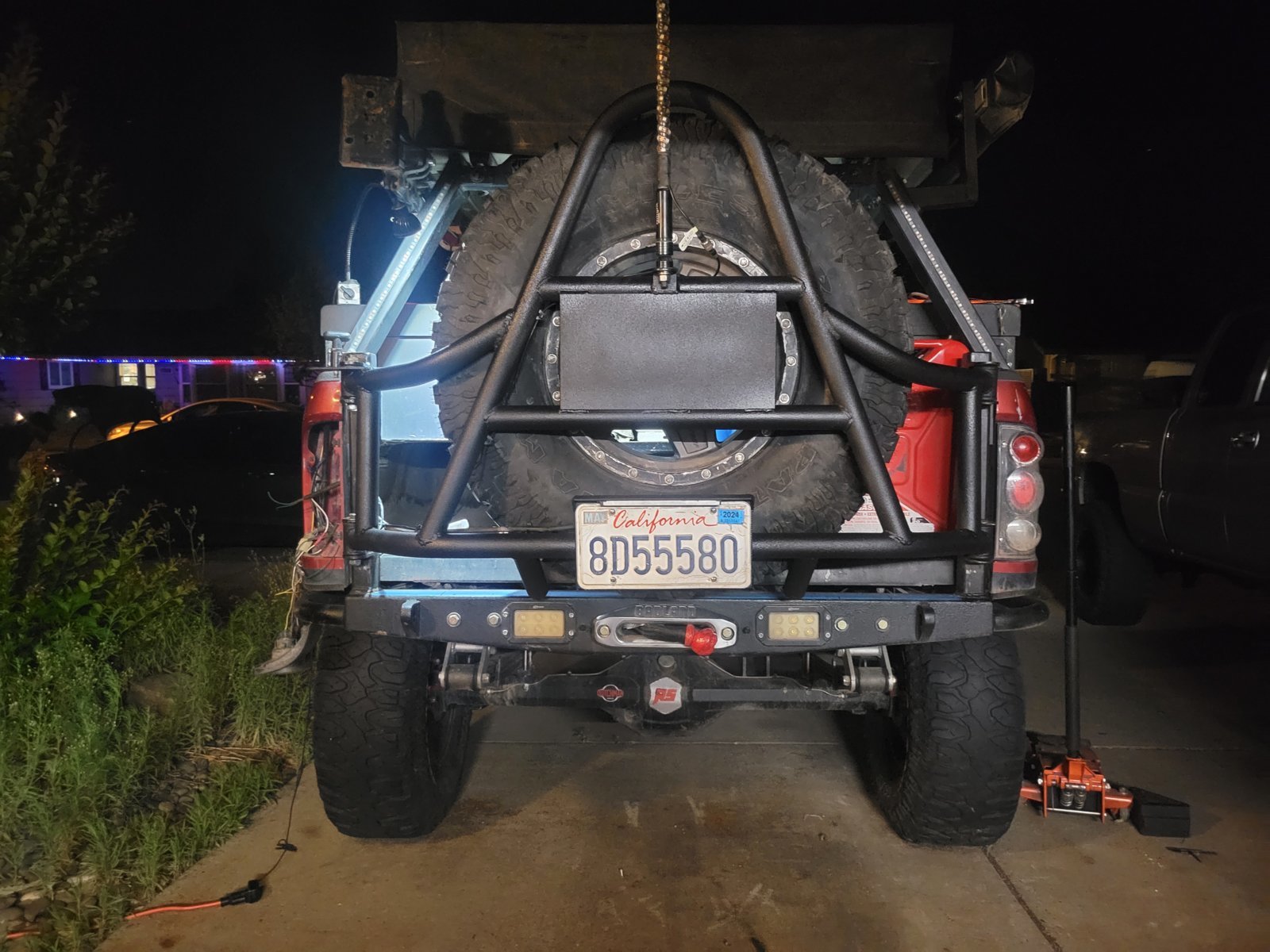

    Did a little project to take some weight off the back, move the spare in closer and get it up out of the way.
    20240511_195840.jpg 20240511_195856.jpg 20240516_195724.jpg 20240517_213601.jpg

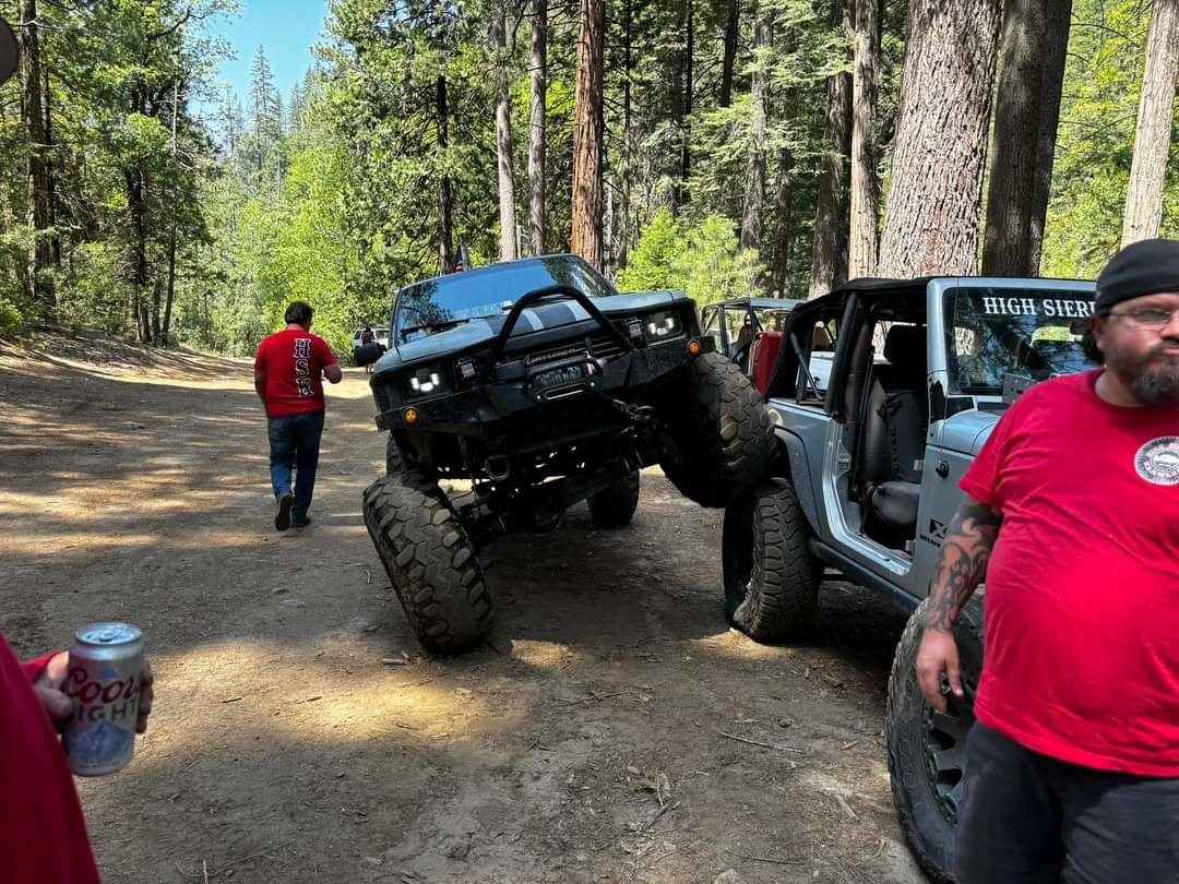

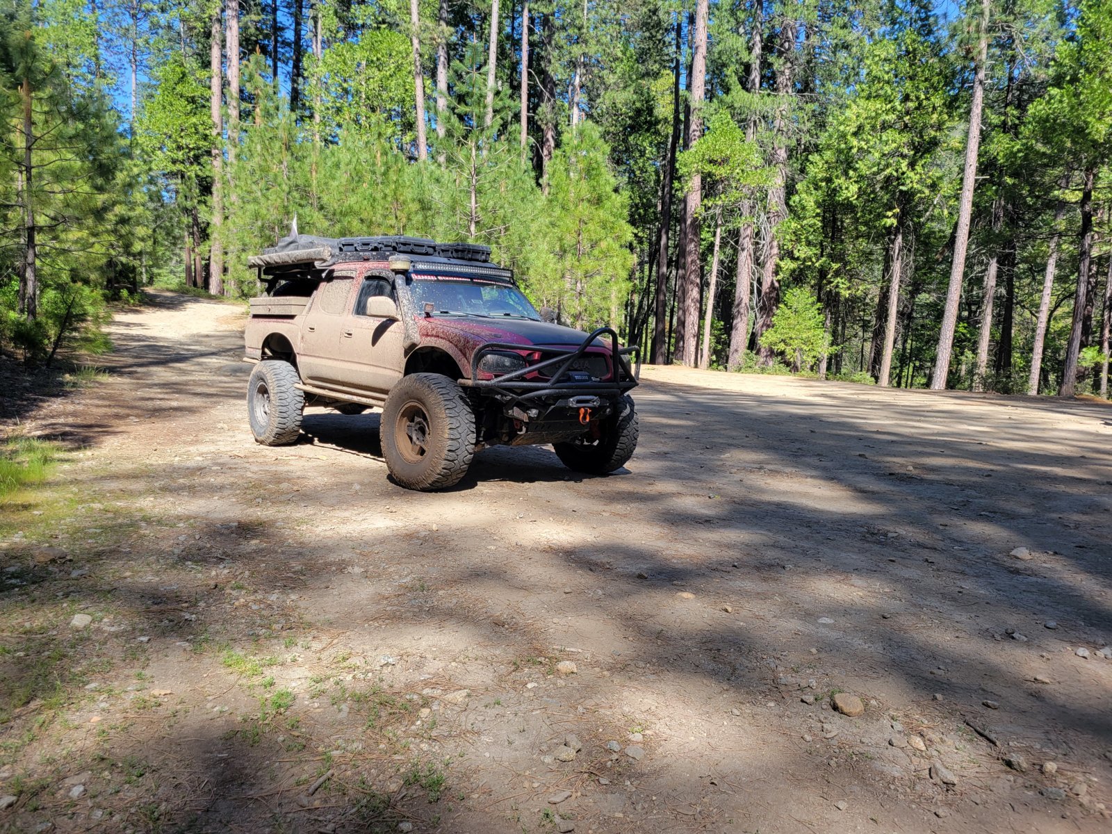

    Got to check things out and hang out in the woods for a bit... much needed.
