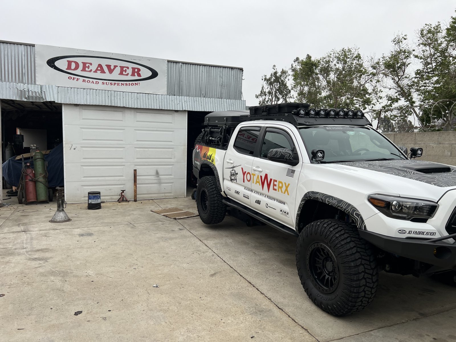

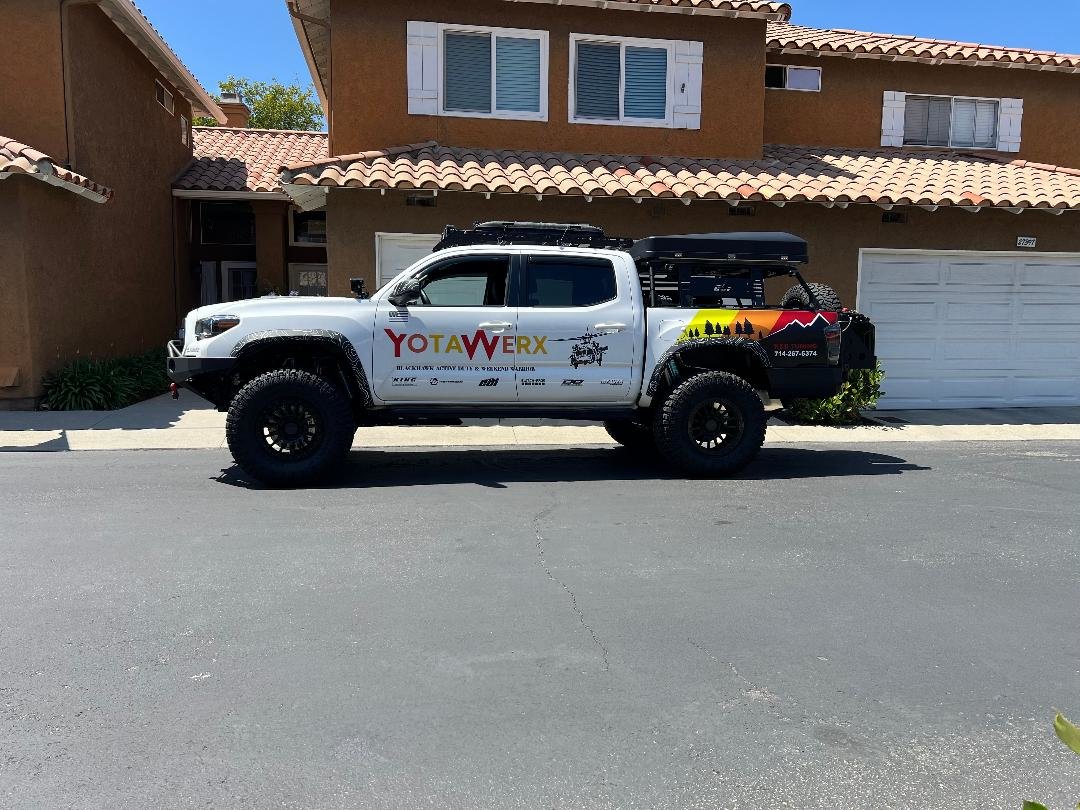

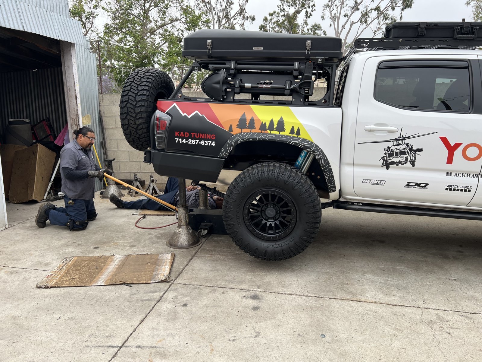

    At Deaver’s this morning getting the leaf pack beefed up and get some of the squat out. :fingerscrossed:

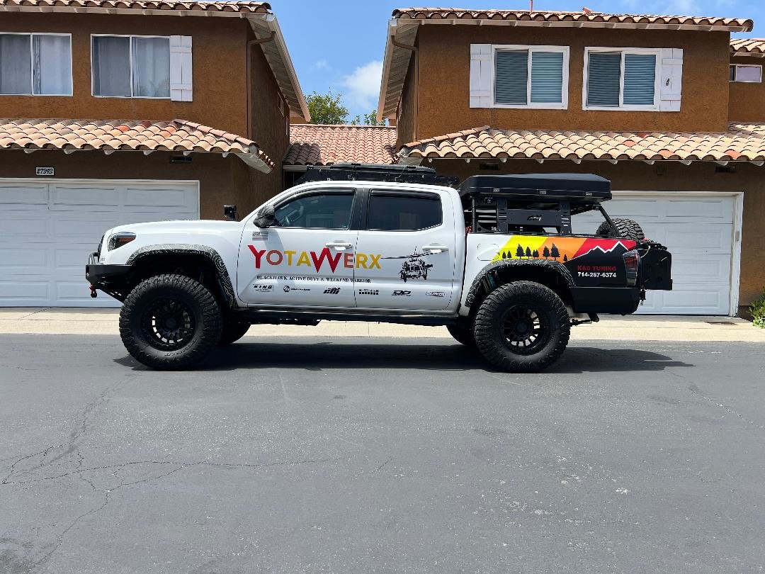

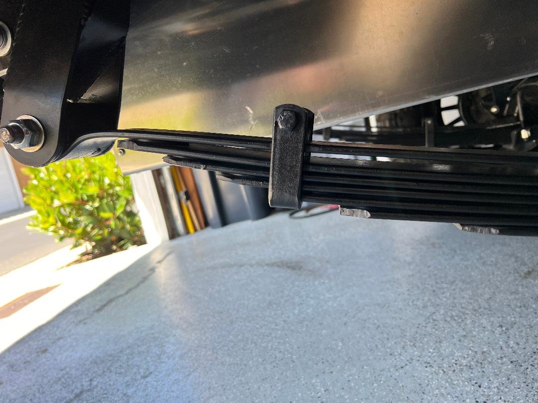

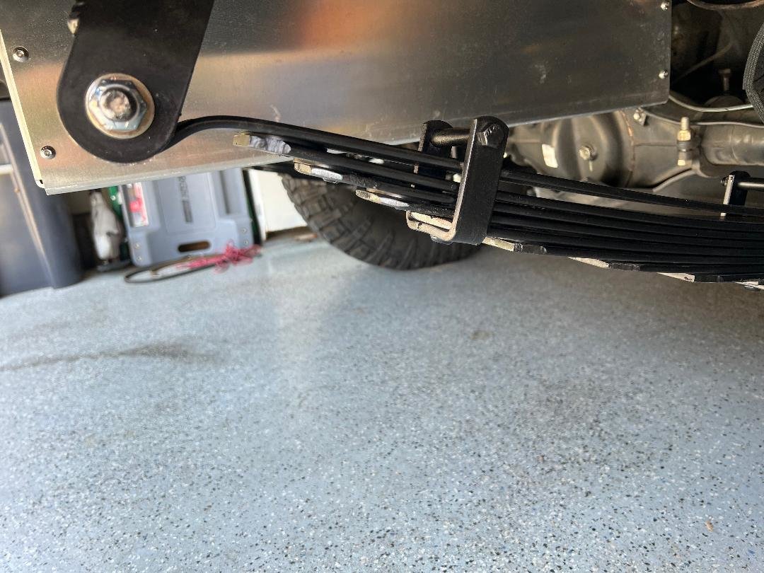

    I was able to gain about 2.75" lift in the rear. My hope was for 3" up to 3.25" but this will work. The ride home was much improved. All the weight and the new leaf pack additions and the rear JD shackles are causing to much stress on the eyelet leaf causing them to lift. Jeff at Deaver's is going to build a custom new set of leafs reinforcing the rear eyelet to be able to handle all the weight and shackle design. It will probably be about four weeks for those to be ready. Unfortunately Jeff said I should avoid wheeling with it for now.
    Before new leafs.
    After new leafs
    Leaf separation.

    Semi-related: what RTT is that? It looks pretty slim top to bottom.

    Ikamper Skycamp 3.0 mini

    Awesome, I was looking at that for a hard-sided option.
    Truck looks great. Stoked to hear how the new springs turn out for you.

    My prayers are heavily with that main leaf. Did they re arch or make new leafs?

    Deaver is going to make a custom leaf pack with reinforcing the eyelet leaf possibly 2nd and 3rd leaf as well.

    I wonder what kind of spring rate them babies will have? Betting nearly double that of an HD. Going to be one thick and heavy ass pack!

    I will share the details once it's complete. But yeah expecting it to be a thick ass pack. I hope it can maintain the good driving qualities it has now.

    I don’t see why you wouldn’t. Though, you’re probably gonna want to lower that shackle to the bottom hole. I can’t see a pack of that rate not hurting down travel at least a little bit. Curious to see if Deaver eventually just releases a spring catering to the really thick gals.

    So this might be a "Super H70HD-HD" pack.

    Is it not on the bottom hole?
