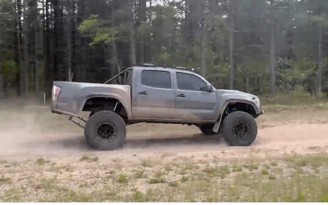

    Came to the realization this morning that I should theoretically be crossing the 1,000 mile mark by end of week.
    Started putting it through some baby whoops over the weekend feeling things out and it’s definitely a different animal. First time I’ve had to start double stacking valving shims in the rear. The shock is truly doing the work now.
    Starting to get ballsy with the steering and actually let go of the steering wheel through this section at nearly 50mph didn’t budge even a little.
    Beginning to look at having the center link/swingers/pitman all done in billet aluminum as I feel there may actually be a savings. The weld time for one of these kits is outrageous so doing anything I can to make it the best possible bang for the buck.
    Been working in my “free” time on designing a user friendly SUA kit that follows this same geometry. All will be done on the wife’s relatively unmolested truck to be sure of fitment, wheel base etc.

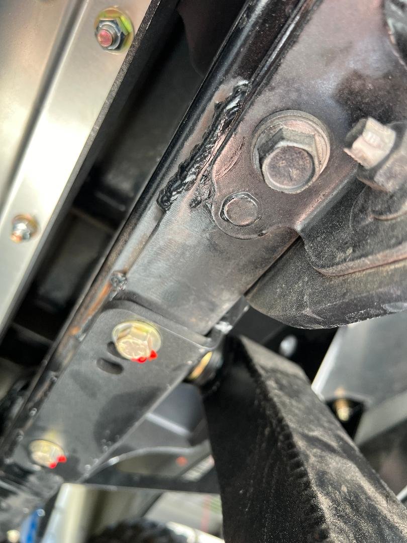

    For some reason I thought it wasn’t because of a bumper or something. My mistake!
  3. May 28, 2024 at 5:20 PM
    TWTaco
    TWTaco Well-Known Member
    Dec 19, 2015
    #172601
    5,979
    Dave
    Jesse had told me originally the bumper bracket was interfering somehow but I’m not seeing it.
    906taco[QUOTED] likes this.
  4. May 28, 2024 at 5:26 PM
    TWTaco
    Dec 19, 2015
    #172601
    5,979
    Dave
    I think he was maybe referring to the shackle mount itself. Looks like the mount will hit the bumper bracket if move back to the next hole.
    906taco likes this.
  5. May 28, 2024 at 5:30 PM
    906taco
    906taco Well-Known Member
    Jun 22, 2021
    #369289
    3,968
    Cory
    08 Taco
    More than likely it. But going rearward is counterproductive anyways.
