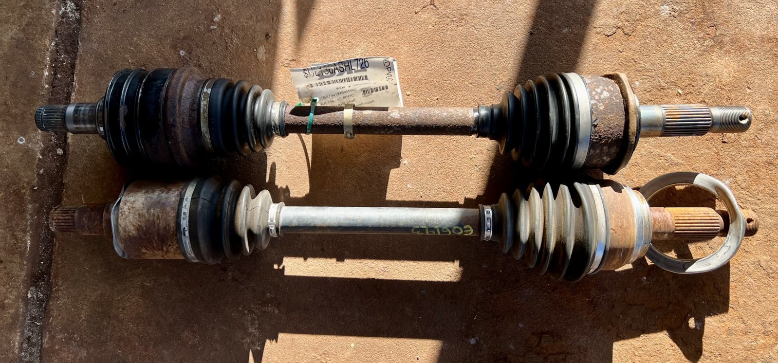

    Can anyone advise if either of these two rusty shits are OEM tundra axles? I don’t know why I bother with LKQ. Nothing is listed correctly and everything looks like it came from the bottom of the sea.

    Neither one is OEM. Look for axles from 3rd gen’s.

    That figures. It’s for a 3rd gen 4Runner with JD fab LT. Think it’s the same for 1st gen 3.5” LT tacos.
    Only read that only modified 1st gen OEM tundy axles work for it, but I don’t know poo diddly.

    The top one will work
    Bottom one wont
