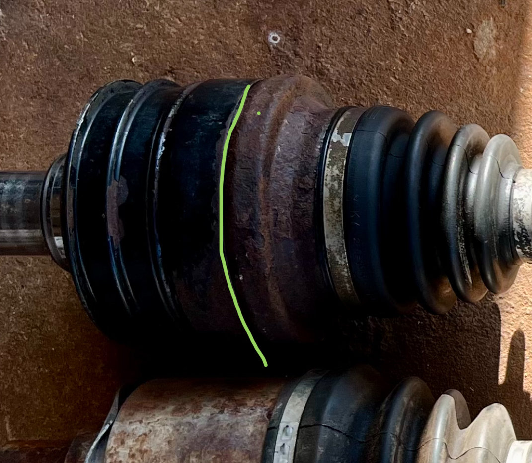

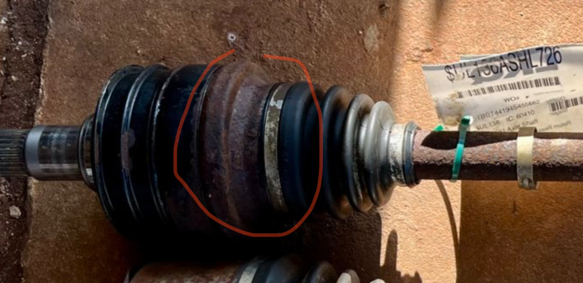

    More I study the top it looks similar enough to OEM if it’s not. Would the bottom work as a spare?

    Look for that lip
    Thats the lip you gotta cut
    most of the 00 and over didnt had that lip and the casing is different

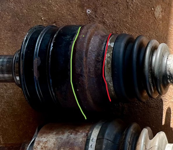

    Thanks for the help. For some reason I can’t find crap on this googling it. Is this where I cut?

    should be the red, just the part the boot clamps on once you remove the boot

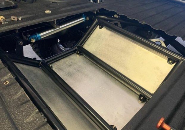

    im building my back half on coilovers right now. plan to be drivable in less than a month :fingerscrossed:.
    I tow a boat a few miles to the ramp almost every weekend for about 7-8 months of the year. i think it was actually someone in this thread that originally suggested this to me when i asked a similar question. i'm going to be using air shocks when i tow. i'll mount them in a way that i can just undo the axle side bolt, and swing them up into the frame when i'm not towing. these are the only two images i could find of a similar setup. first photo show the air shock mounted, second photo shows the air shock stowed.
    now of course these photos show a limited travel setup. i dont need two feet of travel when i'm towing a boat, so i'll likely only be using 10'' stroke shock. but if you're wanting to maintain your overall travel numbers, you're going to need a much longer air shock, or this may not be the right solution for you.
    looks like a bit of a pain in the ass for the guy in the stowed photo to access them. looks like he has to pull the spare tires, but i won't have a bed in the way, so it should only take a minute or two per side to switch between towing and not towing.
