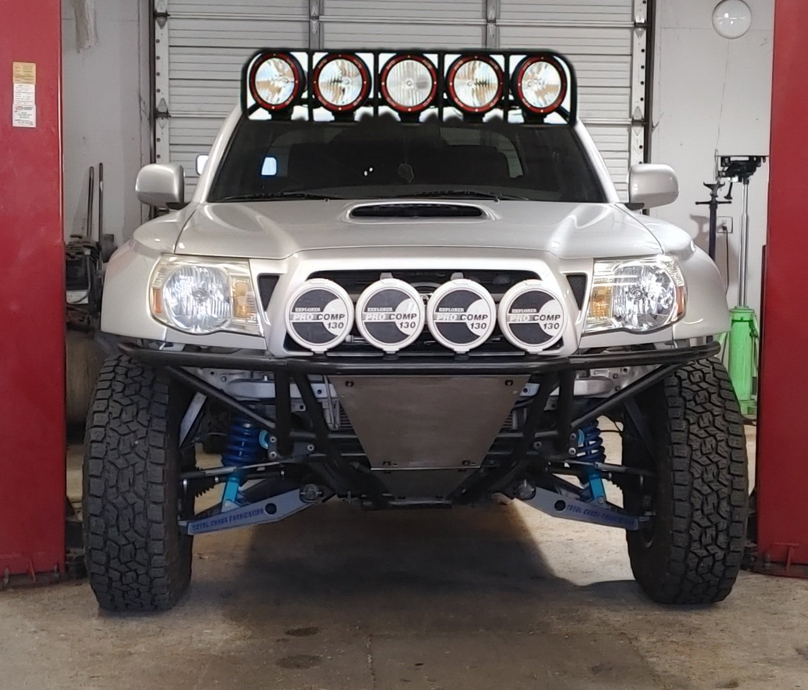

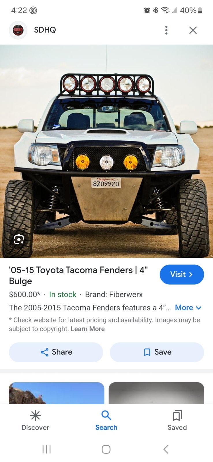

    Figure I would ask here since most you guys are welders.
    I'm wanting to do a roof cage for some lights and wondering the best material and diameter to use. I had a gravity pro 6 a few years ago and it was baller and easy to install but I just prefer the look of a light cage with some 7 inch HIDs instead of the leds.
    I would use the same style brackets that most light bars use in the drip rail and then run some support rods to the center of the cab to support the middle.
    Are these made of solid round bar or small diameter tubing?
    Looking for something exactly like this...
    Used my fancy new phone to impose that light bar on my truck as well.
    04TacoRunner likes this.

    When I had mine. I used 1" .120wall. 1.25 could be used where the lights mount to.

    Would likely be the easiest to find a fabricator that has 1in dies for the bending. Could go pretty thin like .095 or with a bit of structure even .065 or smaller OD tubing but it might be hard to find someone that will do quality bends with smaller/thinner tubing diameters
