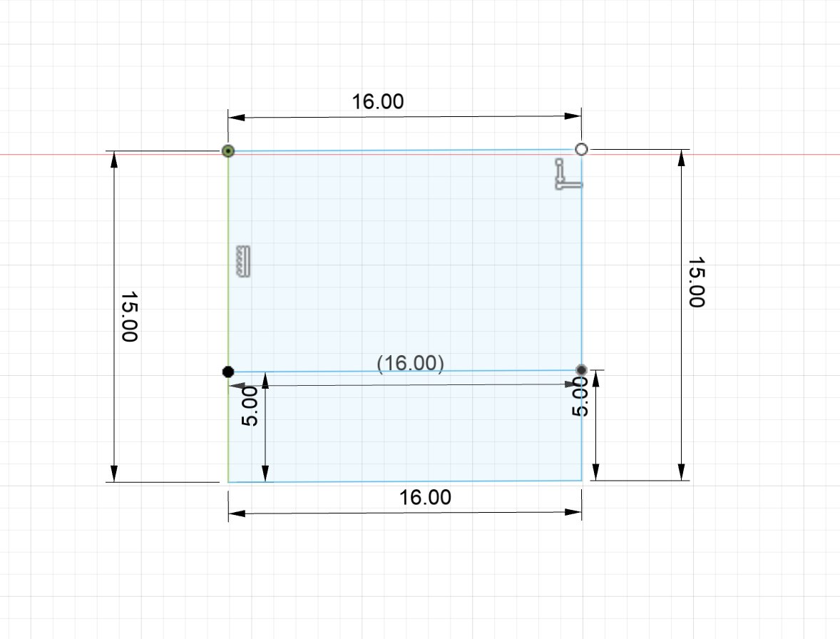

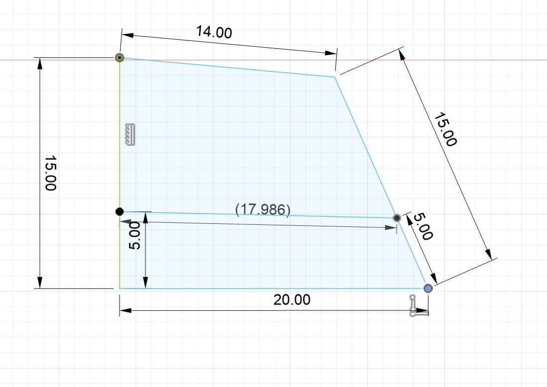

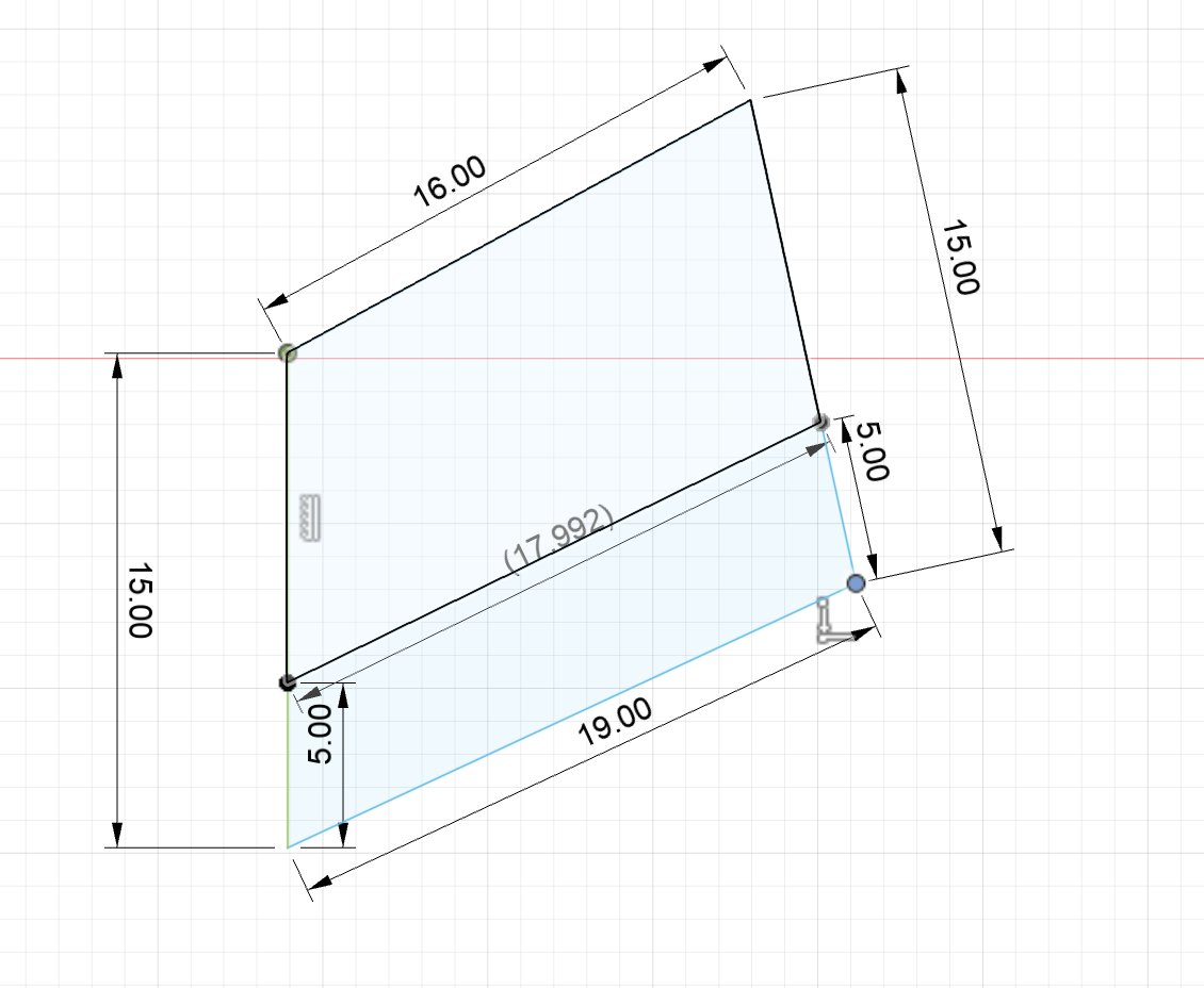

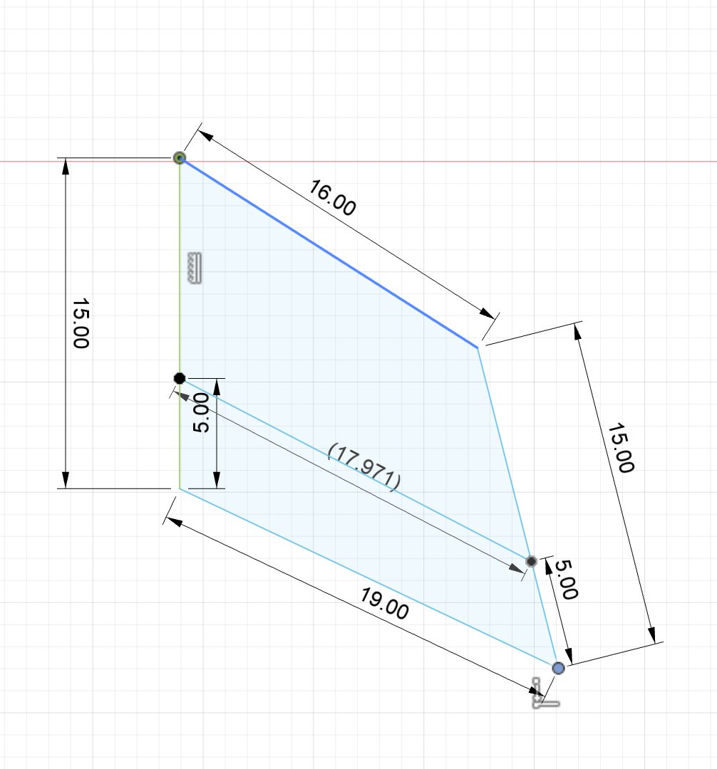

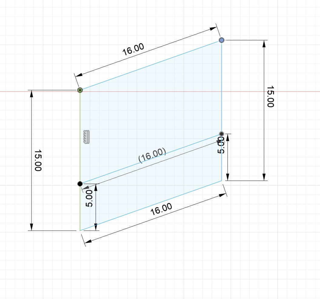

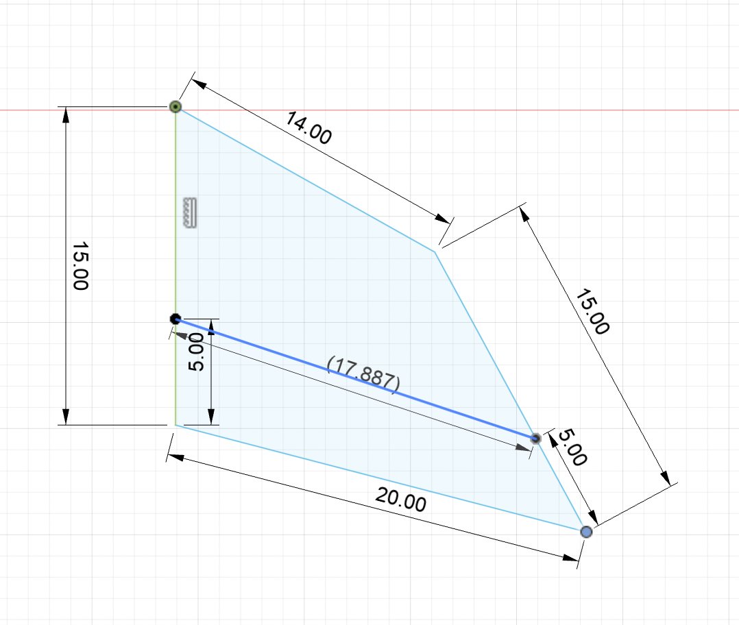

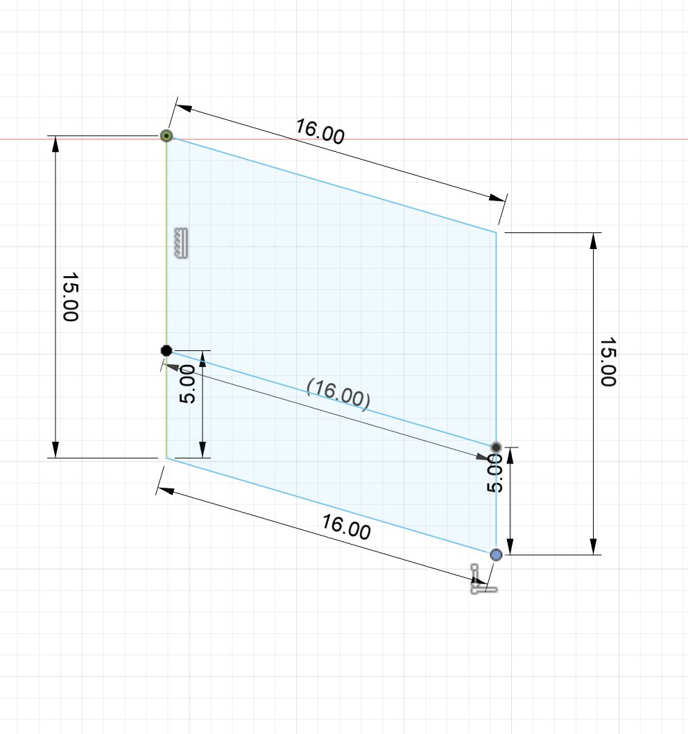

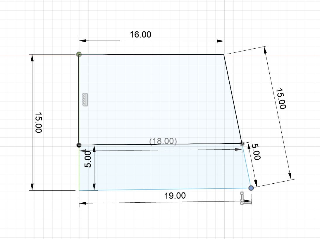

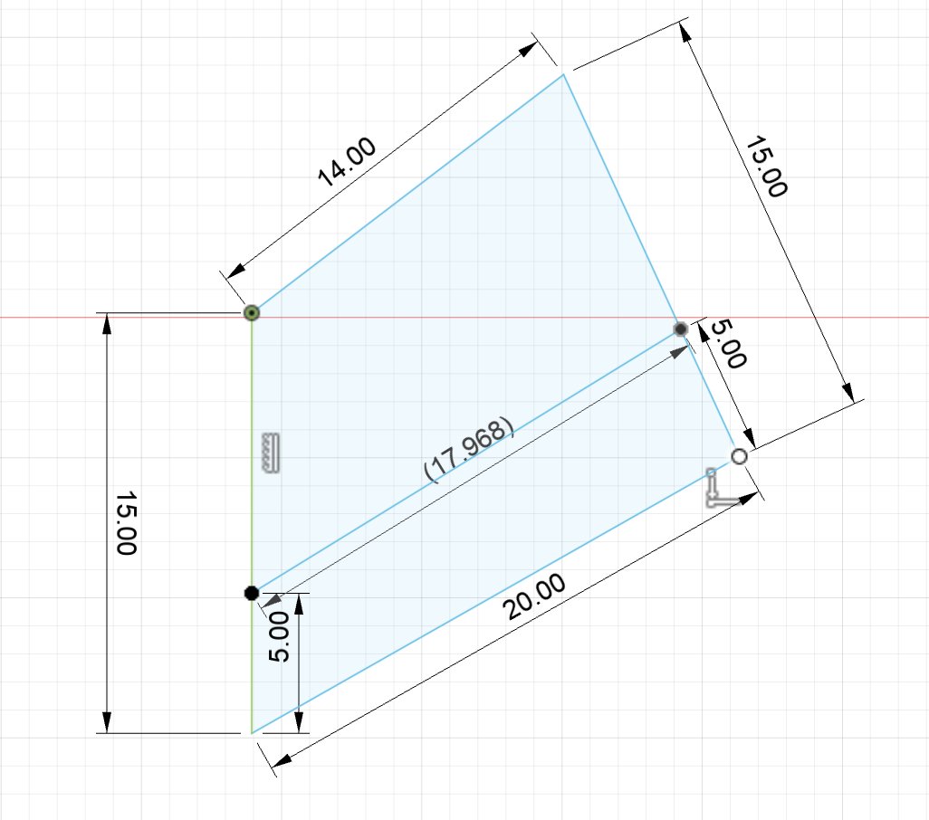

    Here @906taco I did it for you. The numbers in brackets are driven numbers, meaning they change according to the other constraints. As I said you can get super close, like close enough that bump steer is practically zero, but not absolutely zero.
    This is with the frame side spacing and the spindle side spacing the same. Start changing these numbers and it gets worse. obviously the biggest difference maker is moving one side of the tie rod up or down relative to the other side. That will change the bump steer drastically.
    These numbers are super small, but will be amplified when measured out by the edge of the tire or wherever you want to measure from

    I remember someone building these things that a little bump steer isn’t even bad - like an 1/8” it may have been @Basikbiker

    I should say though @906taco im not calling you out. I think your swing set is very impressive and I appreciate the time you put into dialling it in and making it awesome. I'm just saying "minimal" could be 1/8", which would not be noticeable in the dirt, or it could be half a tenth of an inch, or it could be half an inch. Regardless, "absolute" zero is impossible haha

    Well, when we’re talking .0** of an inch I feel as though that’s “0” considering most high end laser racks won’t even pick it up. Just saying, but this was all measured via laser. Computers aren’t always right. Sometimes you actually gotta do the thing.

    At the end of the day could it have .020” of toe change somewhere in the travel? Yes. It very well could. But if we’re going to sit here and call that bump steer then I’m really not going to get into the topic a whole lot lol.
    Considering I had a product on my front end that produced OVER 3”, I’m gonna stand my ground and continue to say the swing set has 0 as it could not be picked up through numerous rounds of measuring.
    I can quite literally set my toe at full bump or full droop and it will be perfect at ride height. And I know this, because well. I actually did this exact thing.
    Also, under further review. You’re forgetting the equation of caster change through the range of motion. Which is partially why you see me recording spindle angle on my original paper.

    oh yeah I'd call it zero too. I'm just curious what "minimal" bump steer is according to the other guy you were talking about
