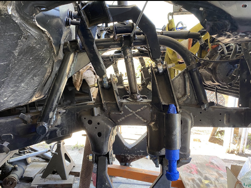

    1/8 with 14-15” of travel isn’t going to translate it anything on road that's concerning - I think irrc 1/4 is acceptable for desert and this conversation about bumpsteer feels like deja vu...
    …not that there’s any reason to not try to remove any if you’re building a kit or moving things around.
    Be happy you don't have rear steer - no 4wd swingsteer for 1st gens for that reason.

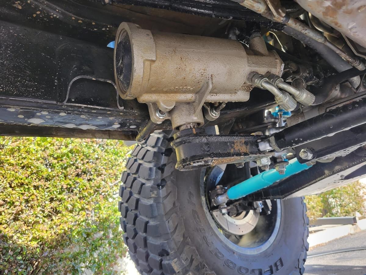

    its been done for first gens just no commercial kits, I would argue the oem rack is just good enough there isn’t a huge need for someone to make a kit.
    There is another guy I know of working on a swingset type steering with a box controlling a DE ram right now too.

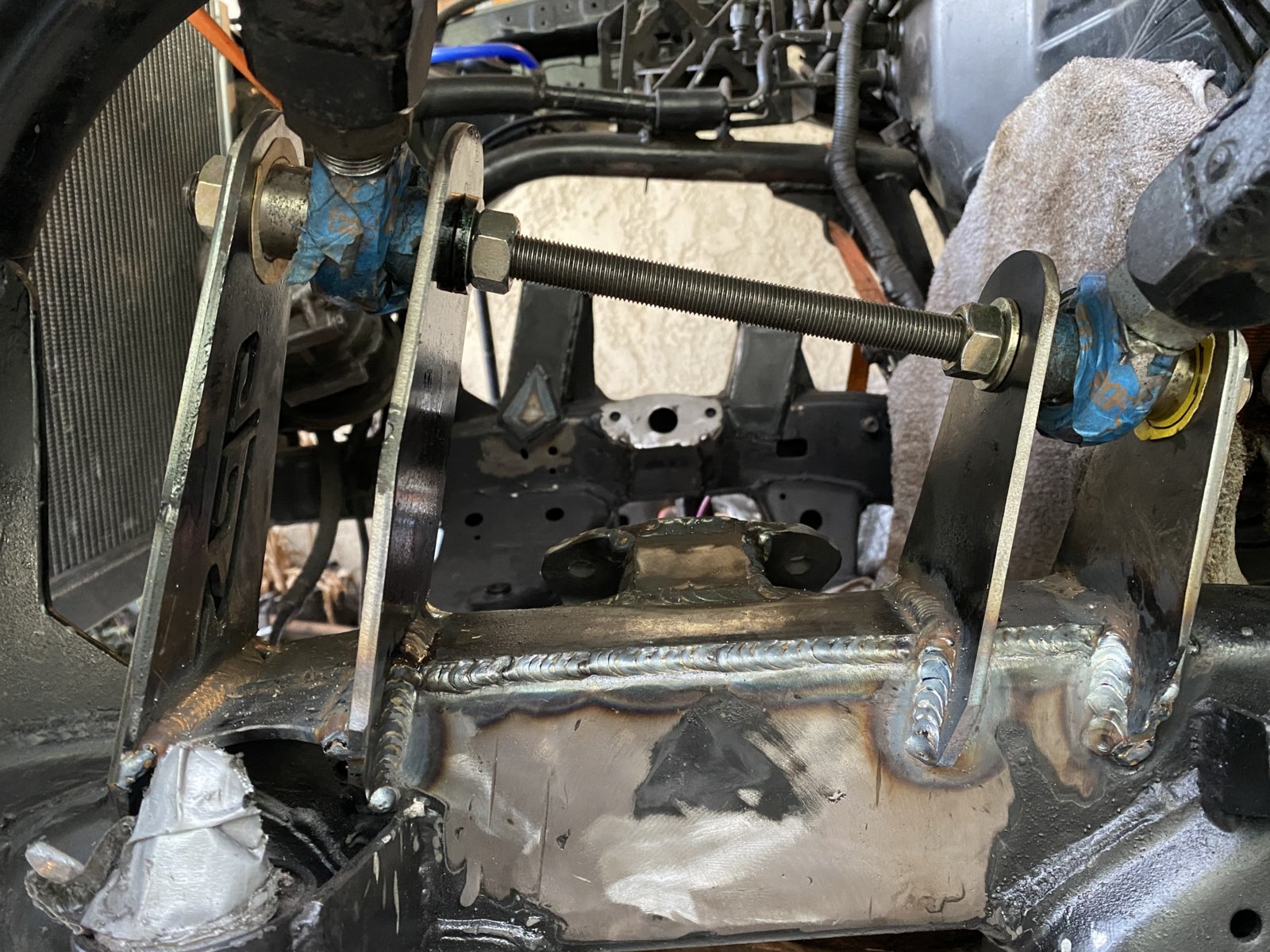

    Getting into some nitty gritty stuff for really getting my J-arm kit to be top notch in the geometry department.
    Coming to the realization that almost all race trucks run some form of antidive in their systems. And really, it makes a lot of sense. But what I want to know, is why do people seek to eliminate it? Is it because someone made a kit to eliminate it, claiming it’s bad? Or something else?
    Running some anti dive does allow for truly zero bump steer as the outer tie rod pivot allows for some angle change through travel along with many other benefits.
    I’m just confused where everybody gets the “anti dive sucks” mentality?

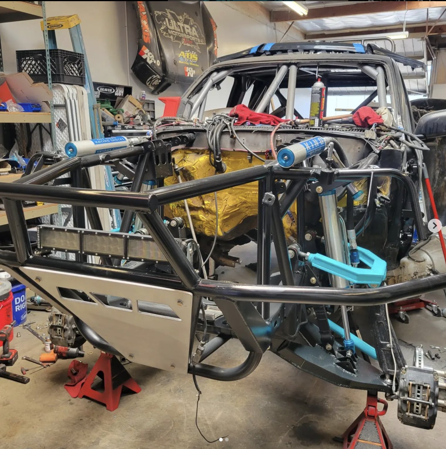

    Where’s the front diff and cv’s… :worthless: lol I’ve seen a lot of swing steer on dr of prerunners / 2wd tundras but no 4wd. Am I completely wrong and there’s a diff?
    When I was redoing the mounts for my upper arms I had seen my friend's race kit
    and another 1G prerunner that had been the best performing leaf sprung 1G tacoma I had ever seen years ago (it's now V8 linked), which he had built from stock all himself.
    I asked the second guy about how important removing my anti-dive was. He didn't really say it was a game changer as far as performance in his opinion, but he did say that the truck feels way different and it takes getting used to. Part of it is the simplicity of making upper mounts imo. This was enough to convince me to just make the gussets I had as a jig for my mounts.
    Shock tuning could be a consideration. The video should start at 21:10 where he goes into his decision to put dive into the front. Pretty informative clip.

    yea I missed that 4wd part… It is the same truck in your second pic haha.
    that guy with the tacoma buggy with a tundra front diff is working on it right now though, be interesting to see if he can make it fit or if he does full hydro.
    I think 2wd or 4wd the space back there is about the same, only bummer is if you are crawling that box is pretty low especially in the pic I posted.
