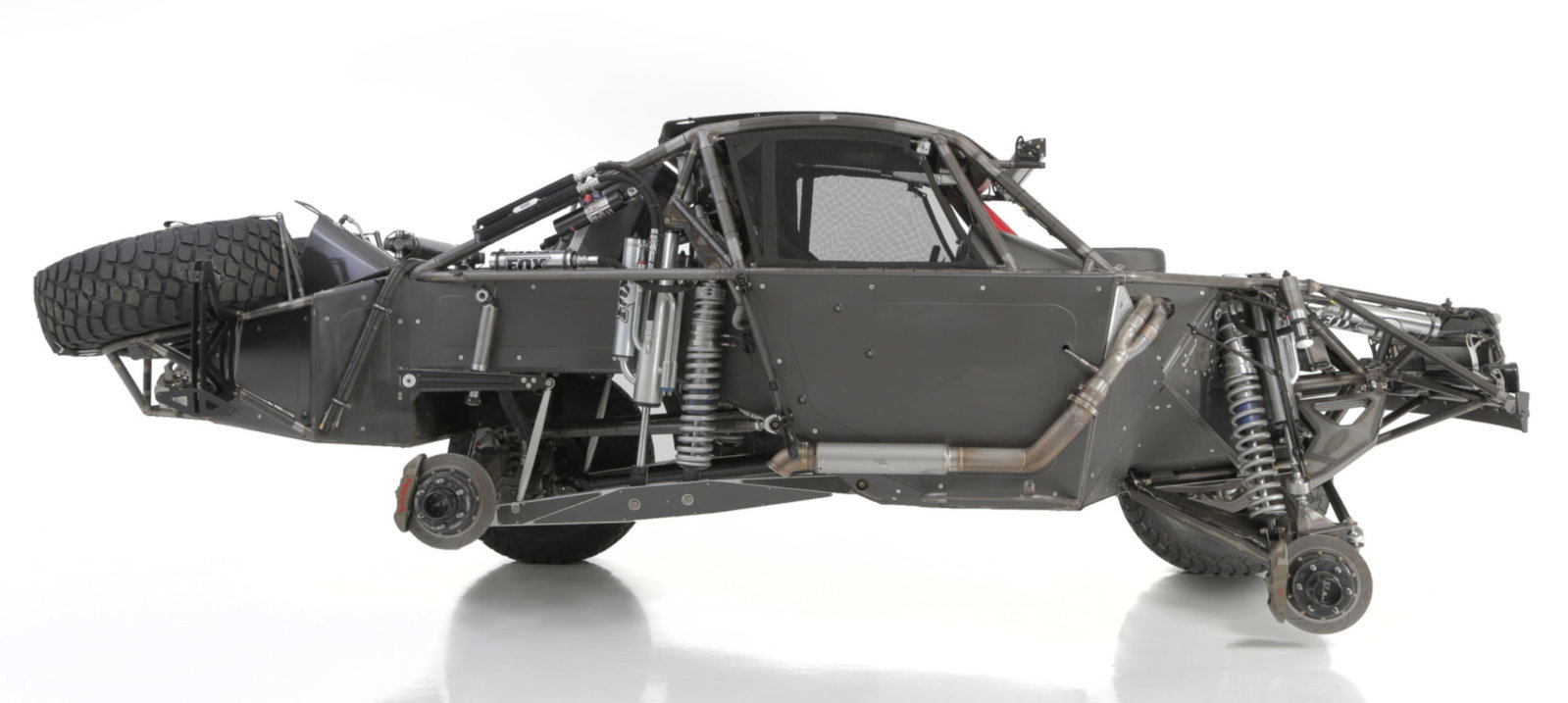

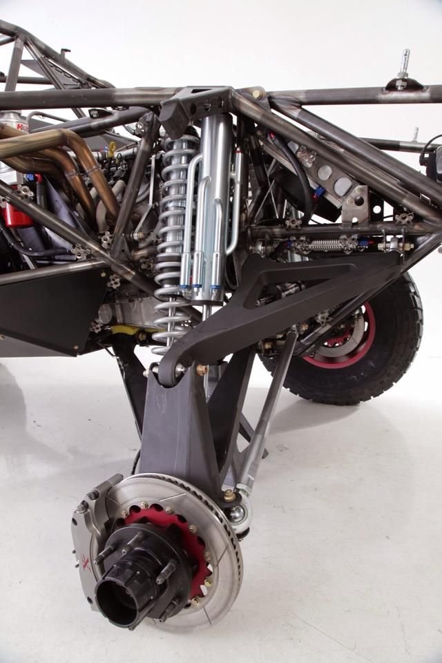

    So to get to the answer of why people shit on taking a mechanical approach to antidive. It's just that it's not as great of an option for controlling it as it seems anymore now that it's not really the only one as hydraulic approaches are getting better like bump stops and bypass bump zones. It works and has some adjustability but adds a now unnecessary sacrificial part. I don't think it's that big a deal either but i can absolutely see while people want to chase as 'clean' of travel as possible and i see that being sought out more in the future as suspension design develops.
    As for the trophy trucks. TBH they're on some hillbilly shit compared to most other high level motorsports with a lot of things like materials, aerodynamics, and in some ways even suspension. BUT there's a couple things they do really well like safety and using a blend of mechanical and hydraulic systems with their suspension. This is just speculation from here but the idea to start using big shocks is credit to the guy behind Fox and pushed later by the guy behind Custer. iirc both were successful engineers so i like to think those moves were planned ahead. Like they knew they were gonna need shocks at least somewhat, so may as well try some steps forward with em even though the development of hydraulic systems was even more far out in their times. But i don't think the modern suspension blend they use was as planned ahead. To me that seems like it's more of a product of chasing reliability. Which is what the trophy truck guys do best by far, and i think is how they've come to the conclusion to use mechanical antidive but only a small amount. It's probably a very slowly developed approach with trying different angles, uniball sizes, shock tuning, and is what they've come to for the best trade-off of performance and reliability for one race at a time. Again just speculation from me but i think it's a safe guessplanation

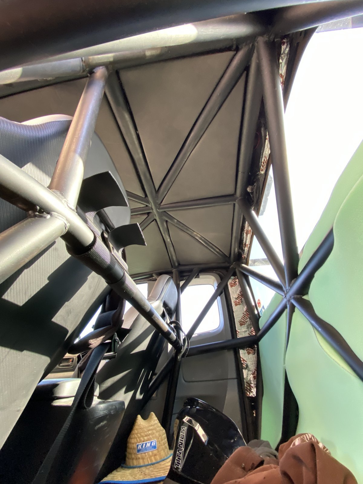

    Has anyone successfully made a internal roll cage that isn't loud? Filling it with foam or wrapping it? Is it possible?
  6. Jun 4, 2024 at 5:44 AM
    906taco
    906taco Well-Known Member
    Jun 22, 2021
    #369289
    3,971
    Cory
    08 Taco
    It’s not happening. And if you fill with foam you’re absolutely effed if you ever need to add something or do repairs.
    Cages add lots of noise. All there is to it.

    I cut my noise level in half by adding 2 inch foam covered in fabric on top of 2 layers of kilmat. But the clicking noises of the rear bypasses though a bit quieter now still never quit clicking. Just gotta get used to it. You can see in the pic some of the rear wall foam before I covered it. IMG_3433.jpg
