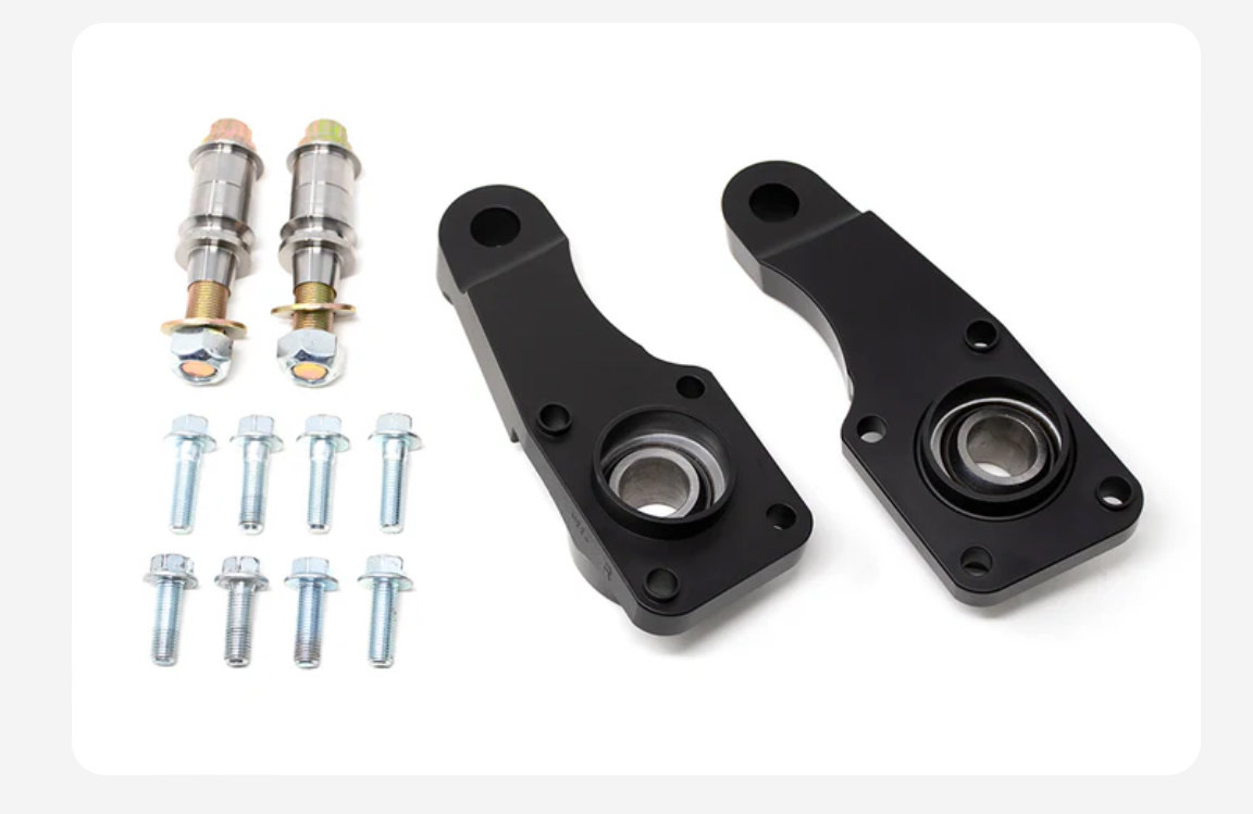

    Clay

    JKU Rubicon
    https://www.tacomaworld.com/threads/daymans-karate-class-but-you-wont-learn-nothin-4-link-lt-and-previous-iterations.755134/
    very interesting. May hold off on the unis until I see if it’s a big issue for me. Will do the bolt upgrade though. That seems like a good move regardless.

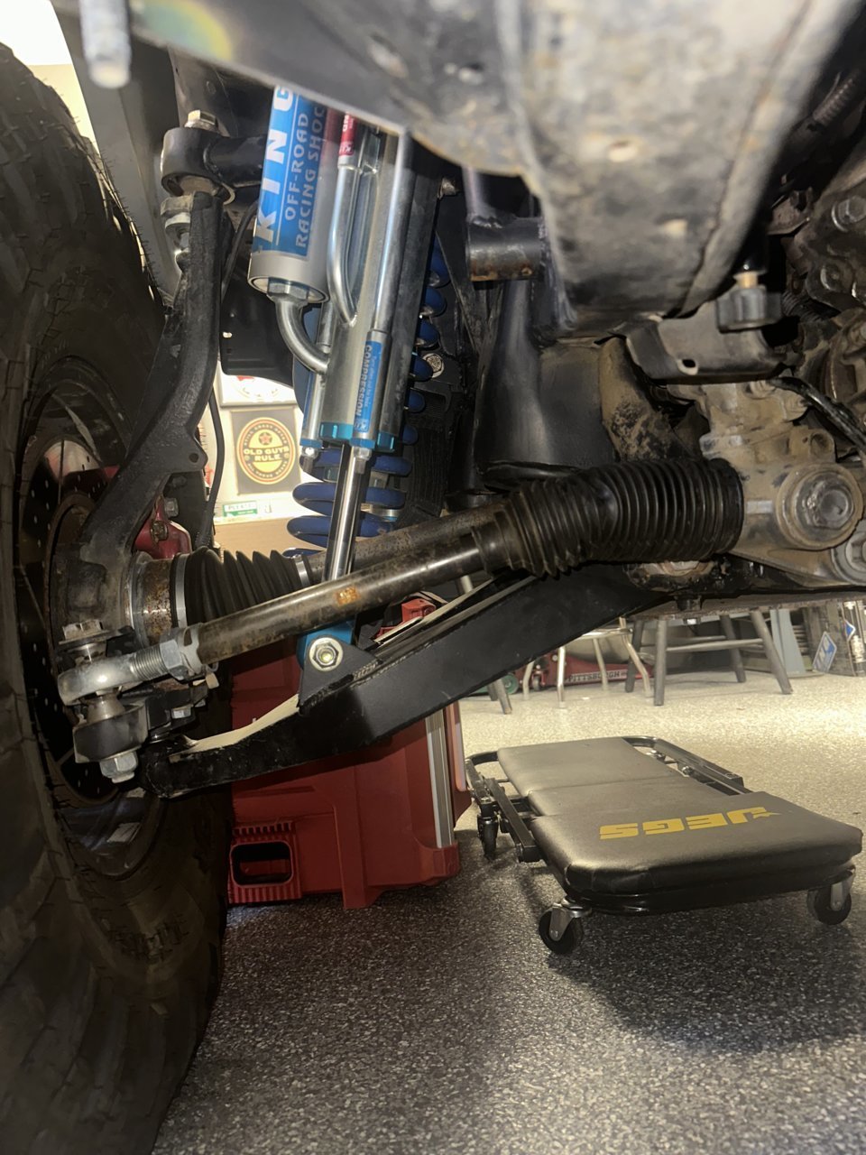

    Love it, especially w/ LT. I beat the hell out of this kit so far and steering is one thing I'm not worried about. Paired it with Dirt King Inner clevis kit and some kartek tie rods and this is a stout setup.
    Once I finally have my racksaver installed its going to be about as bullet proof as 1st gen steering will ever get

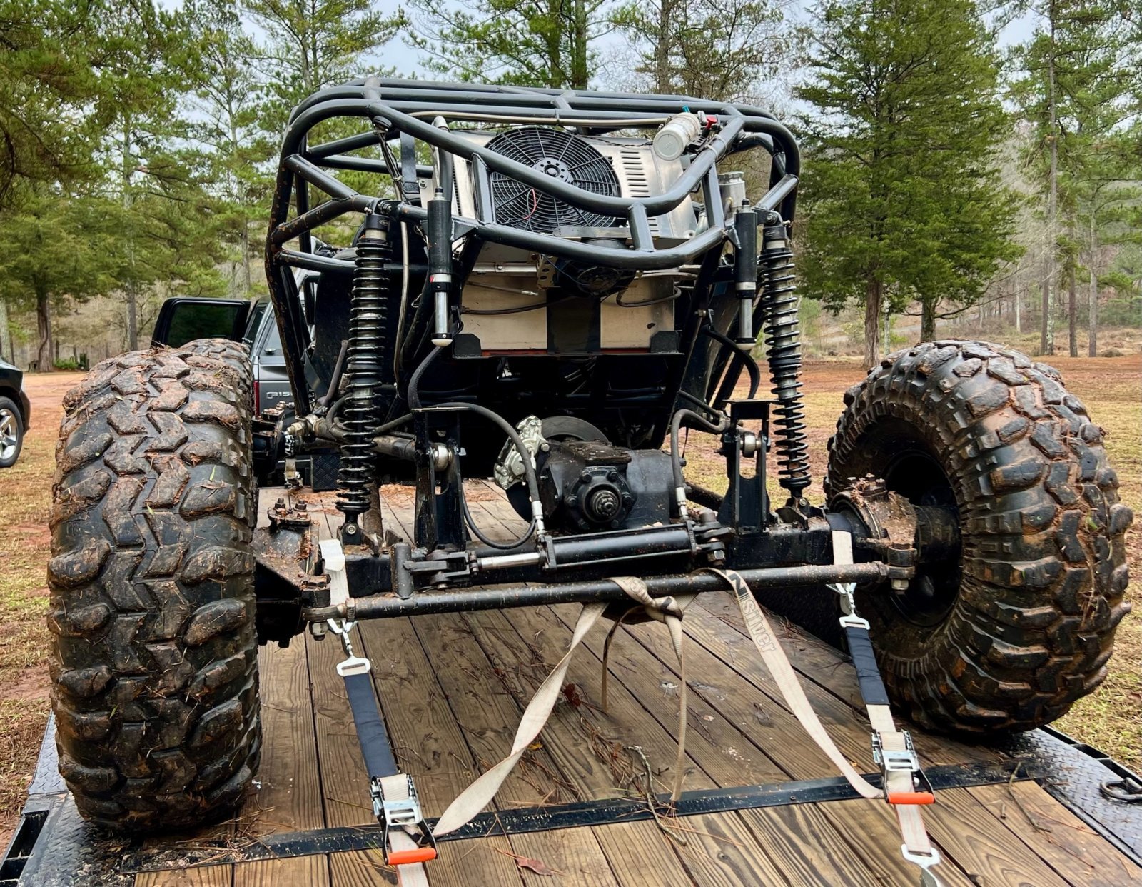

    Took me a while to figure out what you meant by rear steer since I just had a rear steer bouncer, but I got it haha i vaguely remember seeing a swingset on one of these forums, but i think it hung down a bit low.
    It’s a tough call for what we do down here. If you need full hydro you’re probably on 37+ and don’t need ifs any more. That’s the line I’d like to not cross again, although doing a SAS with yota axles and a streetable 3-link is more appealing than going overboard with tons again. Kinda a “as it should have come from the factory, but better” build lol.
