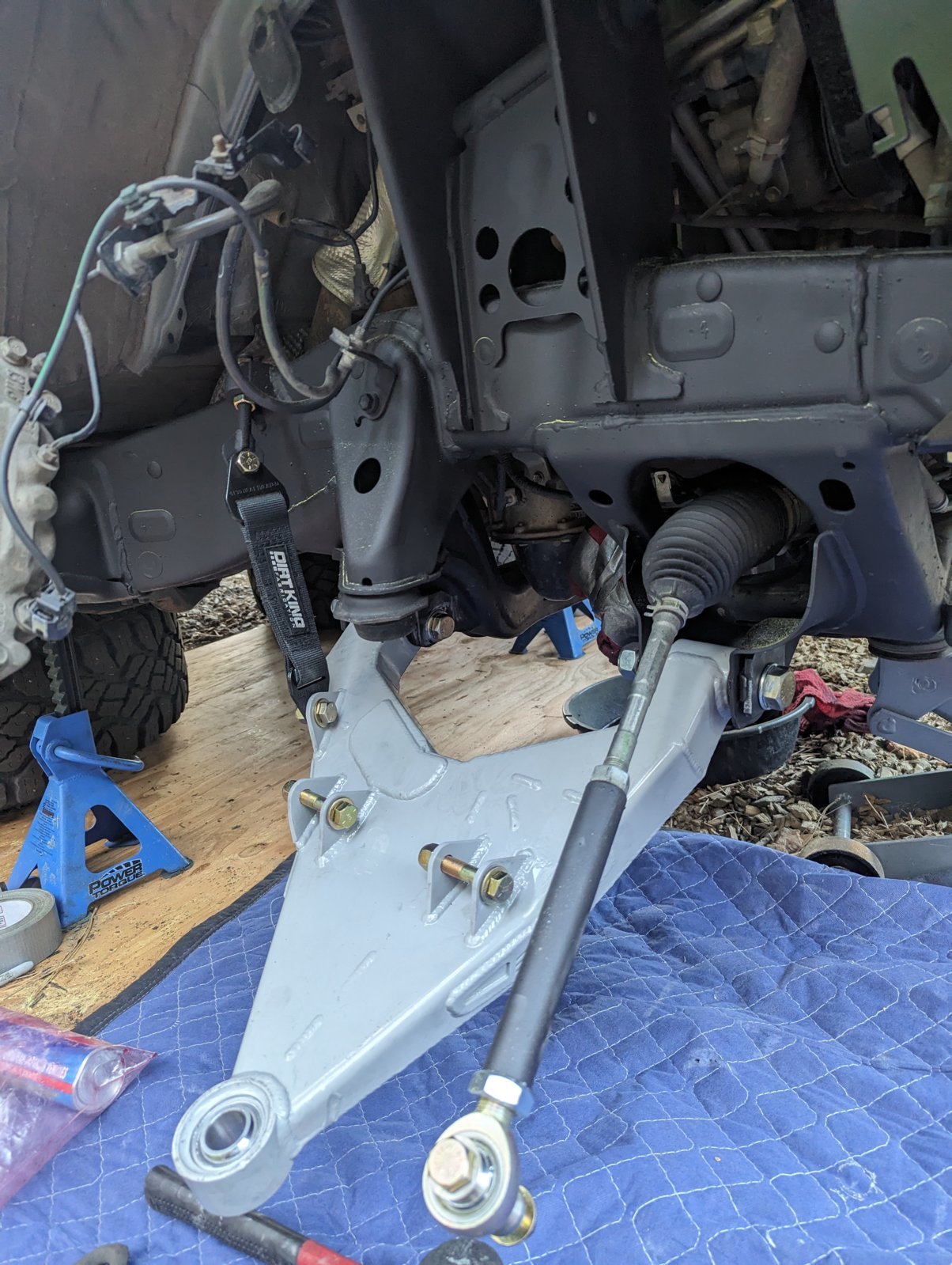

    I know it ain't much, but it's the best feeling when everything starts coming together.

    Gonna bend/snap that limit strap adjustable clevis real quick at that angle. Everything needs to pull as straight as possible. There’s a lot of force that goes through that system.

    Thanks for the info! That's how wicked Creations reccomended it to be welded. Oh well...
    It's gonna snap off for sure lol

    Send an update after your first day taking it through whoops.

    Get a magnetic angle finder (cheap ones are like $25-$30) and put your suspension at approximate ride height before installing the coilovers and you can see your camber and maybe caster if you have a good vertical bolt to put it on. It looks like you have the cam tabs in there so start with (probably) rear out and front center.
    Camber can be taken off the side of your brake rotor after zeroing it out on the side of the frame. It should be way more than -3.5* like within .5* of zero plus or minus.
