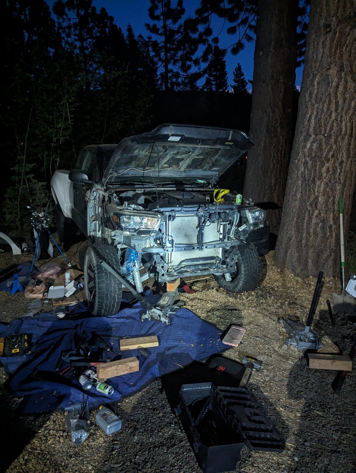

    I’ve gotten better with time management and rip the thing apart as soon as the first salt hits the road. Goal is always no later than June 1st lol.

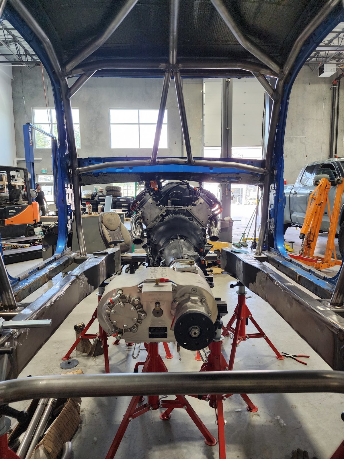

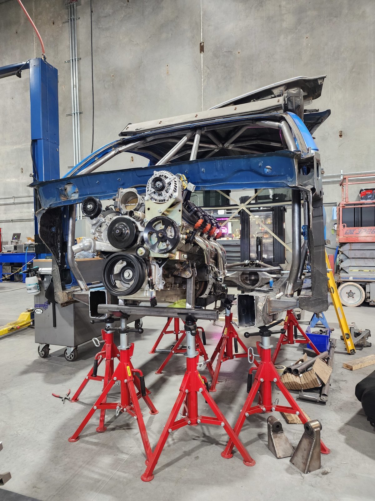

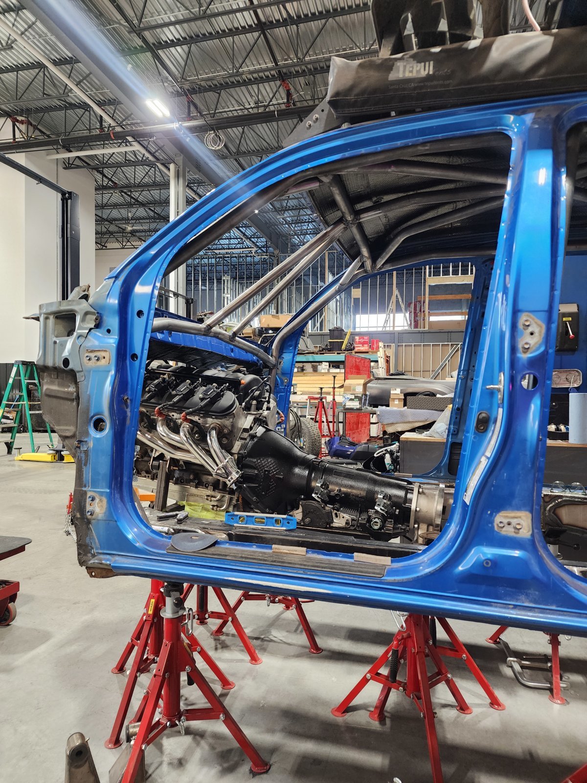

    +8 arms, but center mounted so only 3.5-4" wider track width per side
    If I was building a pure desert truck it would be 2wd, but I spend more time in 4wd crawling big rocks than I do whooping cuz I live in BC, so this truck has to be able to do it all, while understanding that it will be compromised for both crawling and going fast. It's more of a full body ultra4 build than a prerunner. That's why I'm running short trailing arms as well.
    I was considering dana60 locking hubs, but heard they can be weak, so I might just end up with the full spidertrax front end.
    I wanted to go with 4.0 shocks, but I think I'll end up with 2.5/3.5 all around. I don't think my shorter trailing arms have enough space for 3.0/4.0 so it would have to be 2.5/4.0 if I went that way
    I don't know what it is as I know they are simpler, cheaper, stronger, but I just am not a fan of beams. I want to make a-arms or j-arm work. I think it's more interesting

    Should be rad when it's done, 9" pumpkin up front? 934s so you can run a 35 spline shaft?
    So the newer dana 60( 2005+) I run the fancier warn locking hubs on my crawler and I am NOT nice to it (knock on wood) haven't blown a hub apart yet and I've had it bound up pretty good where it walks the steering u joint cups out at the knuckle(I weld the caps in now) and that's a hefty 1550 joint lol.
    I w a s hoping the hub guts would be the first things to give since they're the easiest to change.
    Just food for thought don't sleep on the 60 stuff
    (And yes im referring to my solid axle crawler) but the outer parts are the same.
