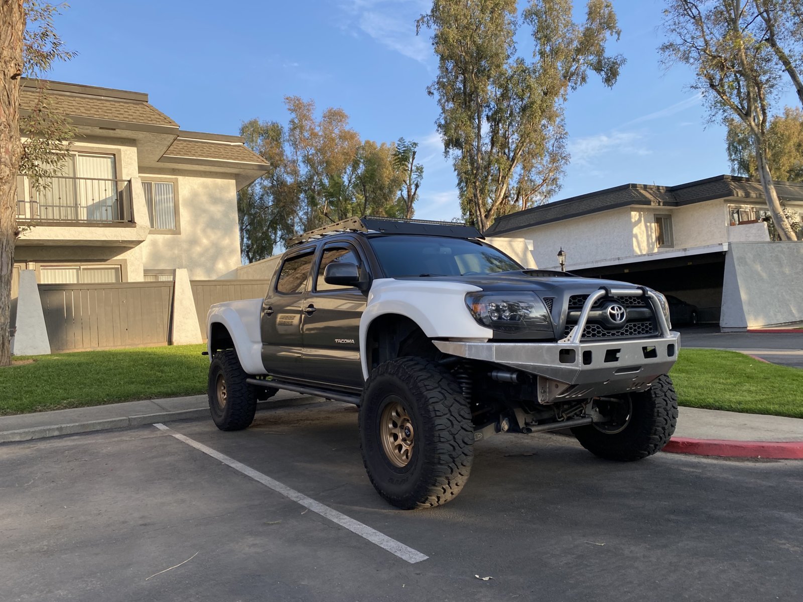

    It’s not overtly tall, if I could I’d take it down probably .5-1” max. It’s honestly just looks reasons, feel like I got a bunch of fender gap. But ideally still need the bump travel. So double edge sword there. I’m also no extra weight other than sliders. With the aluminum bumper and removal of material from the front, It’s probably lighter than a stock front end. Here is current on 35s.
