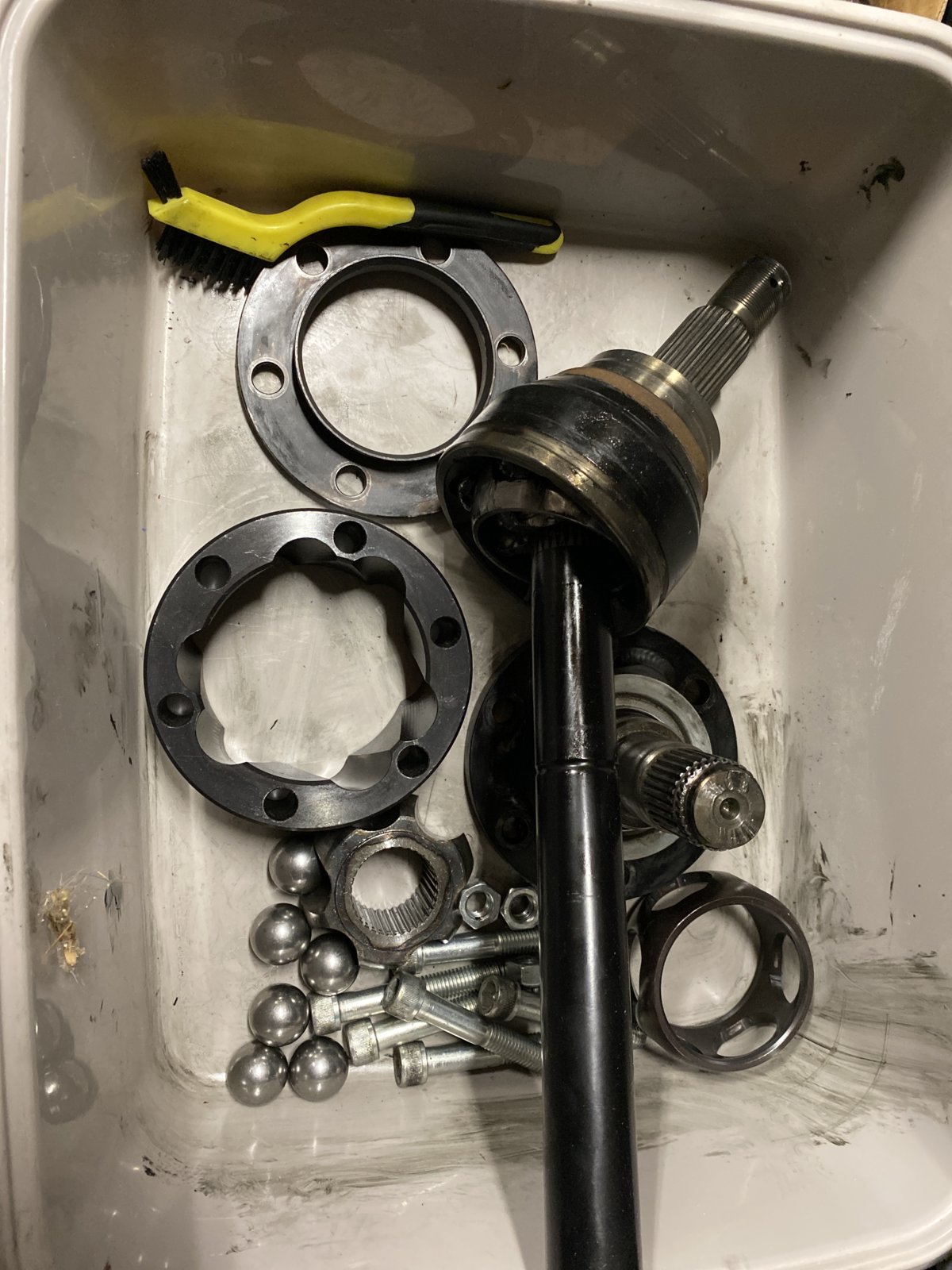

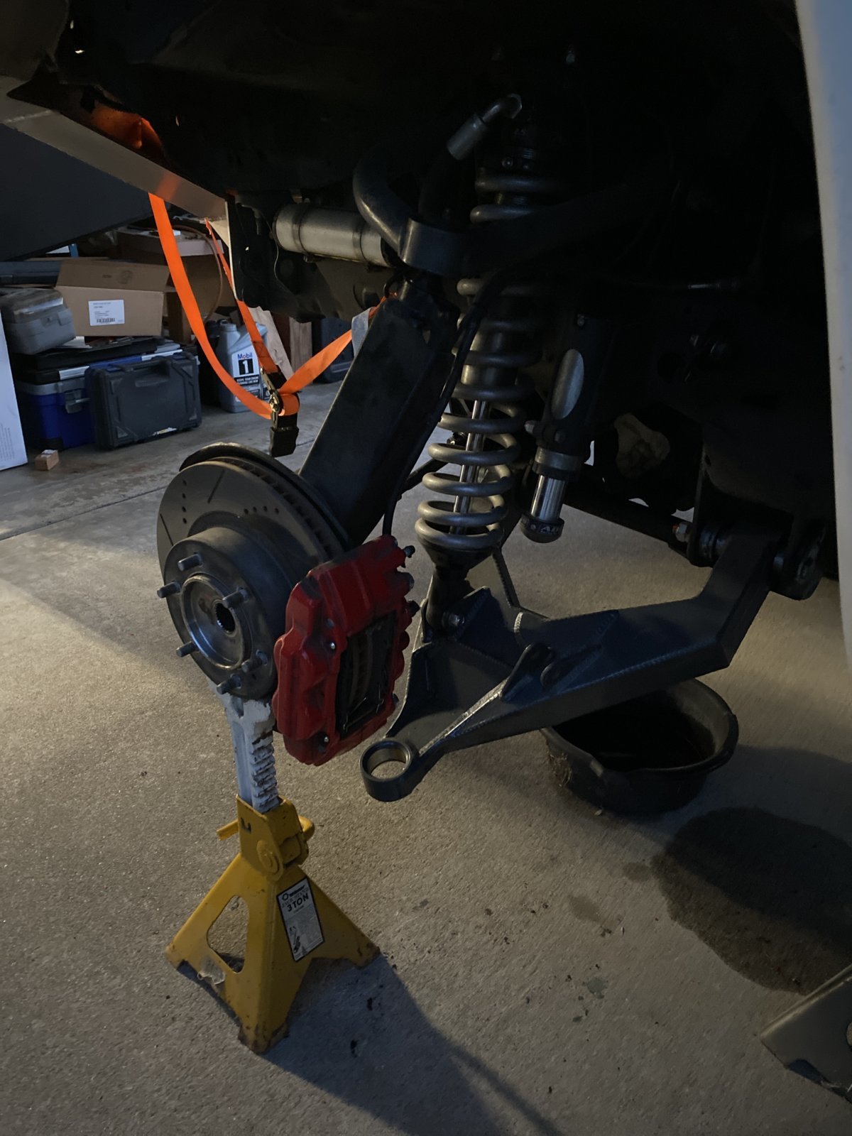

    Welp. Week 3 of this garage wrenching bullshit and still no uniballs in cups. I’ve been on this forum for such a long time learning the how, but trying to do this is a joke with the tools I have. Guess I should have put money into tools instead of the truck. Oh well. Going to harbor freight tomorrow to try out the budget ball joint press. Will update once I get them in. Looking forward to putting the 934 back together. Love how easy the inner is to service. Outer is still tight so should be good to re-boot and move on.

    Straight up Mineral Spirits works best at breaking down and removing old CV Grease. An old trick that we use when prepping CV's for the Buggies , Class10 and Class 1 Cars. I'd use a solvent style brush and Mineral Spirits to clean out the old stuff from the Outers without separating the Shaft.

    Been meaning to get some of that to take some paint off an AR rail I rattle canned. For the 934s, I just wiped everything down. It’s gonna get greased up again. Don’t mind a little residue as long as all the particulates are gone.

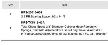

    His kings are standard TC spec if I’m not mistaken - like everyone’s input just thought I’d mention what they look like.

    Yes you're correct. Only thing that's different is the eyelet was swapped to a 1.5" instead of the TC 1.25".

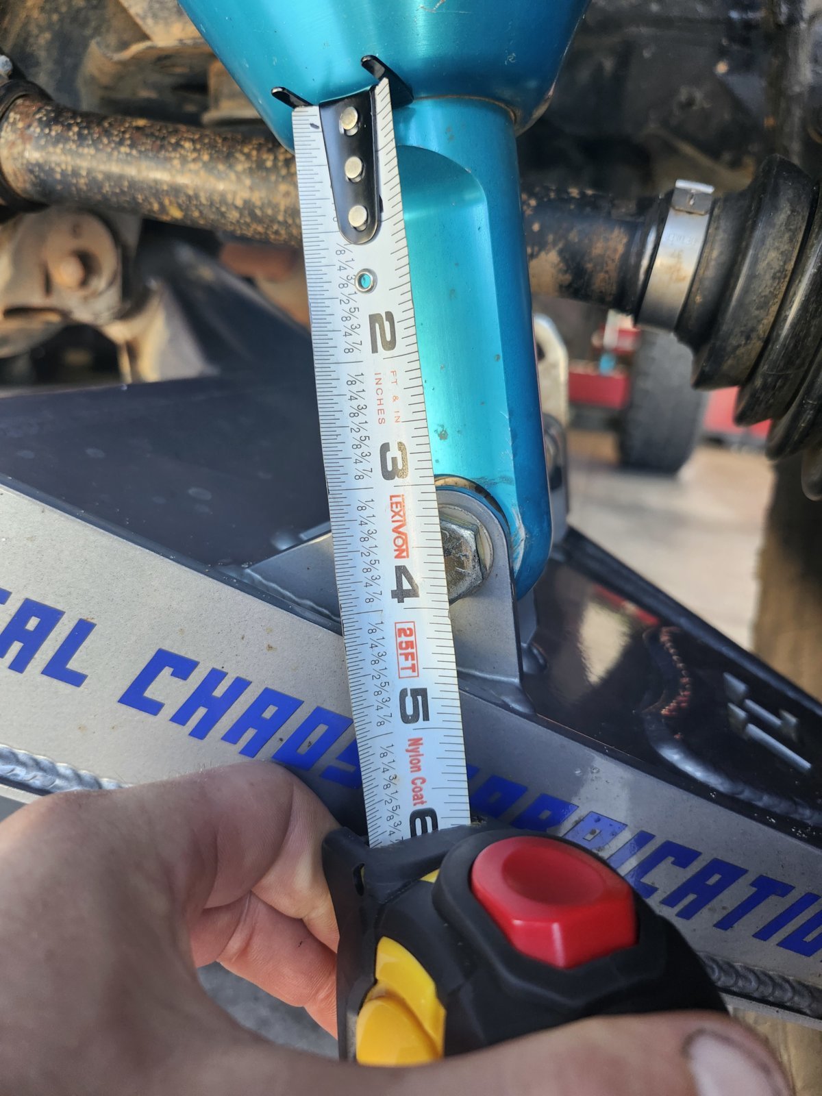

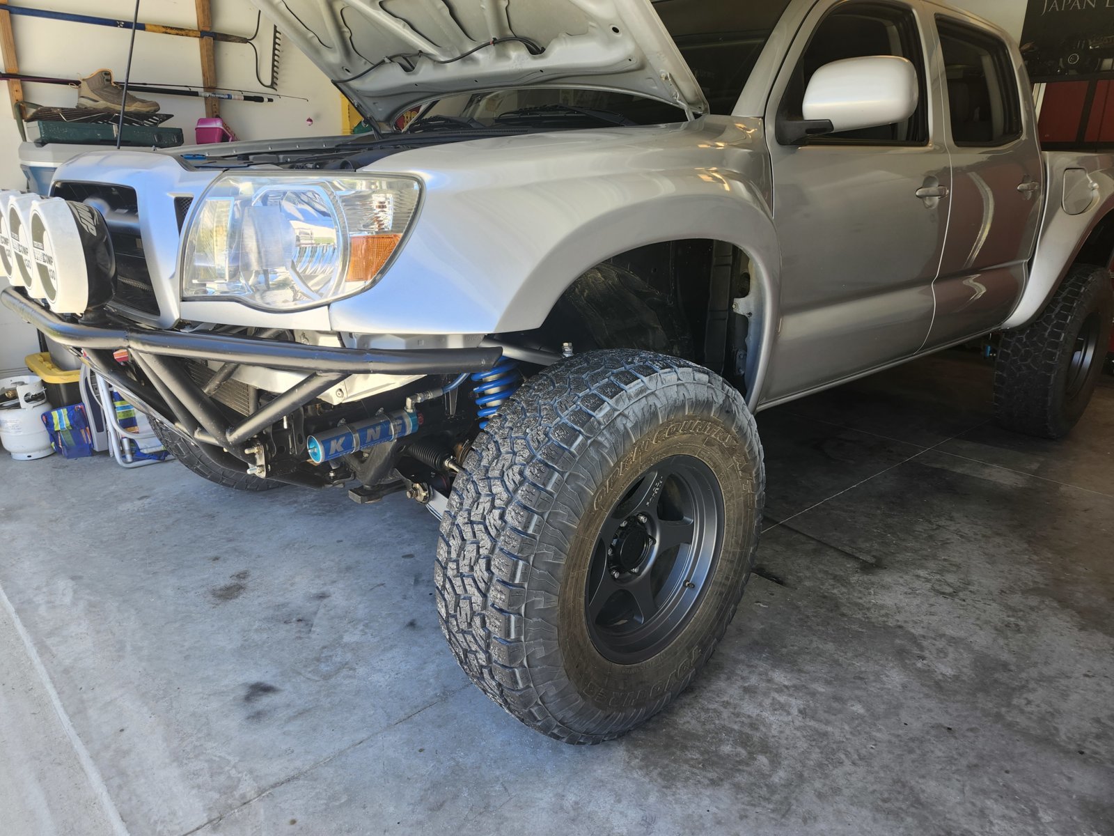

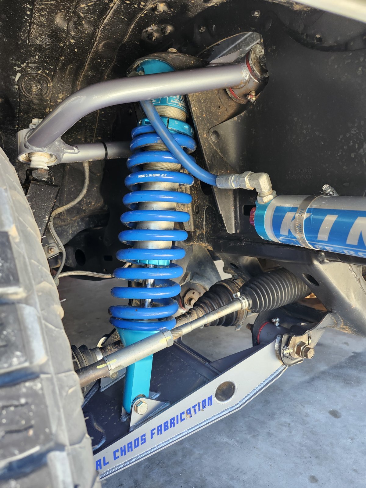

    1 inch of preload on 16x600s20240608_140128.jpg 20240608_140510.jpg 20240608_140520.jpg
