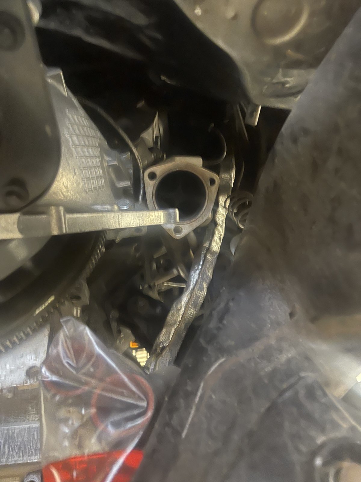

    Mad.
    I also am a little curious/upset, wondering if I could’ve fit long tubes. My guess is not, but I bought shorties anticipating nothing fitting at all. Equal length Long tubes would make it sound so so much better.

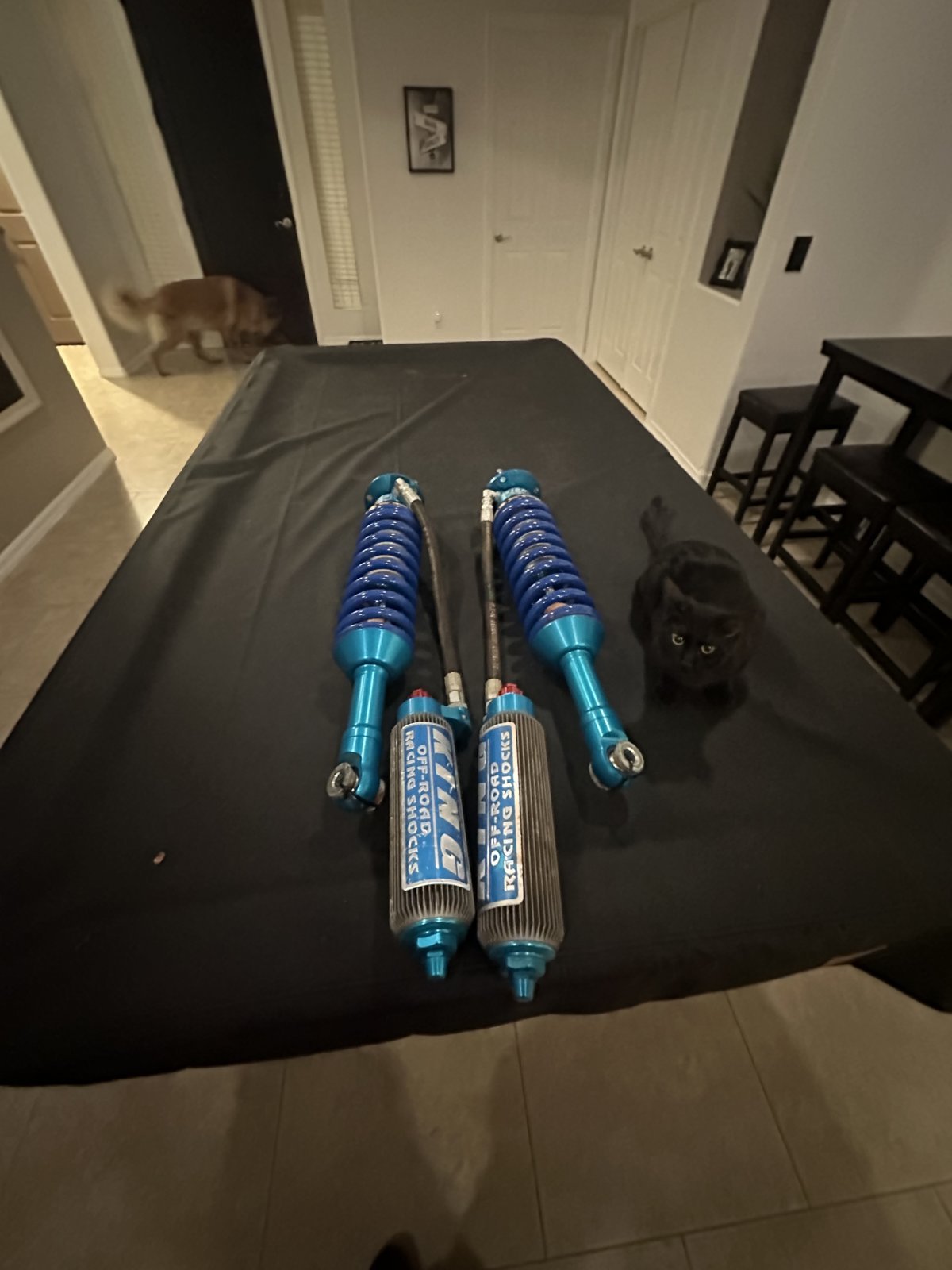

    IMG_0942.jpgSnagged this set of King IBP 3.0 with finned resi’s and adjusters for 2k. Raptor is finally dialed.

    The main clearance issues are the steering shaft and the front driveshaft.
    Driveshaft is gunna be a problem for me, I might need to get some different headers that meet in the middle of the 4 and go straight down, or run the shorties to the front of the block and then loop down and back
