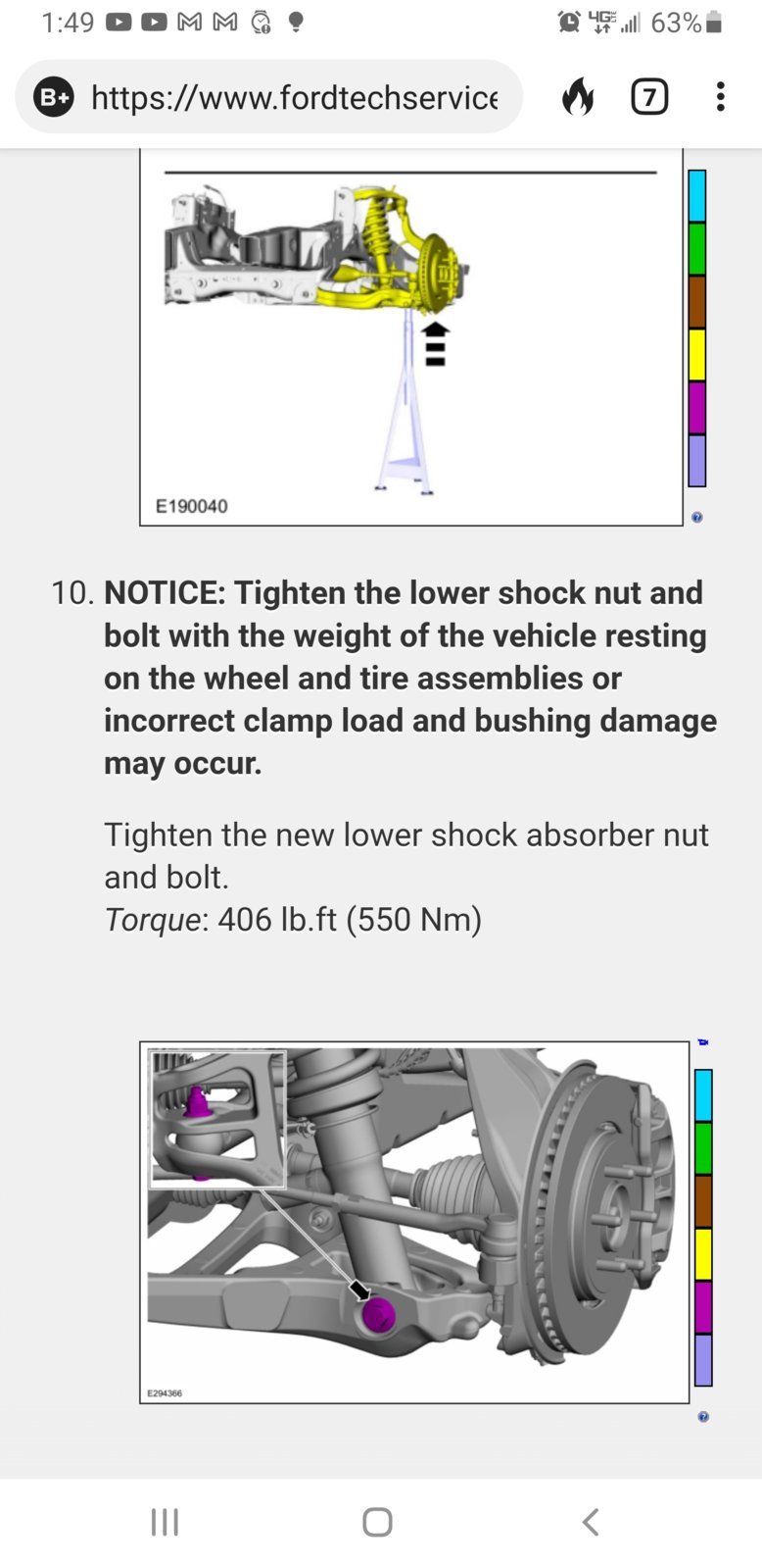

    From the Work Shop Manual...using a model year 2019

    So just pin the needle on the air compressor and let'r rip?

    Theres a few instances here and there in the Work Sop Manual where a Snap-On Part Number will be referenced as a required Special Tool .. so yeah

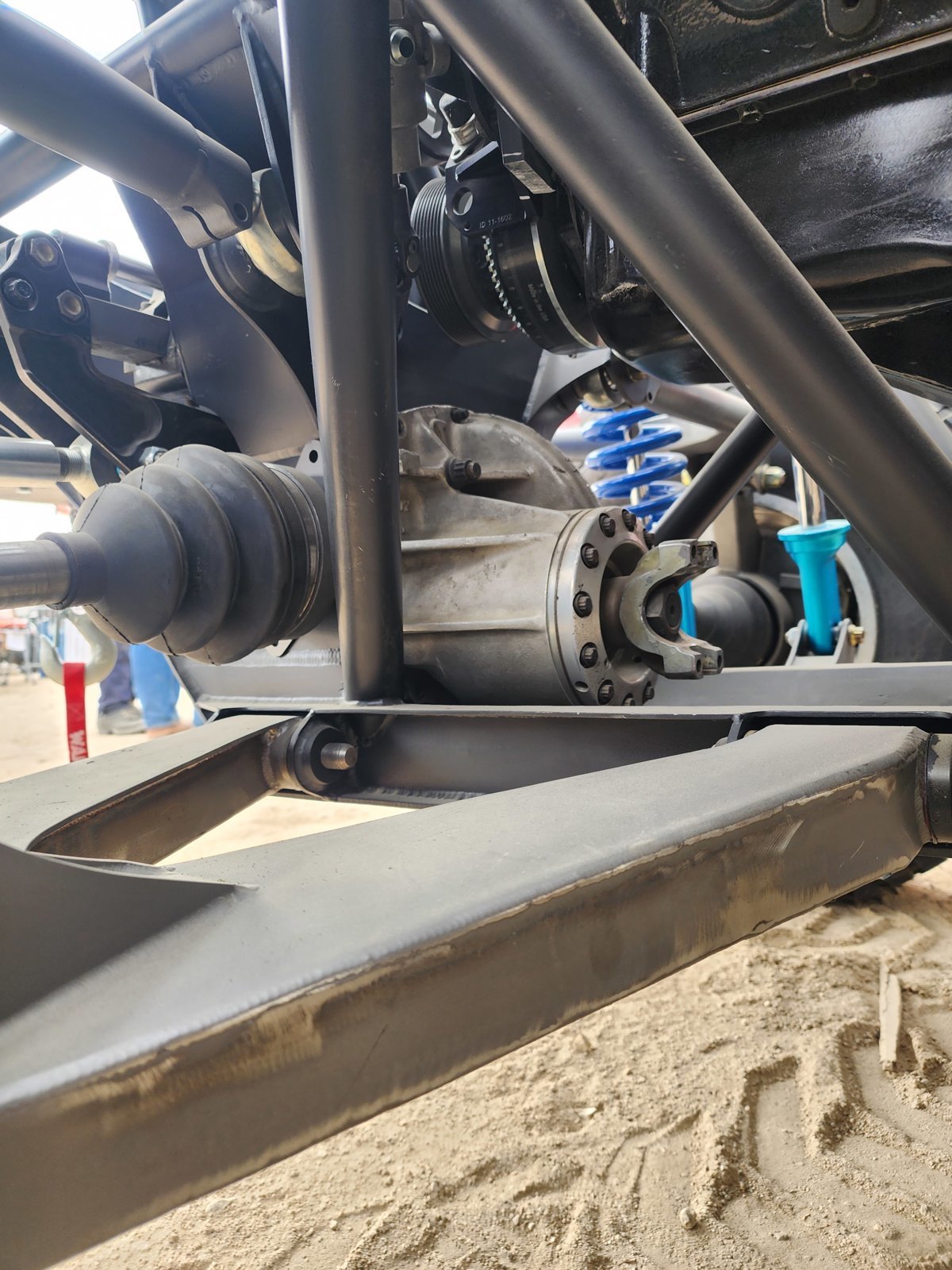

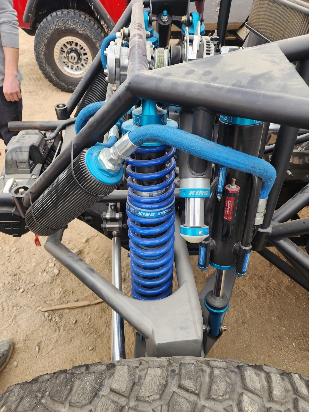

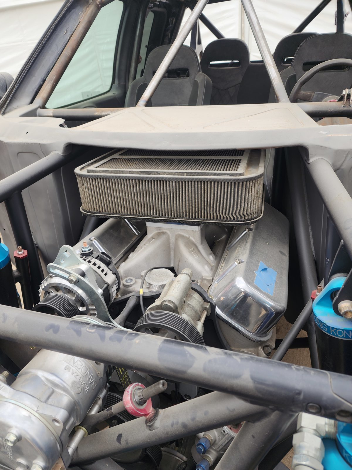

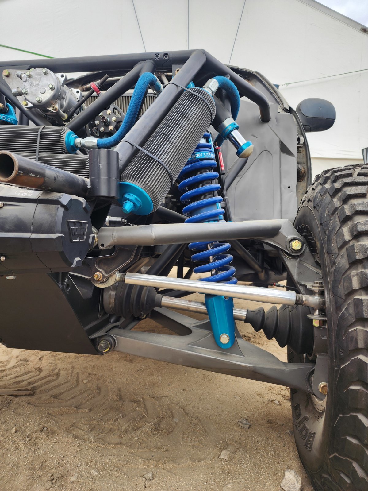

    Got some pics at koh
    20240131_141601.jpg 20240131_141820.jpg 20240131_141549.jpg 20240131_141520.jpg

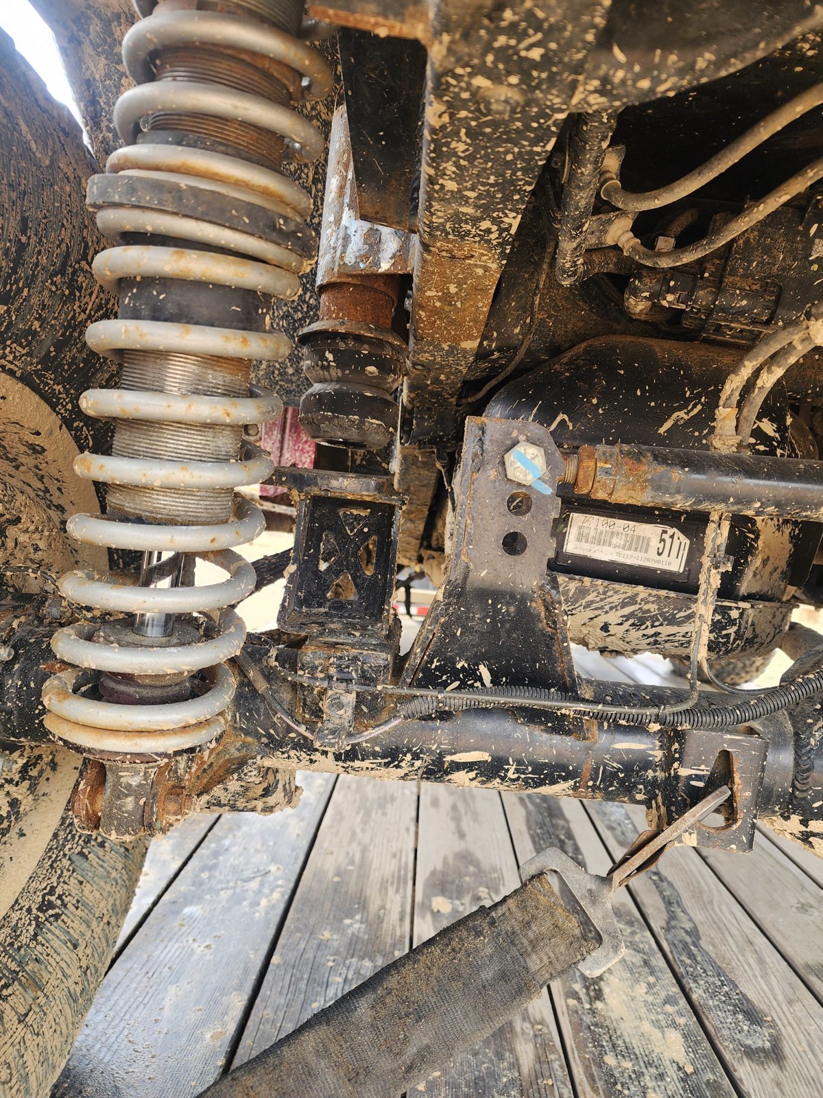

    And here's a random pic I got of dirtlifestyles rear link set up on his tacoma :anonymous:

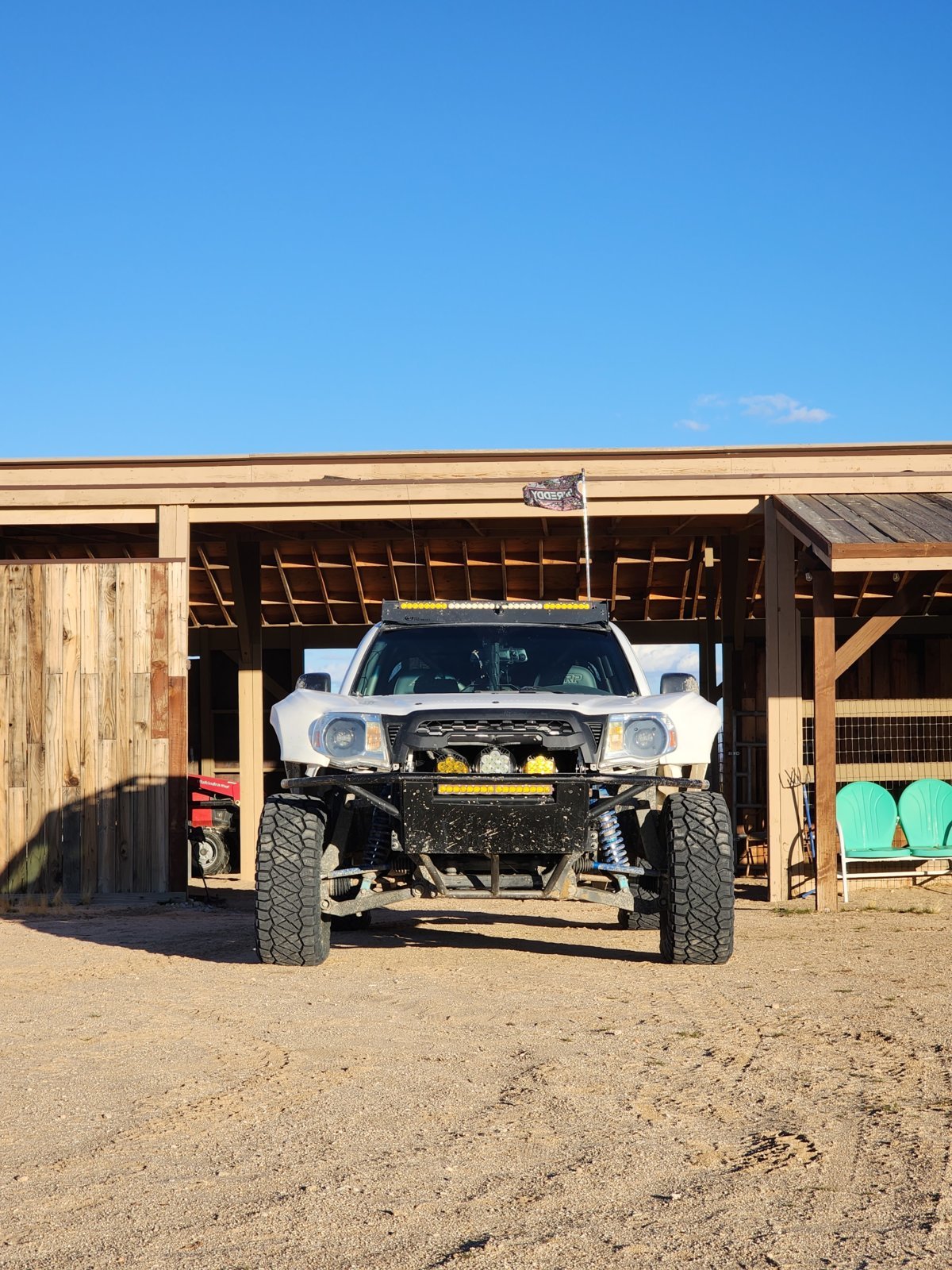

    And here's a pic of @tacotunner06 Tacoma just for fun cuz it was in the same section

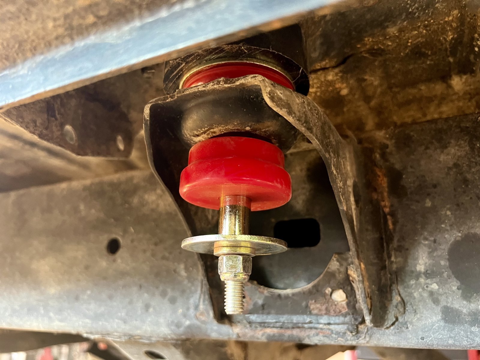

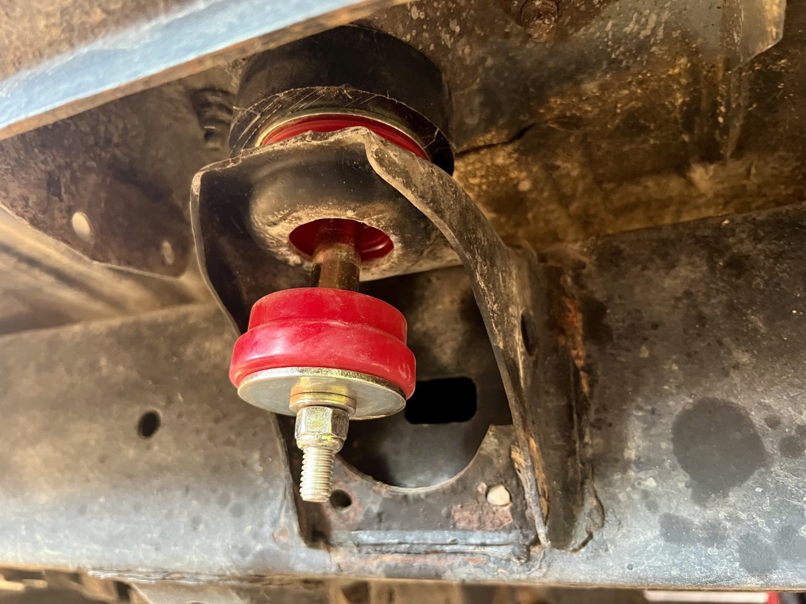

    Can anyone smarter than I explain the lower bushing’s purpose since it can slide up and down? The stock ones were like this, too. I thought they were just blown out lol none of the other mounts are like this, just the center ones.

    I see this on my OEM mounts as well on the 4runner… I assumed they were just blown from 30 years of driving…
    Now I’m curious with the energy suspension kit too

    Are you reusing the old hardware or is that new hardware. Would be weird if it was the same problem twice? Might have to check mine out. Looks like you’re missing a spacer or a sleeve.

    Supposedly it’s crash safety related. The years before that body mount was implemented I don’t believe even had it. It’s not meant to be fully engaged as a body mount just some safety thing if the body was to buckle or some shit.
    People postulated about body flex but that’s way to much gap for that purpose and when all the other body mounts look normal it doesn’t make sense it would be for flex either.

    my middle ones are the same. the front 4 and back 4 all seem tighter

    Interesting. Nice to know it’s not just me. Definitely wouldn’t want to be in the car if that gap ever closed lol

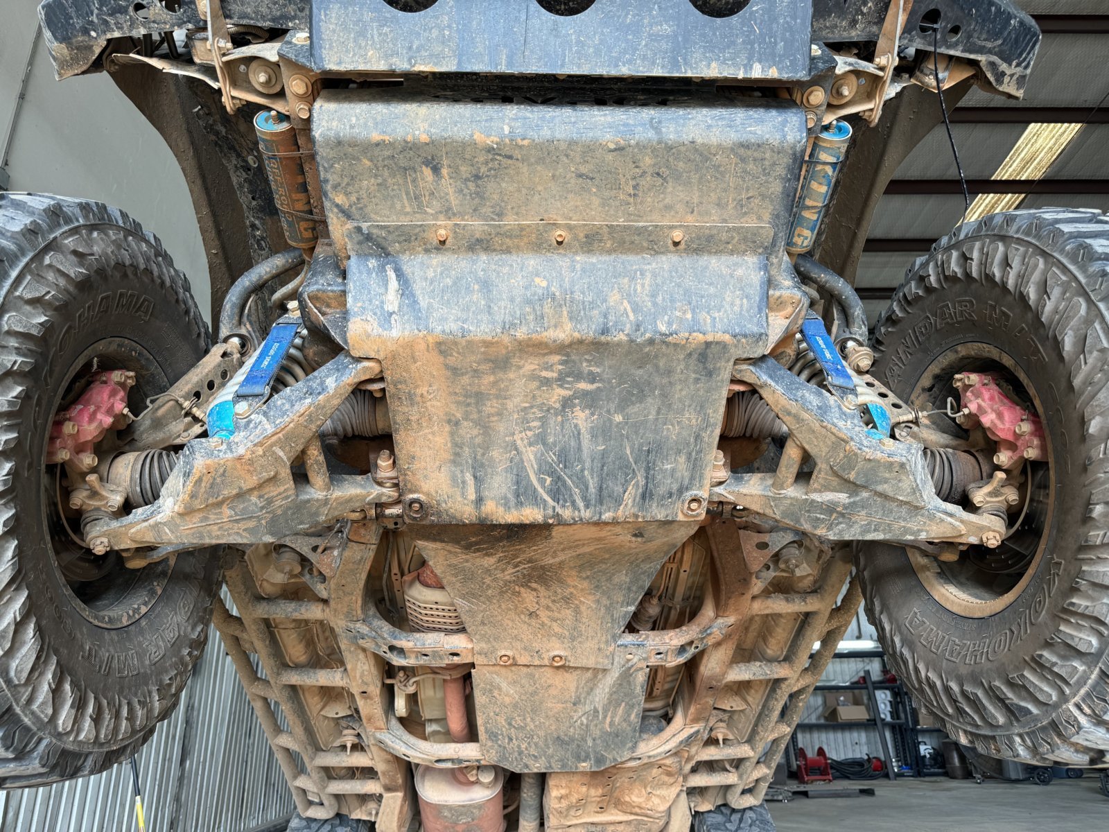

    dude is that a gas tank skid ?? Or what’s left of it ? :eek:
