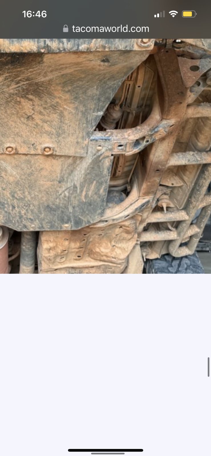

    Truthfully, I would be doing what it took to make that lower bushing snug to the mount. All I can see is benefit to it.

    Yeah I was thinking that, too. I don’t see any downsides in keeping the center of the cab nice and snug.

    I would be curious to see if there were issues opening doors or anything else while articulated.
    I can see some of the ideology behind that being a possible crumple zone. However I can also see it allowing for more flexing of the frame. But for what we do, I only see benefit to snugging it up.

    That’s a good point. Didn’t think about frame flex when fully articulated. Will be something to check when it’s back on its feet.

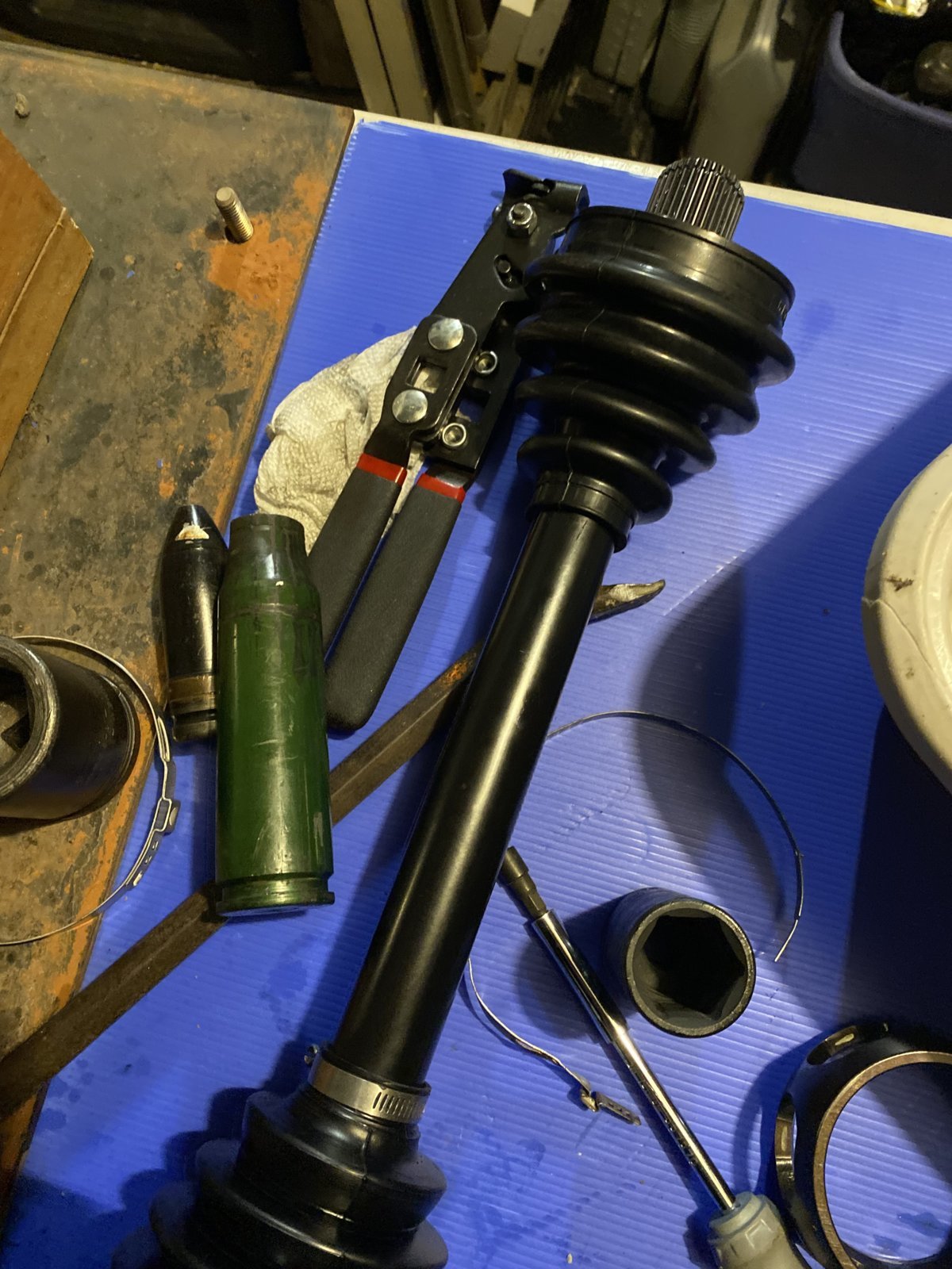

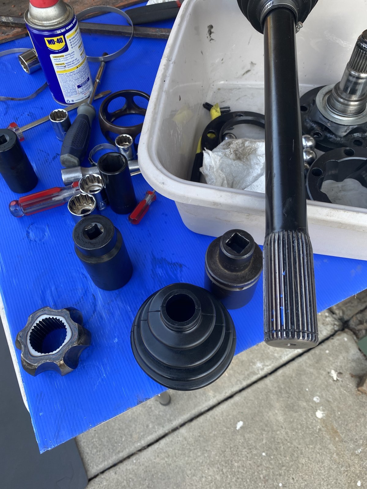

    How are you all sliding replacement boots onto the shaft for your 934s? I’ve tried all manner of sockets but I’m reaching the max elasticity of the rubber. The OD of the axle is double the ID of the replacement boot. Ordered these straight off of JD fab’s website.
    Edit: also OEM outer boots are supposed to be rubber right? These OE boots are plastic? This whole experience is really racking my brain.

    Welp after much trial and error across 4 hours (and not to mention the assistance of a 20mm shell casing), I finally got the bloody inner 934 boot on. Gonna research and possibly buy a boot expanding tool for the next one.

    yeah i think it was on a agm video where they were talking about cv maintenance they mentioned using a cut off end of a funnel to slide the boots on so i tried it and with grease it works pretty well. as far as the factory plastic that was a pita....

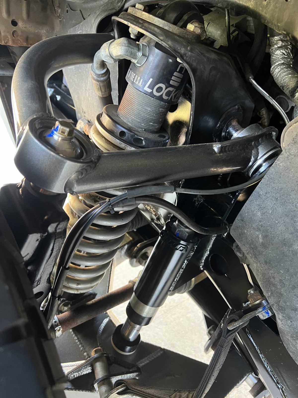

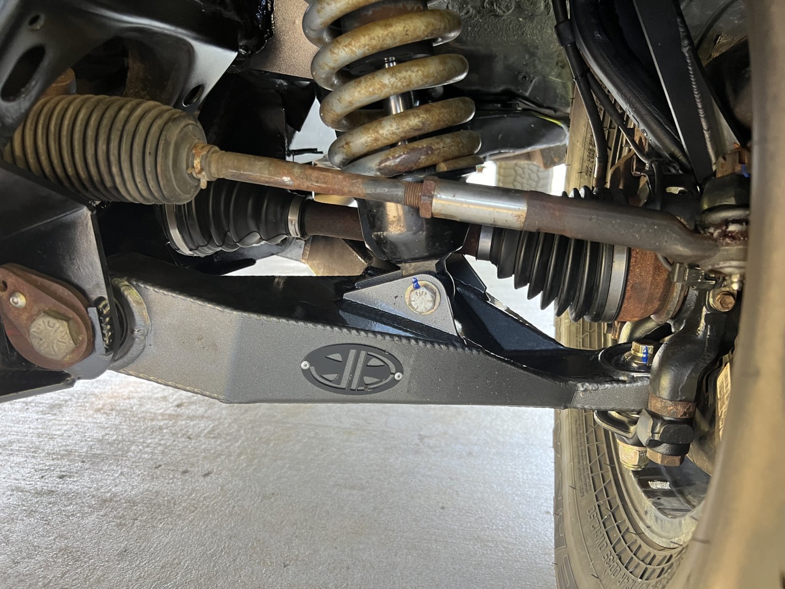

    Awesome work by @906taco welding up new spindle gussets, coil bucket gussets, and installing new uniballs in all the control arms, as well as installing those hydro bumps up front. He also powder coated the arms and they look great. Don’t mind my crusty-ass coilover making everything ugly lol
