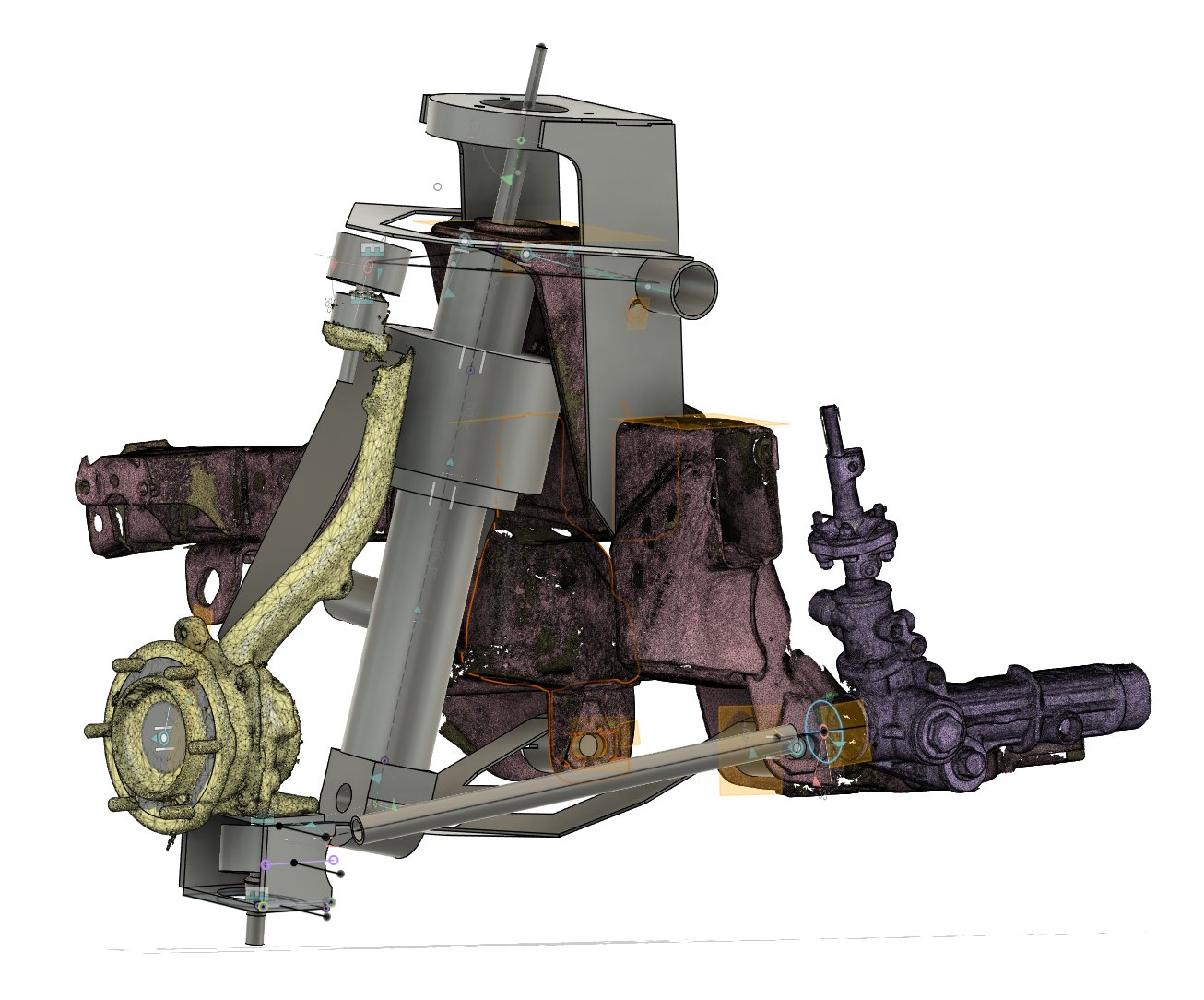

    got a scan of the 1gen spindle this weekend... design continues.
    does anyone know the outer diameter of a 3.75 ID coil?

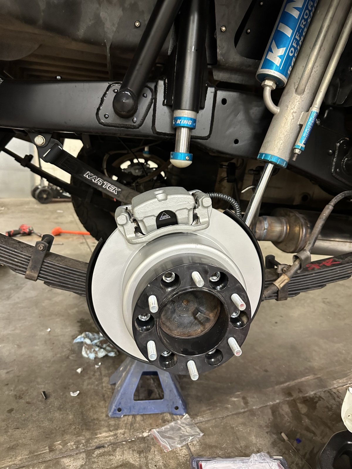

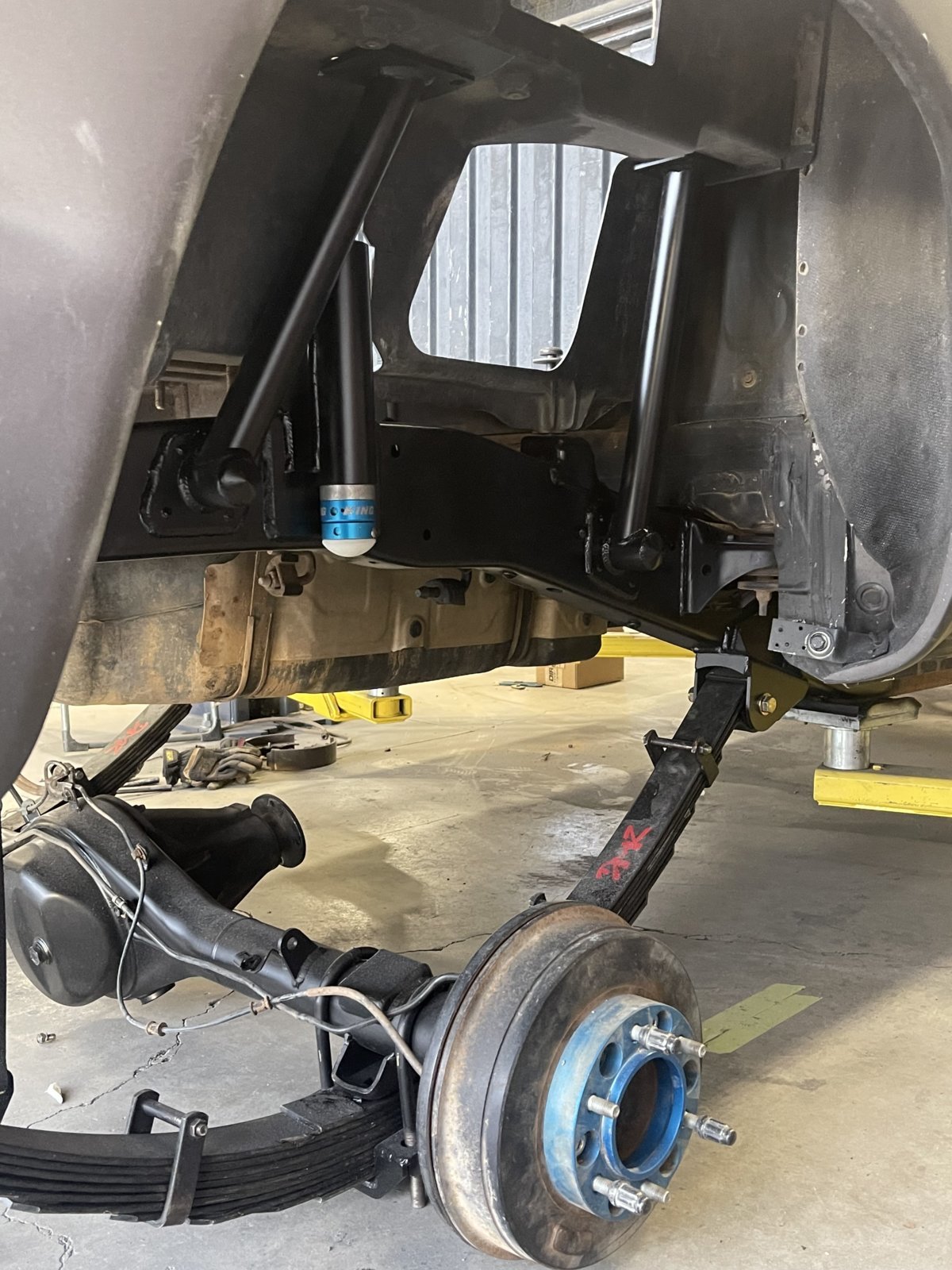

    Can anyone with a dmz kit show me your rear bump stop setup?
    I currently have the total chaos bolt on style with a 2x2 bump and that's probably going to have to go.

    Personally I’d leave it on and see where it lands when you cycle the leaf’s. If it doesn’t work get a new mounting method but 2x2 hydro bumps are fine with SUA

    2"x4" bumps in the rear?
