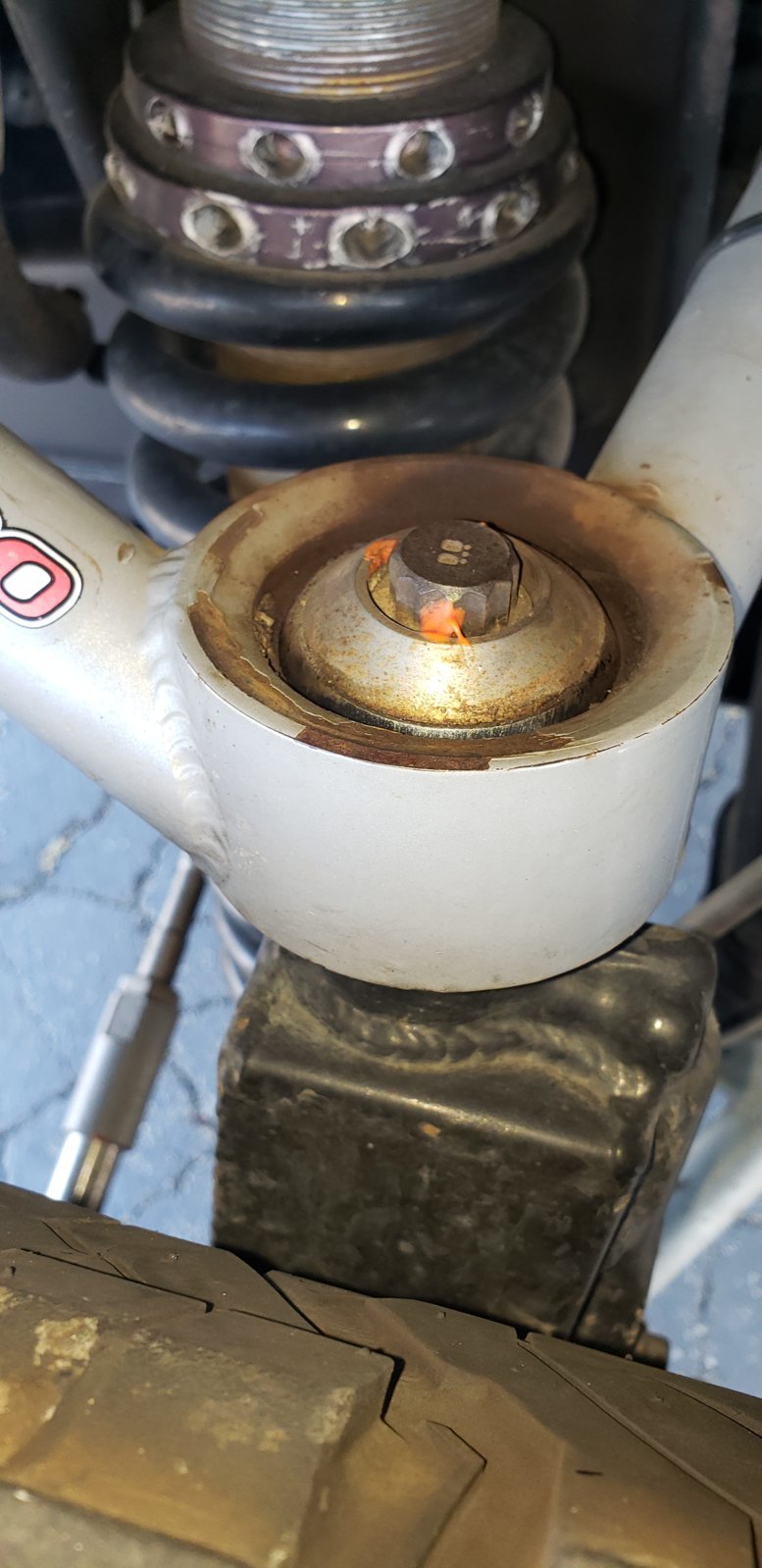

    I guarantee you the bolt was not torqued to 408 when I removed it. Not even close. Maybe 100. Maybe.
    906taco[QUOTED] likes this.

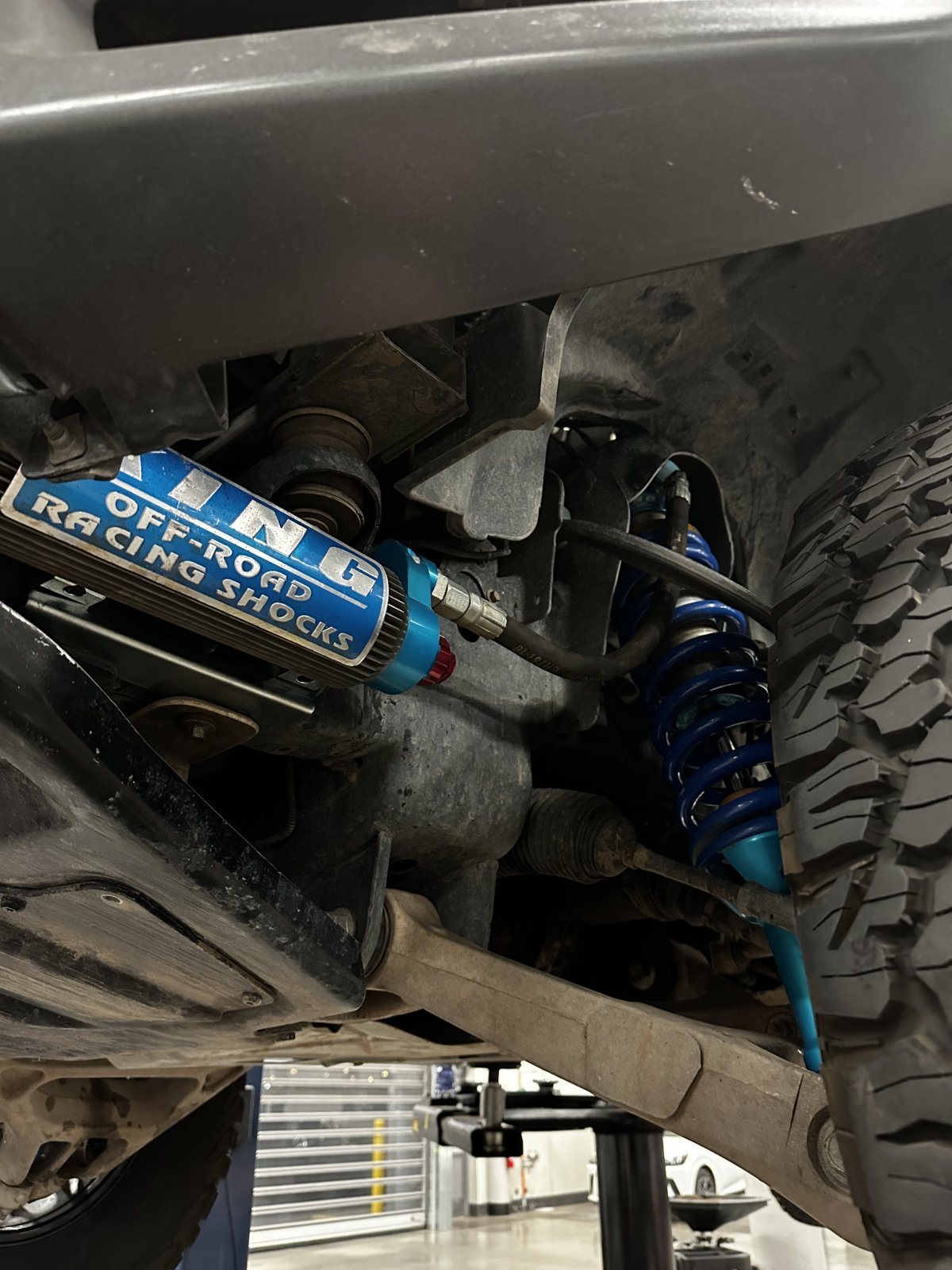

    Modified my UCA High misalignments to give a bit more up clearance. Hopefully no more Inner fender hole punching...
    jamesepoop, not_nick, TWTaco and 7 others like this.

    Idk how you’re doing that to begin with. What front kit are you on?

    Im using 1" uni's though.

    We went to a king bump , it was adjusted correctly during install, remember the stock front does move around alot, so combo of stretching and front fender/inner moving plus I'm running poly bushings. I dont really hit anymore, a few des runs clearanced most of it so added insurance and I can now add a bit more up after adjusting the bumps.

    Yes. If you aren’t caged you need to be conservative at bump. The shock towers flex inward substantially in real life.

    Nope, I have double sheer and a cross bar installed

    I promise you. That cross bar may do something but it isn’t stopping all of the twisting from the leverage on the shock tower and the leverage applied to the bump stop.

    I understand, I am a Mechanical Engineer, It ISNT stopping all of the twist/leverage but its better than stock.

    Marginally at best. Yes. But you’re still talking enough deflection to make an inch or more upward travel a reality.
    When I did my engine cage, I had the engine out and actually measured deflection in the front half of the truck. And it’s a sickening amount.

    Ok, but I have 20K plus offroad miles including high speed in the des since 2012, I haven't bent anything too bad that I have front suspension performance issues nor alignment issues. Other than the more up travel punching holes in the inner, I haven't had any issues with my front LT since install in 2012, maintenance Uni replacement, bushings replaced and or grease on a regular basis.

    I’m simply stating you need to be more conservative with no engine cage. Nothing more.
    If you’re not you will be bottoming shocks, ruining pivots etc.
