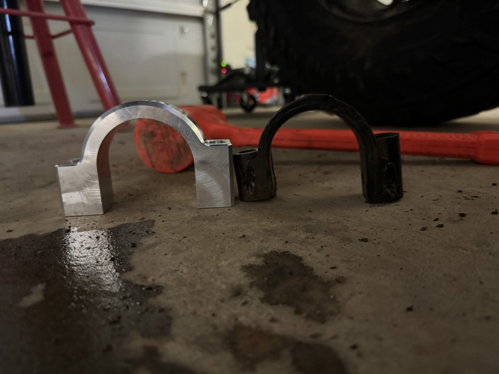

    I resisted buying it for a while because I was doubtful it would even fit since that whole area is so bent up on mine.
    When I got it I was pretty impressed. It is a stout part. Didn’t bolt up easy but i just ran it down with an impact and it probably bent my stuff a lot closer to how it came from factory.
    I still use 2 poly bushings and an oem rubber one for the c clamp because i used to break the poly ones apart in a couple hours.
    I think a little flex in the bushings probably helps save the rack with how I drive compared to if they were delrin.

    Interesting. I figured I’d do poly while everything was out. May weld a ubolt or something similar on the top or side of the stock c clamp while I’m at it. Might try the poly there at first and see if mine splits, too. My weld nuts broke taking it off so I haven’t studied that yet, but hopefully I can just slam a long nut and bolt back instead.

    It’s interesting, the best mod for a Chevy rack replaces all bushings with aluminum with the idea that it’s now part of the steering cross member and doesn’t allow it to deflect. I guess it matters how strong the cross member / mounting points are so that may or may not work with 1st gens.

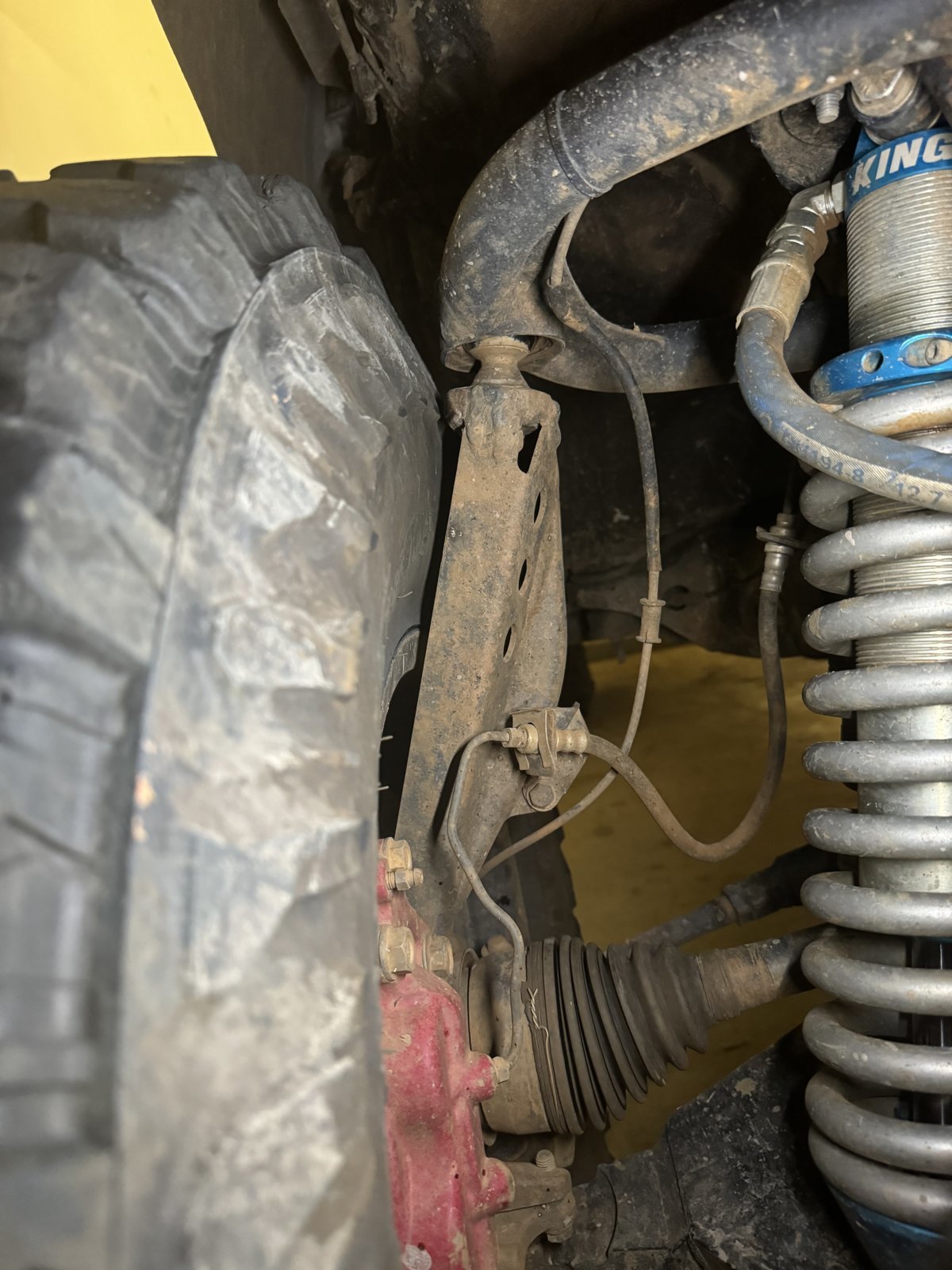

    17” 8.5 wide 0 offset I think they are 4.75 backspace is what I have.
    Clears spindle fine. They are super close to upper uniball and rub the uca slightly when flexed and turned but I can only tell from paint rubbed up.
    basically the same clearance on 35x12.5 pbr and 37x12.5 yoko, I would choose the same wheel specs if I bought again.

    Do have tundra brakes, don’t know if the rotor mounting face is slightly thicker or not
