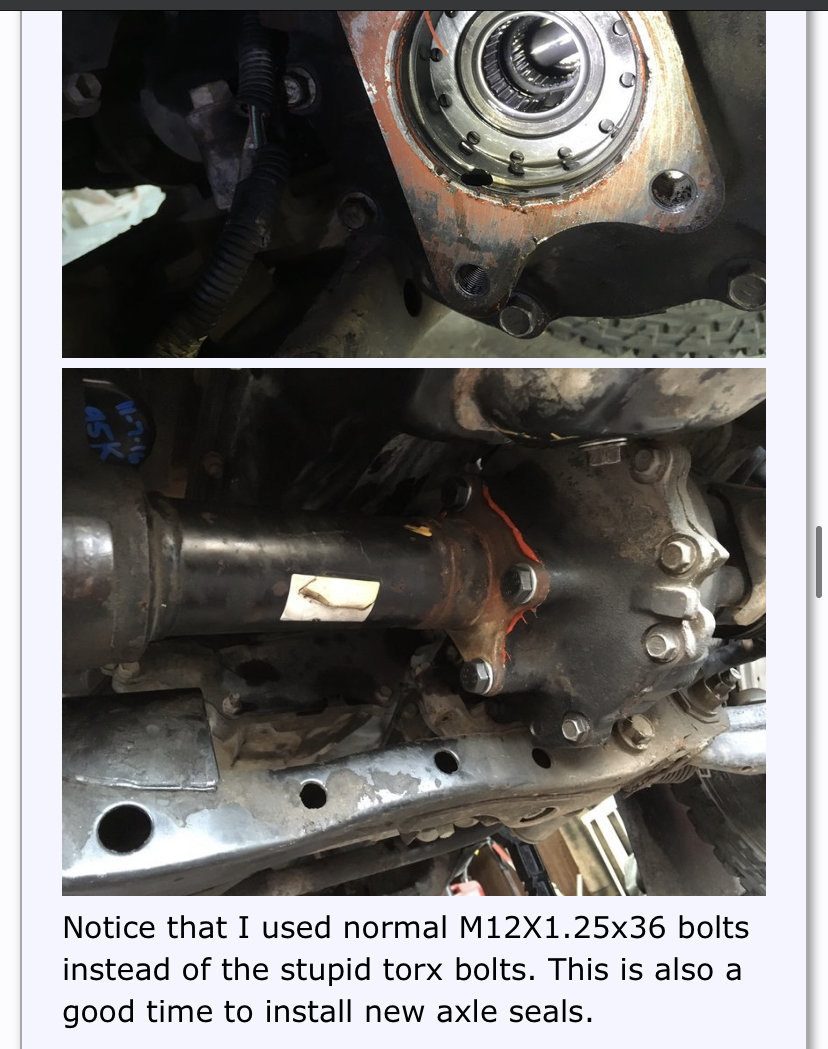

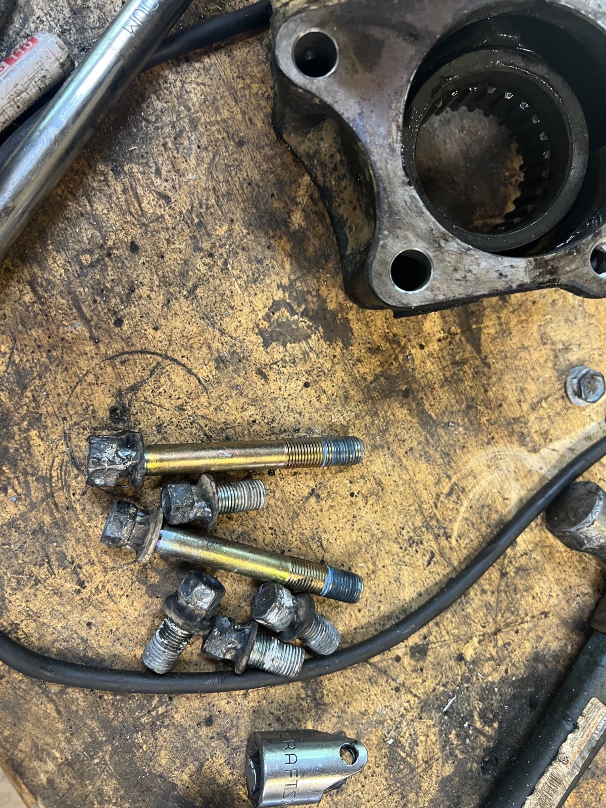

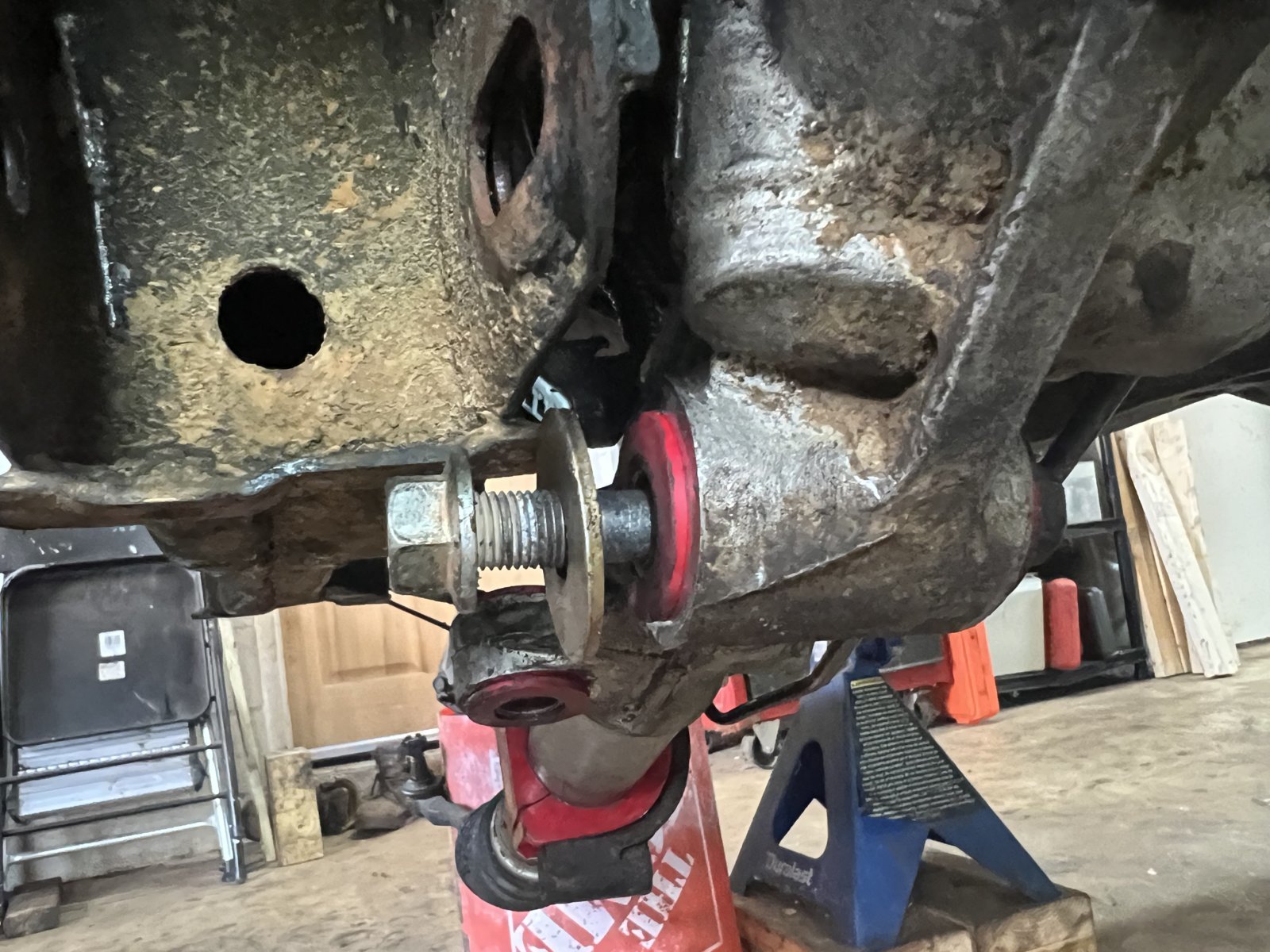

    Might be doing the billet c clamp after all. Whoever replaced the rack didn’t realize the clamp was directional apparently lol
    big steering rack bolt close the lca mount is bent. (Bolt in the pic is just holding the washer on so I don’t lose it but that’s where it goes) Any ideas what to replace with size wise?
    also every one of the add tube bolt heads didn’t play nicely. Has anyone replaced with normal people bolts? :rolleyes:

    belmetric is always a good source for oddball style metric bolts unless you want to just get oem again.

    https://www.tacomaworld.com/threads...or-the-1st-gen-tacoma-3rd-gen-4runner.460180/
    I did this too. Check the hole depth before ordering bolts - I want to say they might be a different length but it’s been a long time since I did that.
    Just call parts counter for the part number for the big bolt and order online - too hard to find a perfectly shanked bolt.

    Nice, thanks man. The rubber diff mount bushings are shot and the rear is toast. Are the poly front mounts worth doing or just OEM rubber?

    No oem replacement unless getting the whole arms.
    Aftermarket has some
    https://m.youtube.com/watch?v=KpkzuDFvSW0

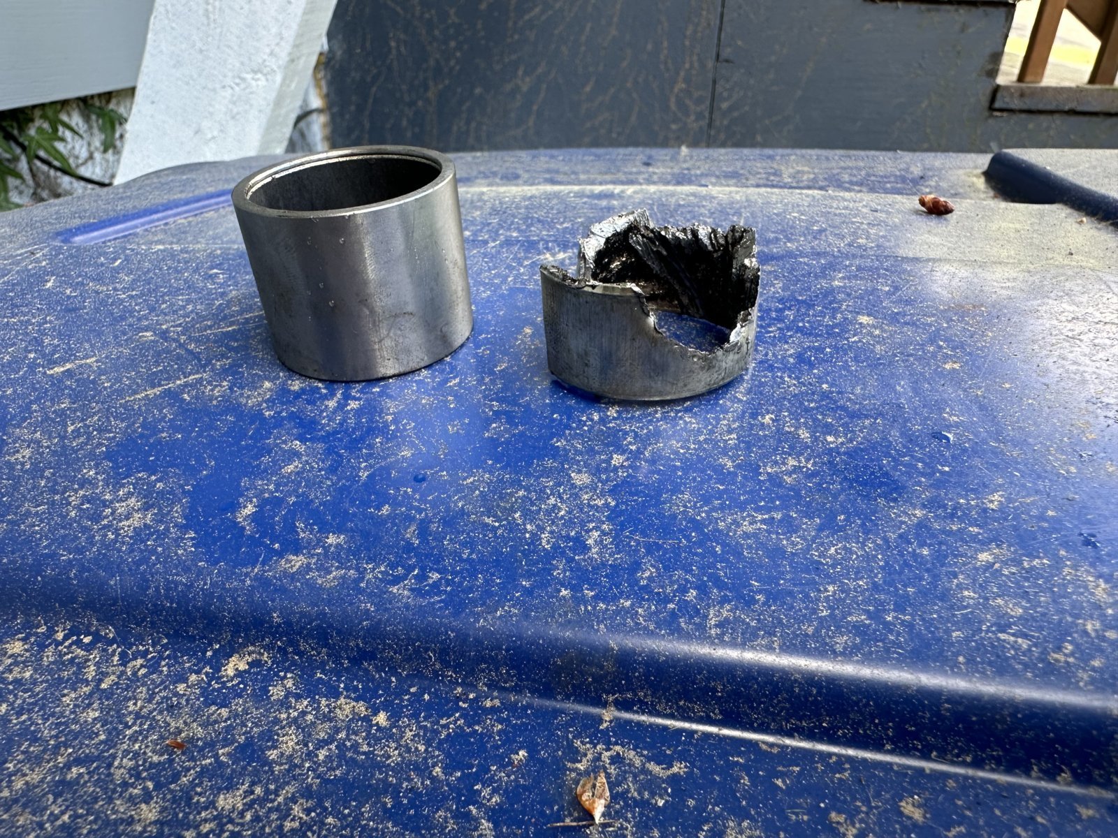

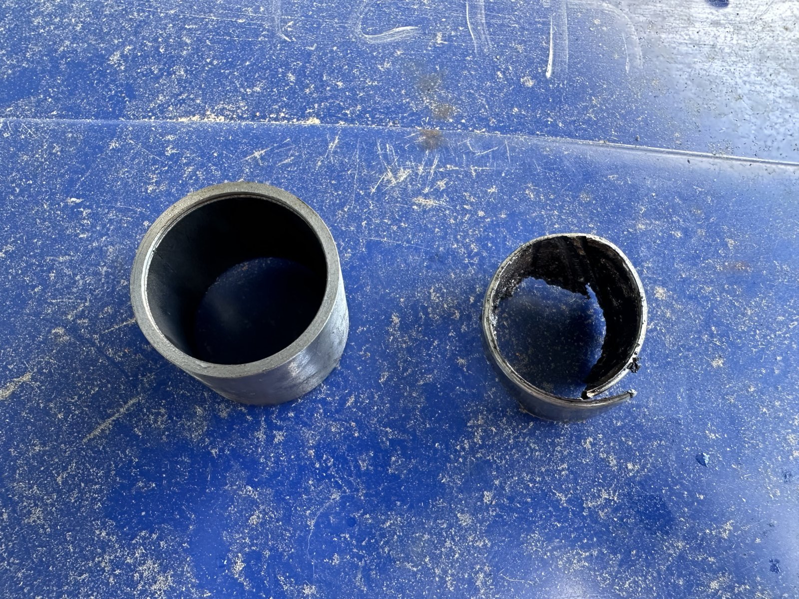

    Ok so I had some symptoms similar to the needle bearing taking a shit. Popped the CV out, lo and behold there’s already a solid bushing in there. But it didn’t quite look like the ECGS bushing. I painstakingly got the fucker out and realize it’s a shorter bushing. From what I know about this truck a guy from ECGS built the front diff. But now I’m like wtf is this some custom setup or what?
    Truck has the solo XLT kit but as far as I’m aware there isn’t anything special for their kit to be fitted in the front diff so I’m kind of at a loss of what’s going on here.
    comparison picks of the ECGS bushing versus this piece of shit I took out the driver side of the front diff.

    Yeah has ARB locker. Upon further inspection it looks like it’s setup to utilize a shorter bushing. The one I removed is stamped with “3520” which seems to match a bushing available from a couple vendors.
    Edit: yeah after inspecting images of the ARB front locker setup I guess arb uses a solid bushing similar to the ecgs. I didn’t realize that was intrinsic to the arb unit. Now I just need a replacement.

    You just answered a 5 year mystery for me. My truck has a front ARB, and when I went to replace the needle bearing, I was surprised not to find it there either.

    Threw me for a loop and until I watched a few vids, looked at some photos, and pulled a parts diagram I was like wtf.

    Yeah. ARB has their own bushing.
