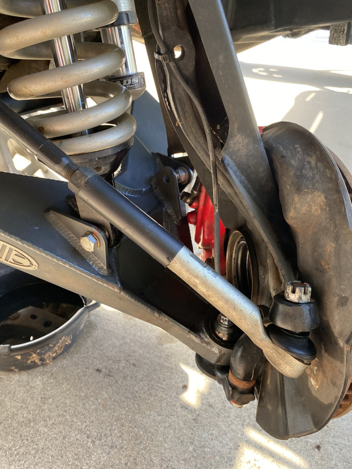

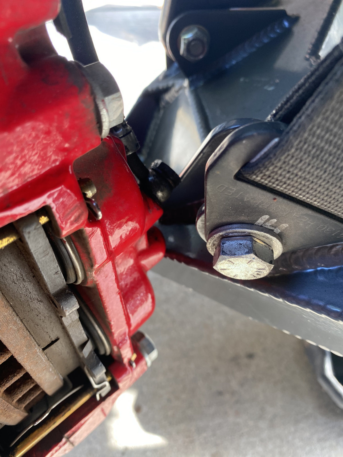

    Holy limit straps stretching batman. Took a tape measure to my limit straps, says they’re a 14” strap, but eye-to-eye I measured 15" dead. I knew they stretched over time, and that I should replace them, but that's a lot of stretch. Definitely explains the slight CV bind, and I also discovered my brake caliper hits my LCA on this strap. Been living life too dangerously.

    1” per 12” of limit strap is what they should stretch loaded so 15” is very normal if loaded.
    If that’s too long, go to a 13” strap.
    SoCaltaco65 and Supra4x4[QUOTED] like this.

    Im gonna jack the lower arm and see what length it’s happy at. 1” shorter probably makes enough difference with motion ratio, but we’ll see.
    Learned a lot wrenching on the truck this time around, now just hoping the new boots hold up.

    Option 2, cut off tab and relocate. Or get an adjustable clevis and eliminate the tab all together.
    Supra4x4[QUOTED] likes this.

    Personally, if relocating the strap.
    I find point of bind then remove at the very least 1.5” of wheel travel. Preferably closer to 2” as this will yield closer to 1” of safety net.
