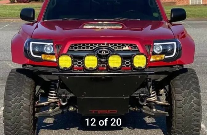

    I'm 99.99% those are the 6", I have them and they look exactly like that

    6" example from the fiberwerx site, same DK kit too

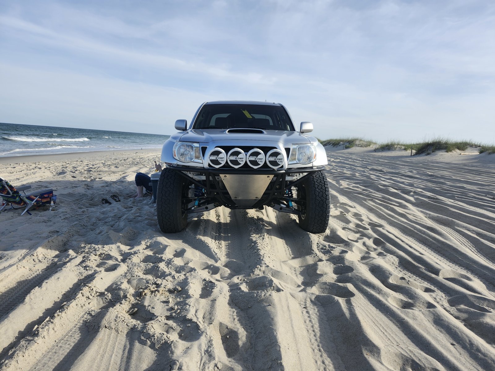

    Why does my truck look so skinny compared to these lol
    4 inch adv fender no wheel spacers

    The dirt king truck has spindles that push out the wheels. The red truck might have lower backspacing than you, but camera angle also has a lot to do with it.

    I knew nicks truck had big spindles, red truck looks like 12.5 tires. I'm only a 35x11.5
