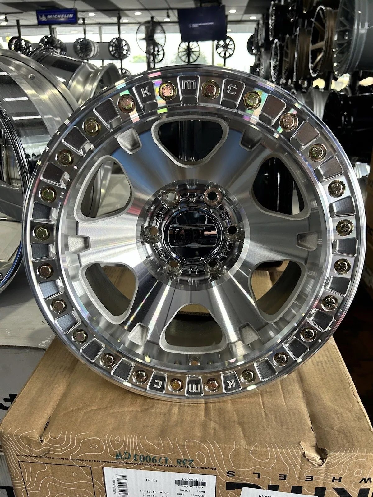

    beadlock shopping...the ones I want are on back order...looong back order.

    My KMC’s were allegedly on a “long back order” as well. That long back order ended up being like 5 weeks in the peak of the plandemic.

    thats just a chevy wheel with a bunch of threaded holes drilled into it

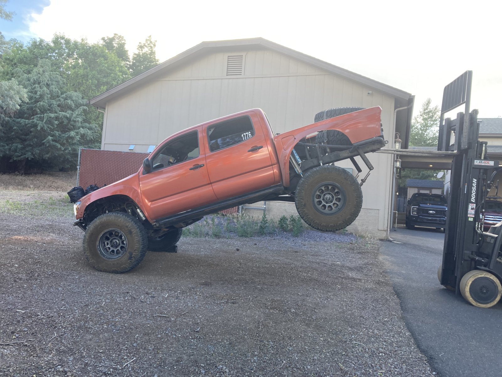

    I previously ran the archive garage SOA shock relocation with a 2.5 on 16x8 -12 (4.03" bs) and needed the 1.25" spacers so I already had them when I switched to a more offset wheel and the 3.0s. I don't strictly know if you could get away with less than 1.25".
    I'm actually 3d printing some spacers for the front to test some different backspacing right now because I'm rubbing on my shock bypass tubes. Can't drive on'em, obviously, but great for test fitting clearance.

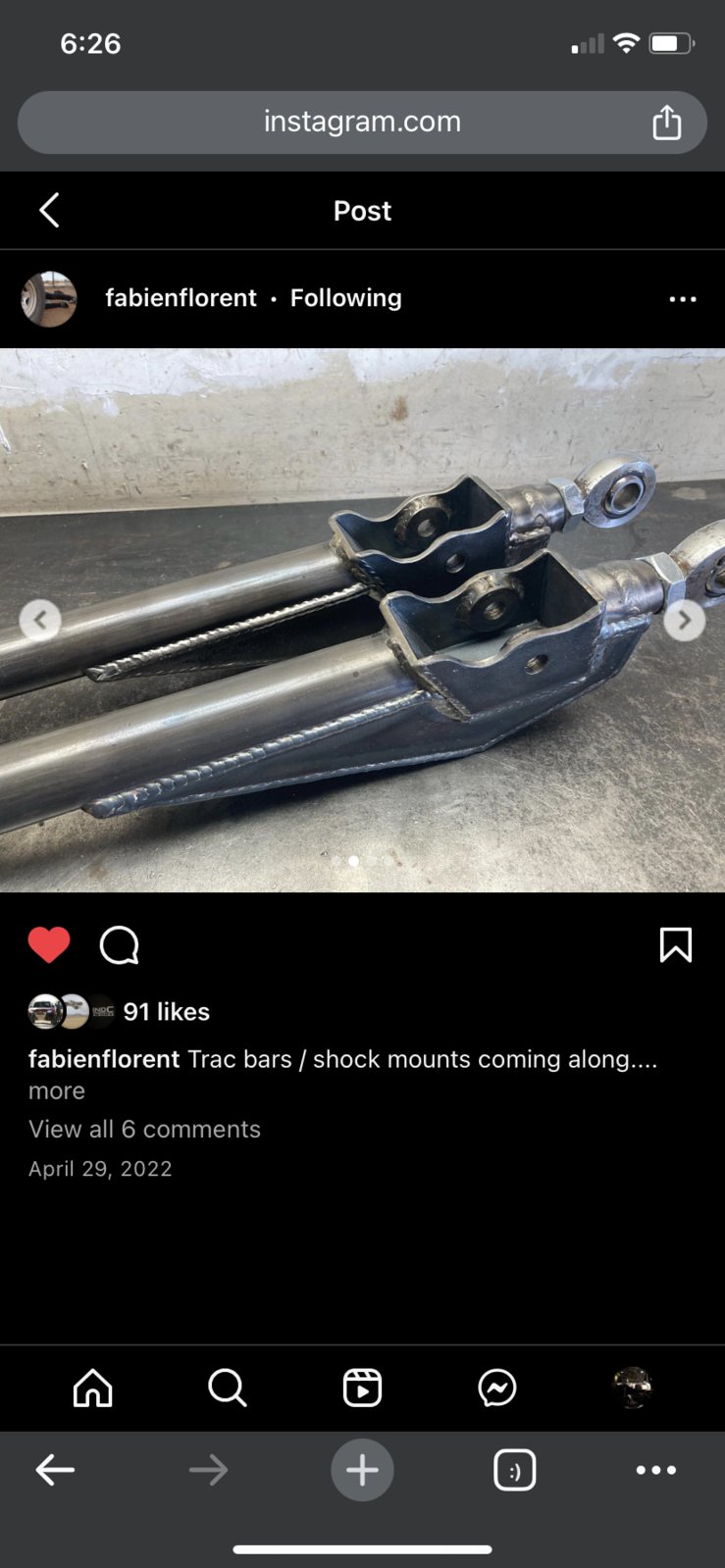

    Taken from happy smiley’s IG

    Something like this would probably work insanely well. Especially to keep using the shocks I have. Could get a pretty big gain in the motion ratio department which would help tremendously with my bump zone issues.
    The way the JD shock position is, motion ratio changes immensely through the range of motion. I wish I had measured angles at bump/droop.

    So many questions…that set up has multiple potential pitfalls
    1. The more vertical the shock is the closer you are to a 1:1 ratio so ie: you would need a 20” shock
    2. track bars and leaf springs don’t play well in the same sandbox, the track bar better have a shackle at the front and the length / shackle combo better allow the trac bar to move in the same parabolic radius as the leaf springs or you’ll send u-joints and leafs over the rainbow bridge
    edit - it’s not just the parabolic radius but also the axle roll through that radius
    3. Why …just why with all of that work wouldn’t you just go to links ?

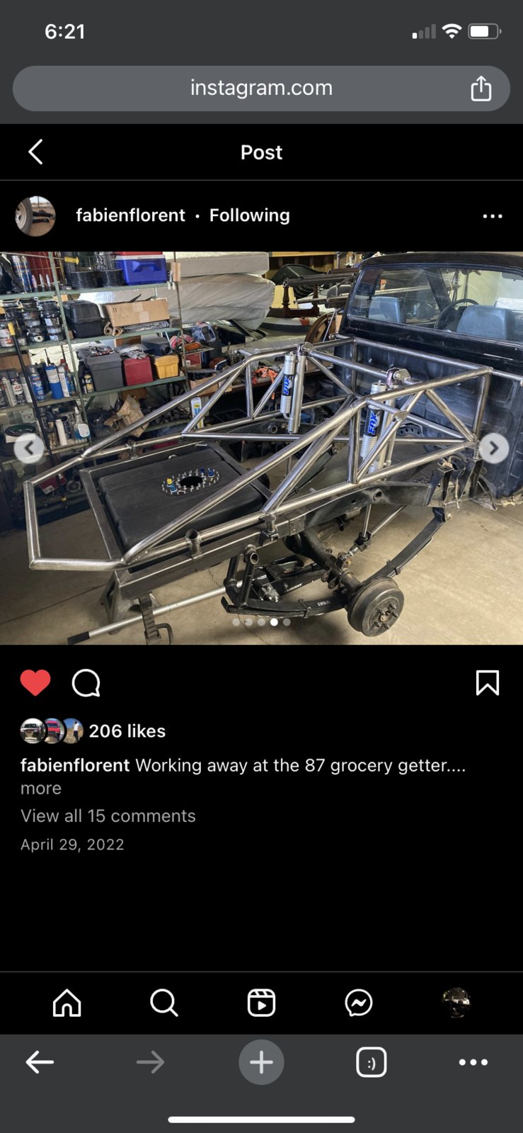

    I had asked him about it, and to answer number three - this is his spare parts / grocery getter. He’s got another linked yota.

    every single after market leaf spring shock tower does the same thing but the benefits outweigh what you are describing

    FFS he basically built short course links but left the leaf springs on …me no comprehend :anonymous:
