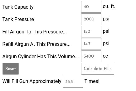

    BEAR_KNIFE_FIGHT
    BEAR_KNIFE_FIGHT bearly famous
    May 21, 2016
    #187524
    2,616
    Alex
    Minnesota
    2016 TRD OR 4X4 DCSB Slowsand, 2017 WRX WRB
    PV=nRT baby
    Yeah, lets pretend the temperature remains the same for everything. You'll also need to know the volumes of the tanks.

  13. Jun 29, 2024 at 7:17 AM
    BEAR_KNIFE_FIGHT
    May 21, 2016
    #187524
    2,616
    Alex
    Minnesota
    quick mafs for a 40 cu ft tank and a 2.5x12 cylinder volume. may be right, may be wrong.
    Torspd and IvanhoeTaco[QUOTED] like this.
