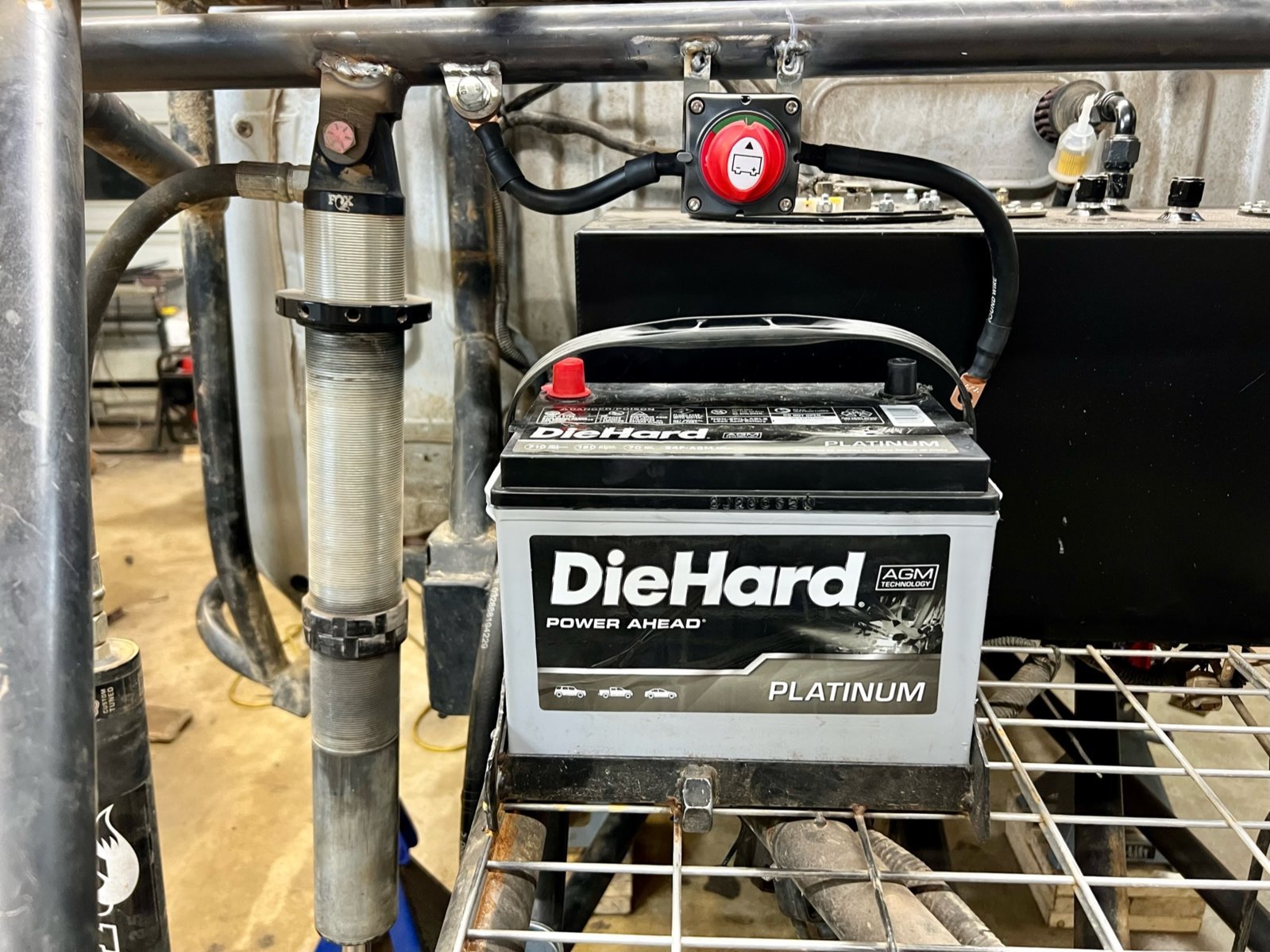

    I have 12-15’ of 2/0 welding lead with a 400a fuse off the battery.
    No issues yet including winch pulls. Speaker amps are wired separately.
    I’m sure you can get away with smaller wire. I would just avoid cca wire in favor of solid copper.

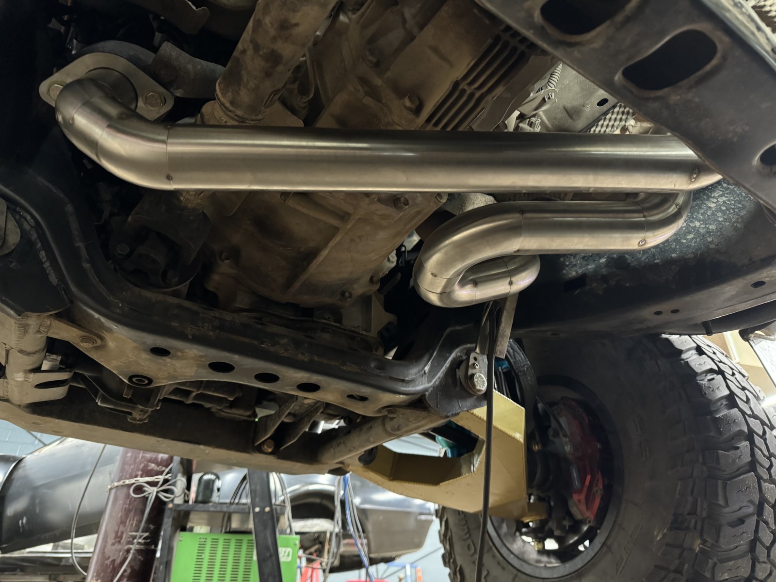

    damn, I guess I missed an opportunity! I didn't bother with trying to make equal length when i did my exhaust tuck 3 years ago!

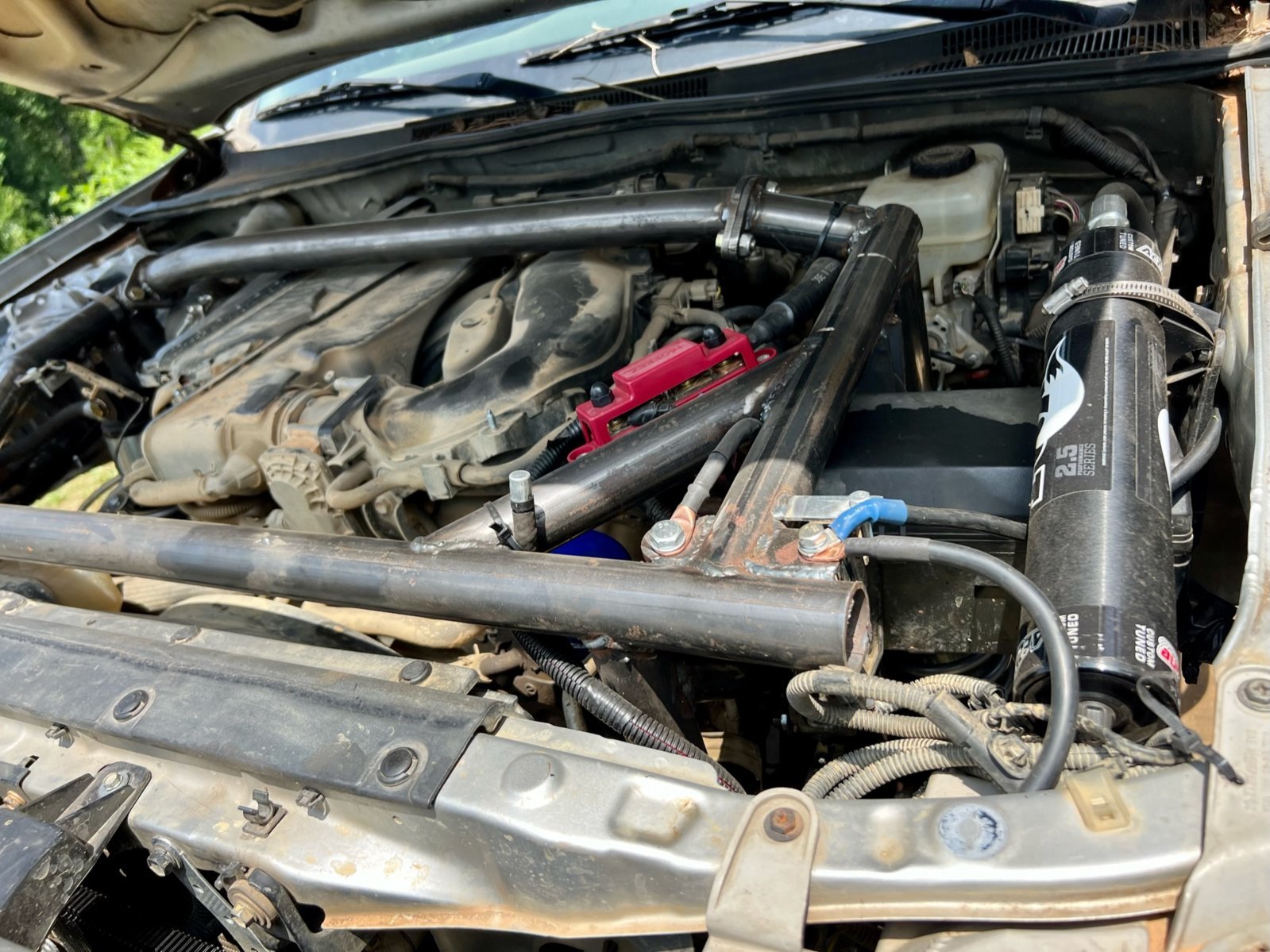

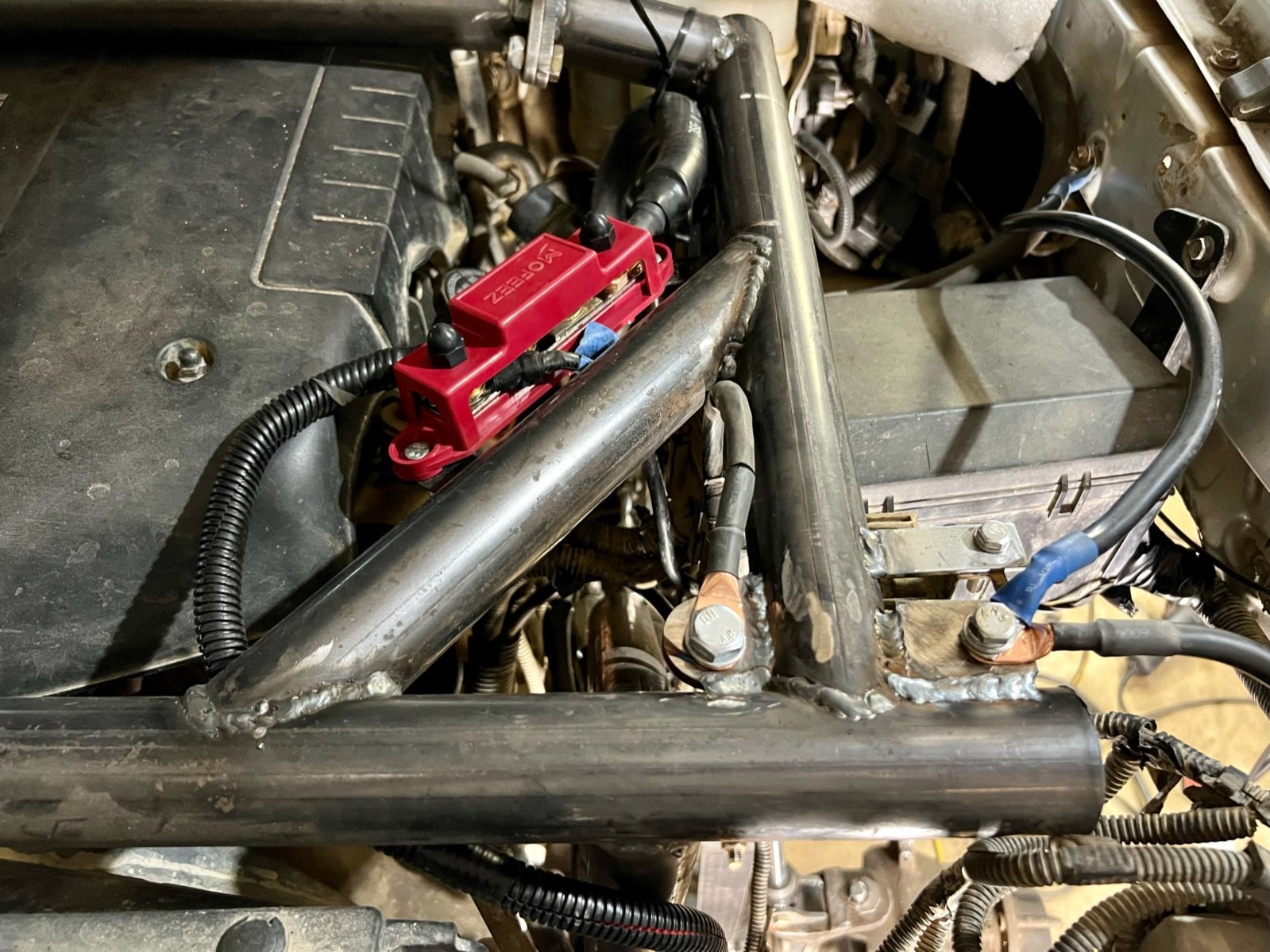

    https://www.tacomaworld.com/threads/daymans-karate-class-but-you-wont-learn-nothin-4-link-lt-and-previous-iterations.755134/

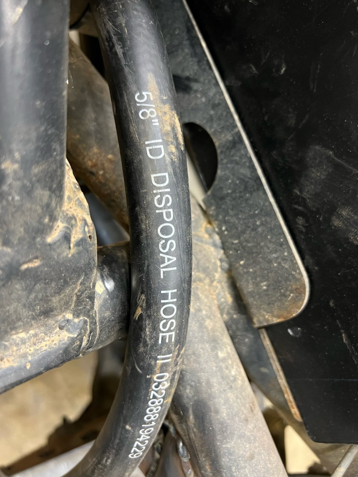

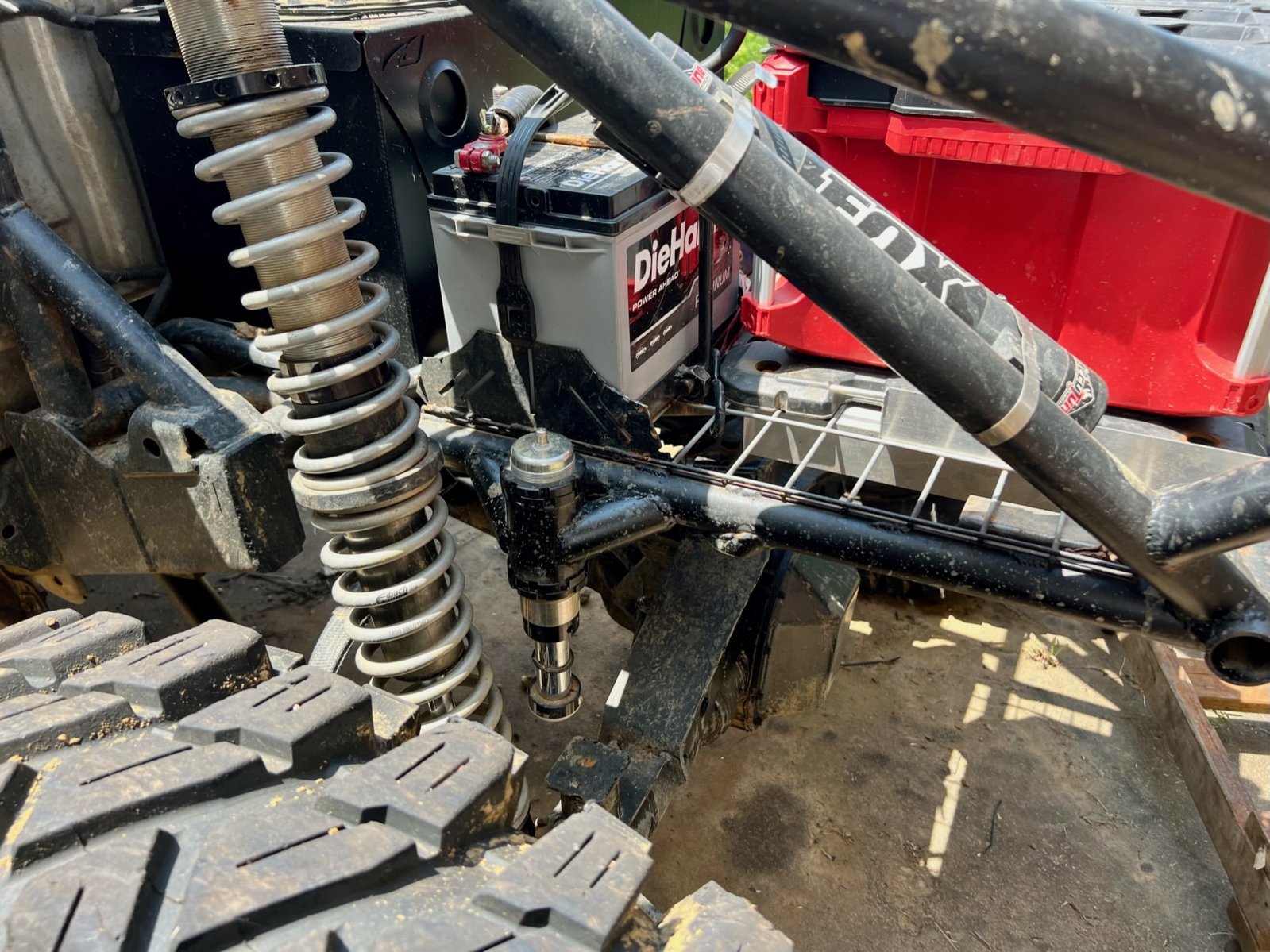

    This is how I had mine. 1/0 wrapped in 5/8” rubber hose for extra protection. Ran everything off of the terminals and grounded to frame/tube.

    With wiring, I advise looking at OFC wire that is rated for exposure to oil and fuel vapor. Welding cable does not fit this bill in most cases. Your main ground to chassis should match OR even exceed the size of your main supply.
    Calculate run length and max amperage and go up a size if it’s close. Keep fuses close to the battery.
    Highly highly recommend dual shielded battery cable from battery cable USA. Been using their wire for years and it’s absolutely phenomenal quality.
    Do NOT cheap out with electrical.
