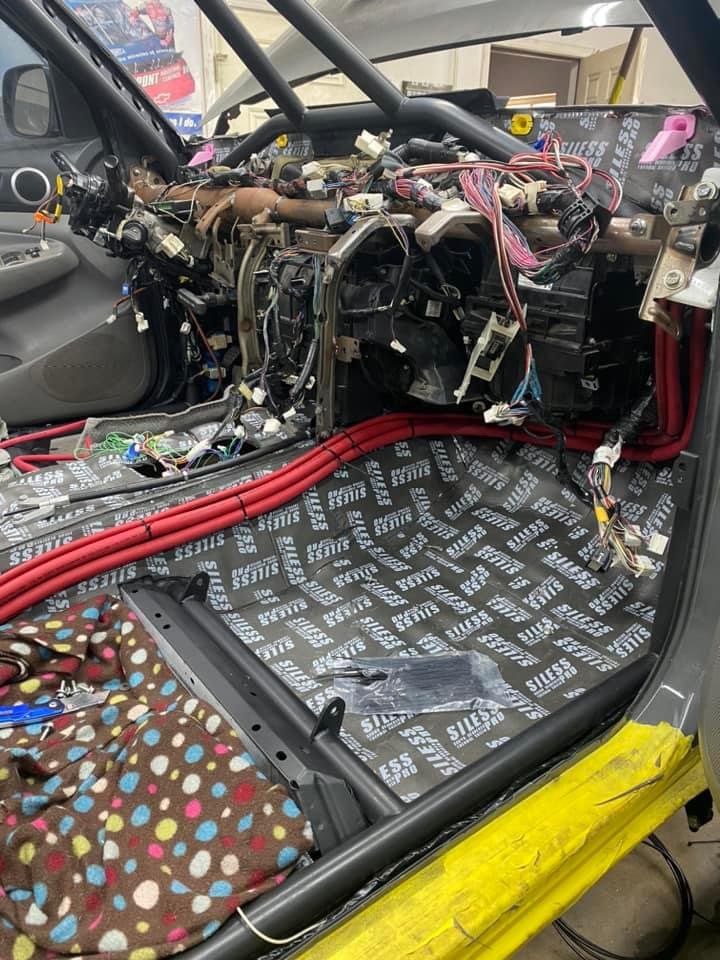

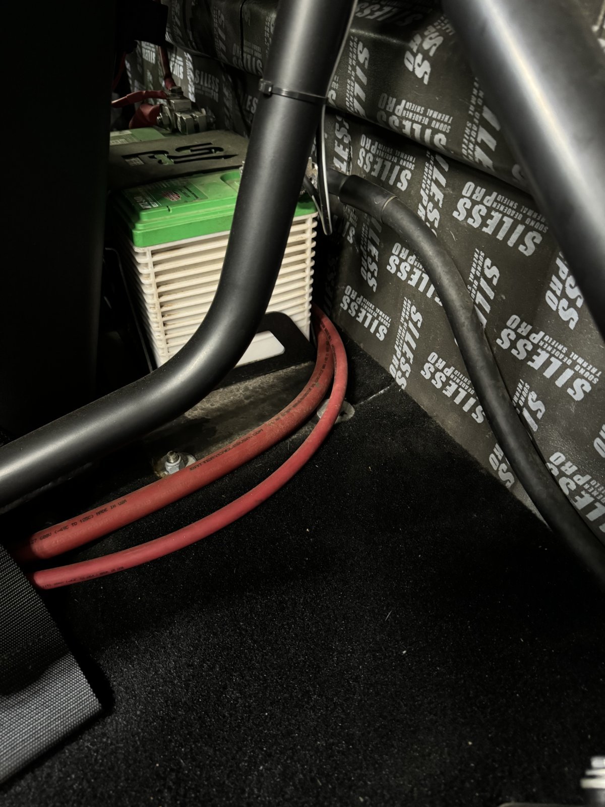

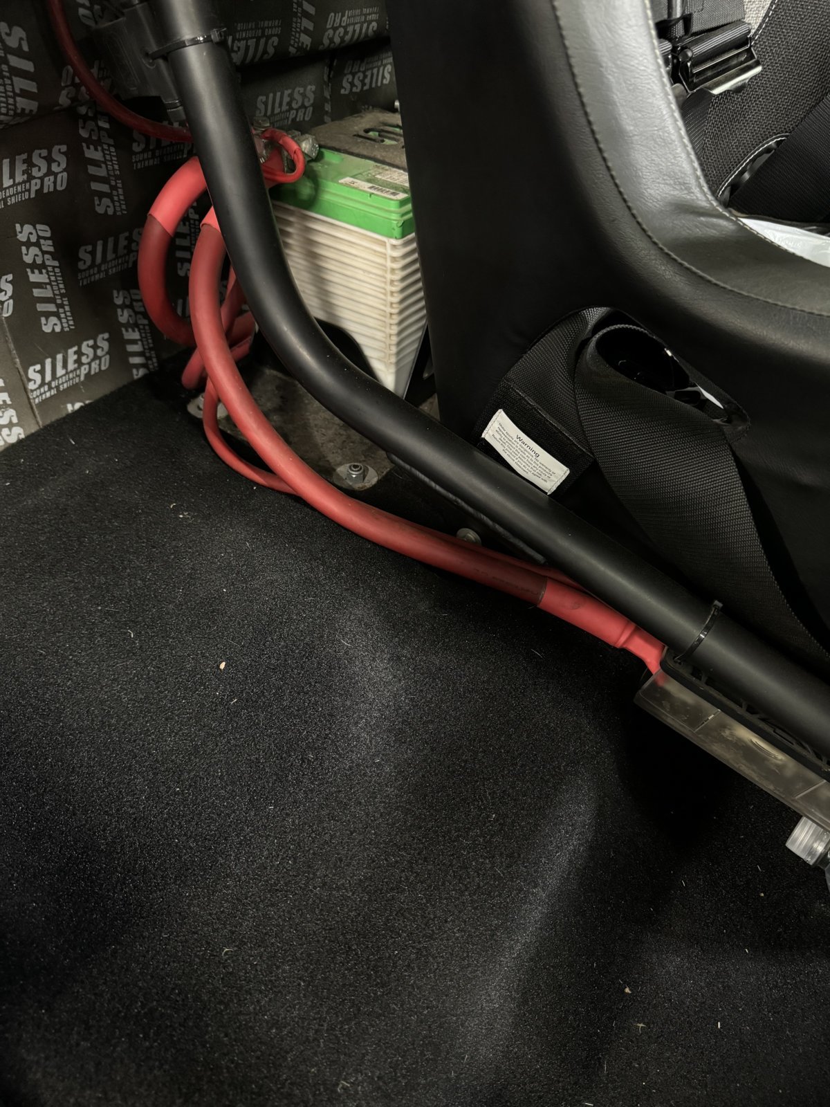

    Here is how I did all of mine. 4/0 battery to alt (270 amp)
    4/0 from battery to winch (winches pull over 400 at full pull)
    2 from battery to starter
    4 from battery to engine bay fuse panel.
    It is 100% of the time better to overkill electrical than to underkill it. It’s not cheap to do proper. You will have about 800$+ invested in wire. But you will NEVER have issues.
    Also. Crimp every cable end with a hydraulic crimper. It is far superior to solder.
