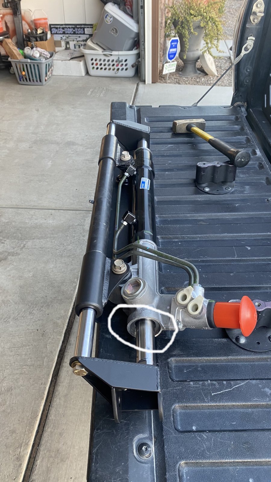

    Wait so how does this work? From the pictures and description on jd fab, it sounds like it uses a modified stock rack. Is that right?

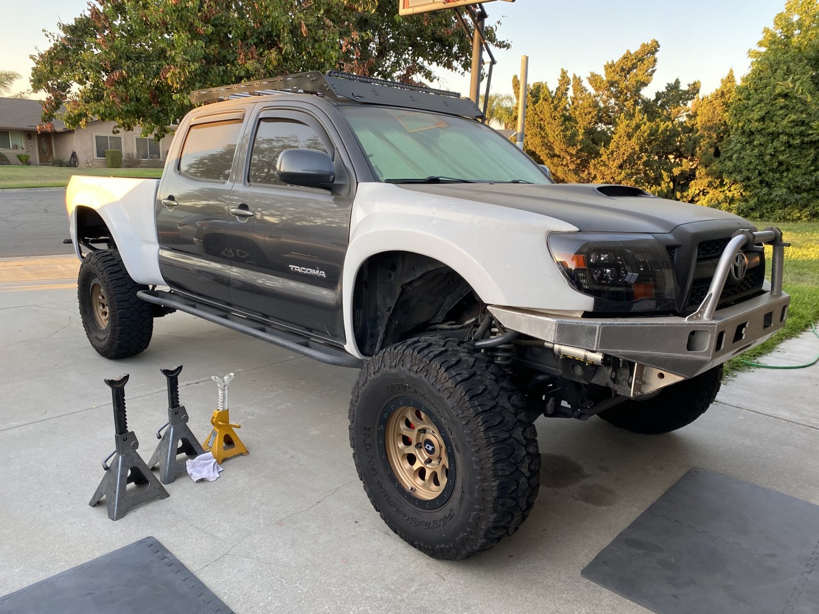

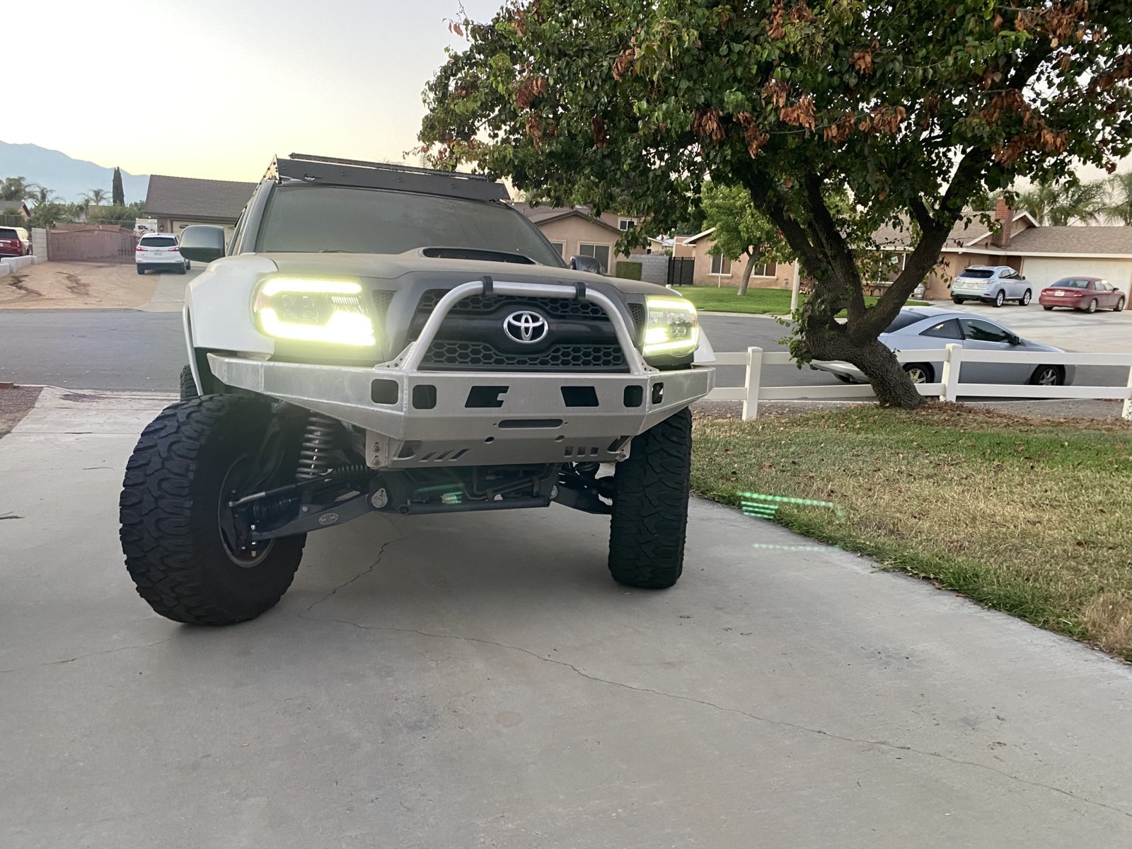

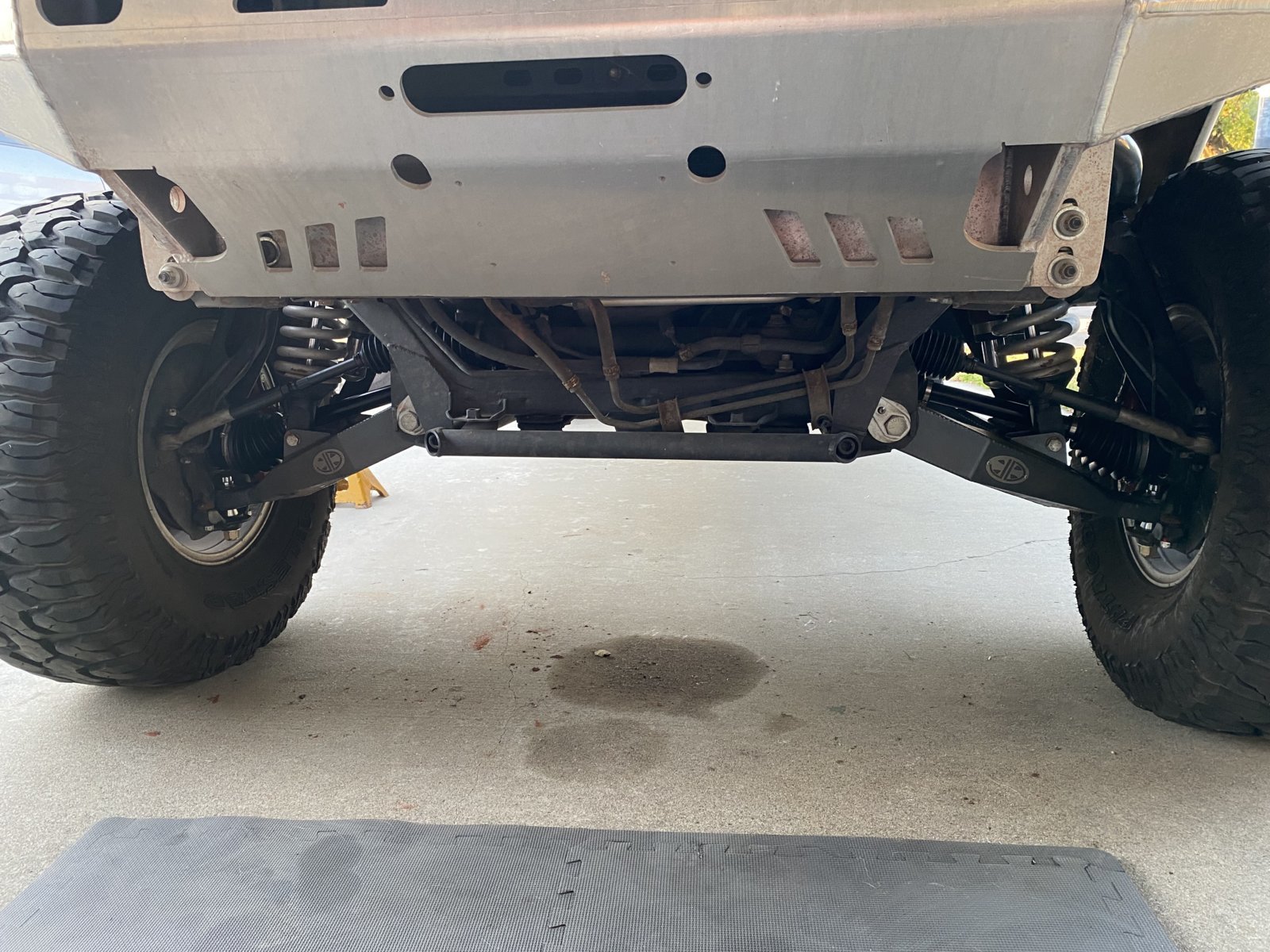

    Finally finished the front rebuild on the truck. Got it rolling for one day, but having fuel system issues now. Filler neck burst and dumped fuel everywhere, thinking a vent line is clogged.

    Correct. I guess I'm not sure what you're asking?
    JD fab's slide rack is for a modified Tacoma rack

    There is a slight modification done on the stock rack on the left end. You cut about 1/4 to 1/2 inch off the body of the rack right around where the rack comes out. Then install a seal.. easy part of the job really. I circled where I cut off a piece of the rack body. Then a seal slides in there.

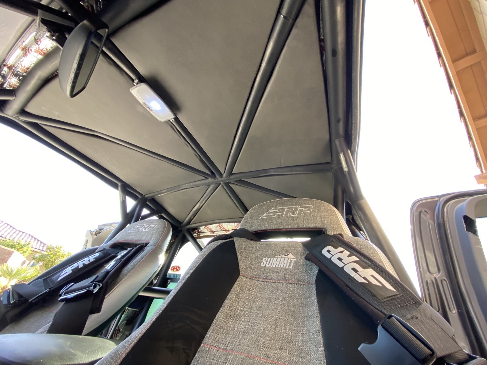

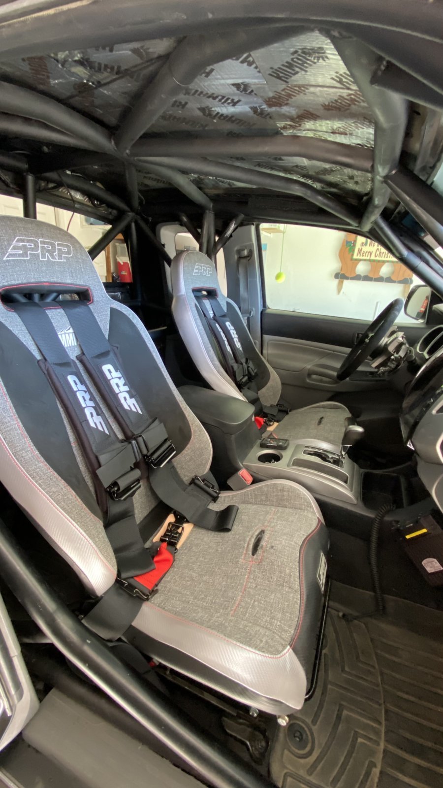

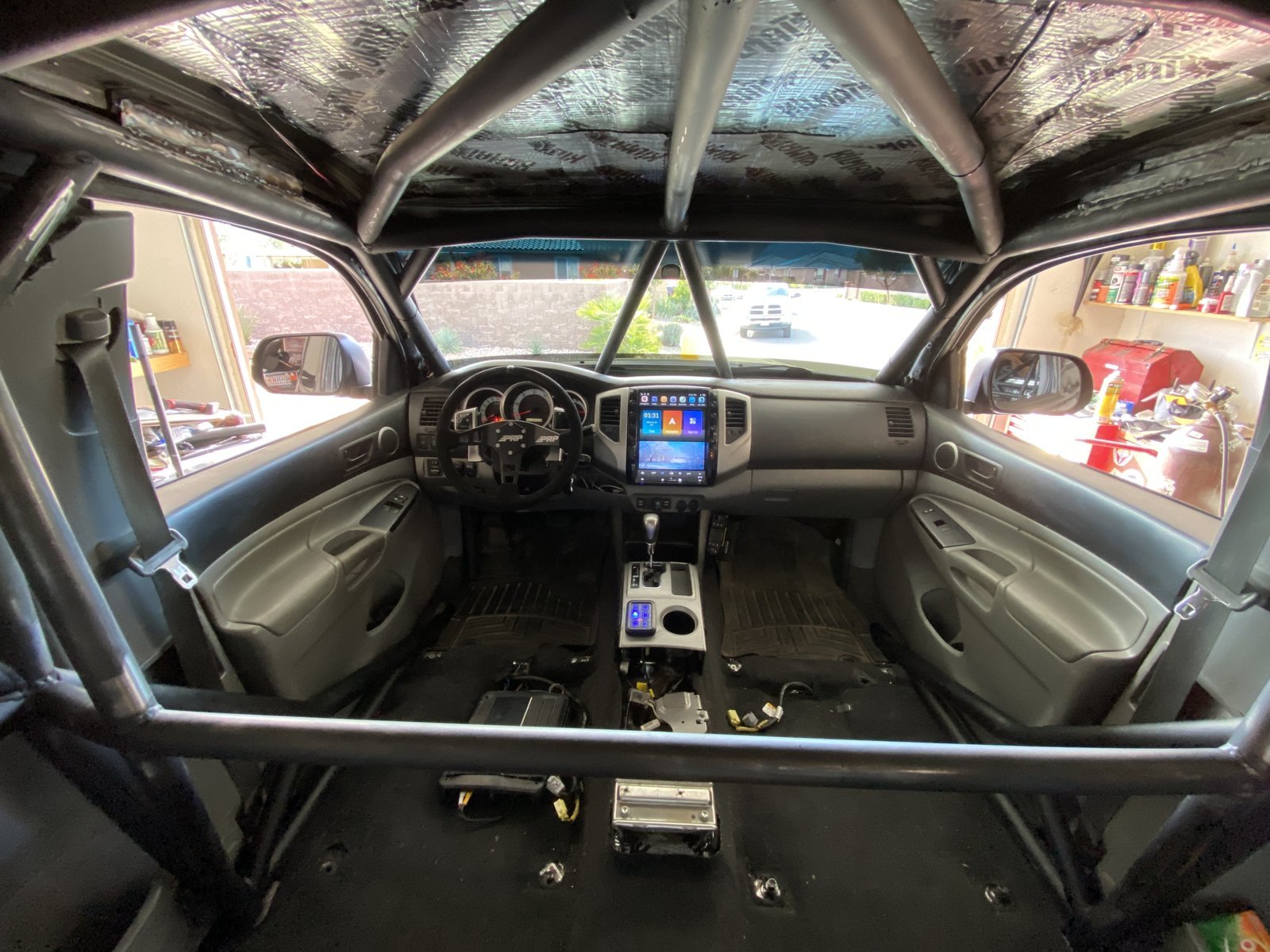

    Get the TEDesign cage and you can keep most of your interior. My interior looks great IMO.
    And for a couple 100 bucks I made my own headliner out of foam and fabric
