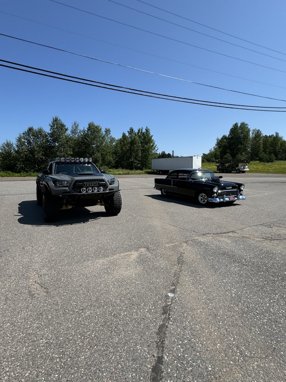

    The thing on the right took home best in show and the thing on the left took best import over the weekend. It’s the little things. Shows bore the hell out of me but generate business.
